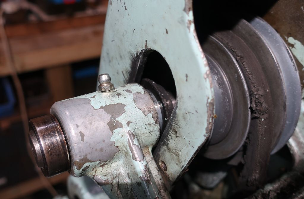

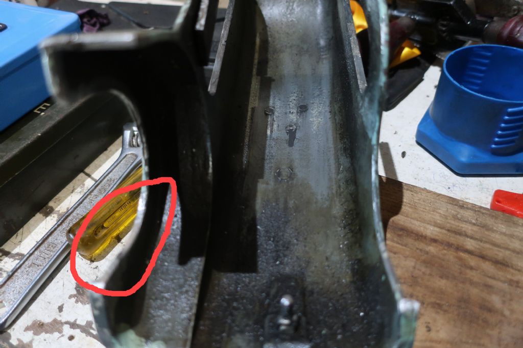

      28366c3c-86b7-4807-8b3e-0c50be012c4d.jpeg4e5d60e7-cb87-4d22-bd0f-32a082f4056e.jpegHi everyone,
      I have a problem with the headstock guard always rubbing against the gears producing noise.
      when I move the lever as if to change the belt the headstock lowers a bit and stops rubbing.
      the 2 pictures try to explain it.
      when I’m turning is there supposed to be a gap under the headstock as in the pic, the other pic shows the headstock lowered if you were changing the belt.
      thanks

          If I understand you correctly, the answer is no, the cover should stay latched shut when turning.
          If you have a look at the drawing in the manual (either buy one, or do an internet search and download it), that Swarf' uploaded for your clutch thread, there're a pair of adjusters (bolts 33 with locking nuts) the heads of which bear on a pair of flats on the pivot spindle (the one with the handle) – confusingly it has two different numbers depending on the drawing, it's 72 on mine!
          You should be able to adjust the thing so that the pulley clears the inside of the cover when under tension.
          Be aware that occasionally, the cover can shift – there are (or should be) a couple of metal plates 20, that 'close' the bottom edges of the oval slots that cover slides on, if these are missing, loose, or misaligned / not correctly engaged on their spigots on the bushes 26, the cover can slip and allow the pulley to foul the inside of the cover and prevent it closing properly.
          If all parts are there, in place, and and adjusted correctly, and the problem remains, you probably need to replace the belt.

            +1. If it's going up and down with the countershaft as you tension/detension the belt, those long oval slots on each side of the belt guard must be hanging up on the countershaft swinging H frame. They are supposed to fit over two stepped rubber bushes on the end of the casting and there should be room for the countershaft to lift all teh way up to tension the belt without hitting the end of the oval slot. If it is lifting the cover by the end of the slot, your belt must be too long. Standard belt is an A23 code number. It might be marked on the belt still.

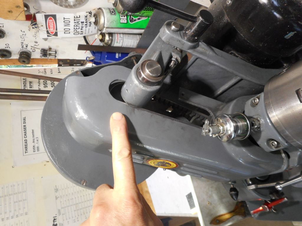

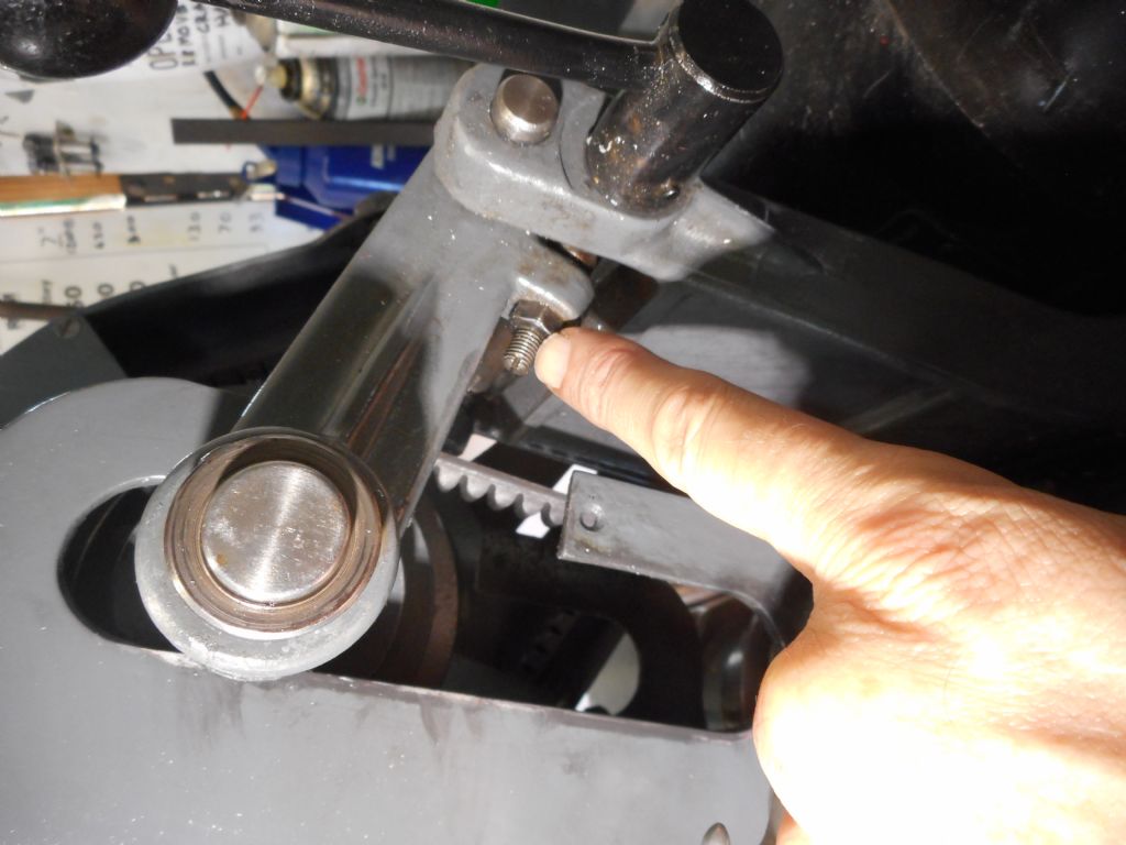

                    A couple of pictures here of my ML7 showing how it should look.
                    There should be a gap at the top of the oval slot when the belt is in the tensioned position.
                    There should be plenty of thread sticking out of the belt tension adjusters.
                    If the gap is not there and the adjusters are screwed way in, it means your belt must be too long. Either wrong belt or incredibly stretched — which would be unusual to be that much. Your belt should be an A23 or AX23, and is often labelled as shown.
                    Sorry about the sideways pics. They were right way up when I posted them. This site is beyond me.

                                If you have a gap at the top of that oval slot then the slots must be getting caught on one of the stepped rubber bushings on the countershaft swinging H frame that the slot is supposed to locate on. Careful inspection should reveal just what it is hanging up on.
                                If it was ok when you got the lathe then the problem is not belt length but a matter of holding your mouth right as you finagle the cover back into position.

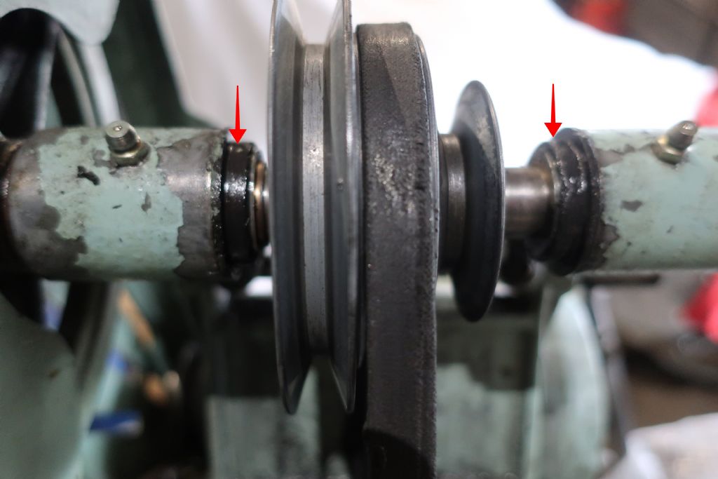

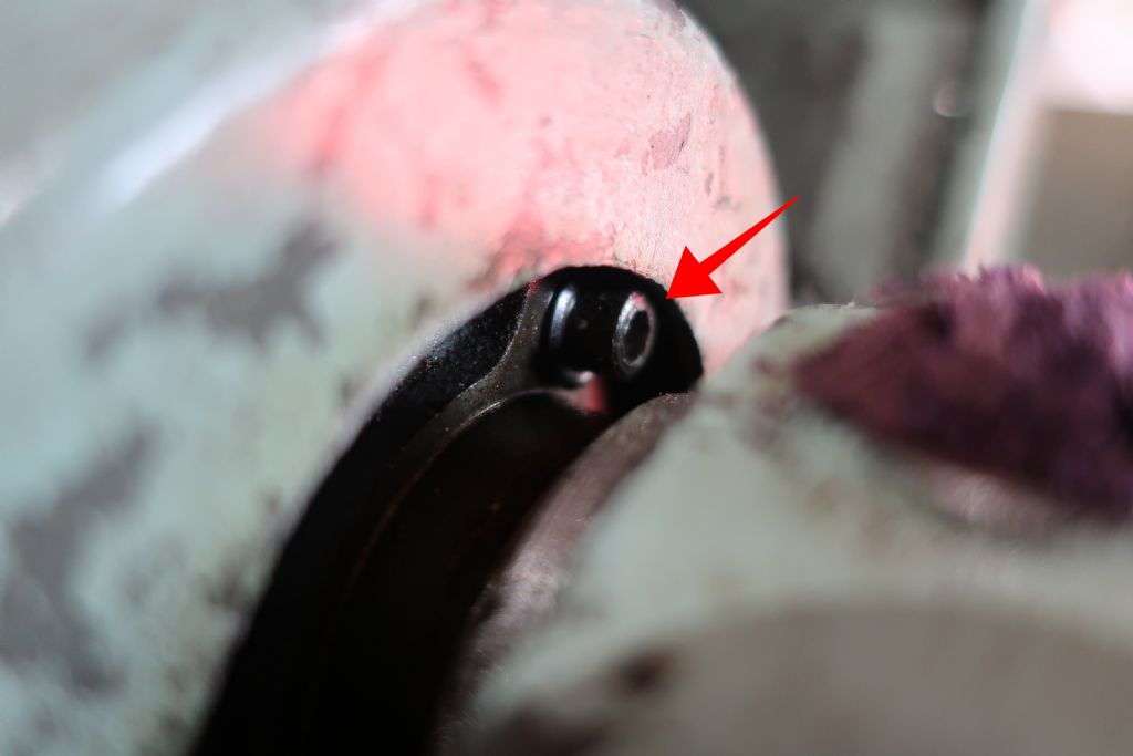

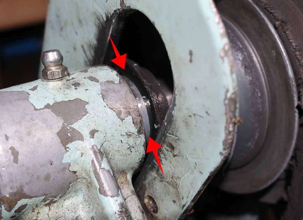

                                  ..I've been out and poked about in mine, too.. ..and discovered something, even to my own surprise..
                                  I can't make the belt & pullies come close enough to rub..
                                  On my ML, no matter how I displace or twist the cover, the only thing that ever rubs on it is the head of the Allen screw that secures the little 'dog' that locks the bullwheel to the spindle..
                                  ..the one that needs to released to use the backgear.. Might be worth checking that the dog is properly seated and the screw is comfortably nipped up.
                                  It doesn't take much misalignment for it to rub at all. Below is picture of screw, and them some of the stepped bushes and the way the slot in the cover can get around the wrong side of them, hope this helps clarify things.
                                  BTW – I think your lathe looks good (potentially better than mine), unfamiliarity with a machine is just a preliminary hurdle that has to be crossed on the path to getting to know it – a temporary thing and no reason to be disheartened..

                                    While I was at it I photographed the adjusters themselves and also the range of movement on my machine so that you can compare with other pictures here if you need to.. album 'ML7 Belt Cover'
                                    If the bullwheel screw isn't guilty, leave another post and I / whoever else gets there first can put them and a 'how to' up.. ..dinner & bottled sunshine call..

                                        Hi Nigel – apologies, I didn't mean to suggest that there shouldn't be a gap at the end of the cover slots, my second phot was to show how the bush can slide off it's spigot and allow the cover to 'slip behind' it.. ..in this condition the bullgear screw hits the cover

                                          I looked very closely again and found no bushes on there.
                                          I take it they are supposed to be a push-fit on those grey areas you point to (bearing-bush flanges?).
                                          On mine, these look narrower than your version, by comparison with the pulley in your pictures; and the cover sits loosely on them but with only about 1/16" radial play, and with similar end-float between the sides of the casting. This enough to let the cover's lower end end waggle about quite a bit, but though it is clear that the clutch screw-head has often scraped the inside of the cover, I found no interference with the pulleys.
                                          There are no obvious signs of my lathe ever having had these bushes, which would need be very thin-walled, but I found some fragments of a papery material clinging on somehow, on one side. Remnants of a 'Tufnol' fabric-based bush perhaps?
                                          Might we have slightly different editions of the machine?
