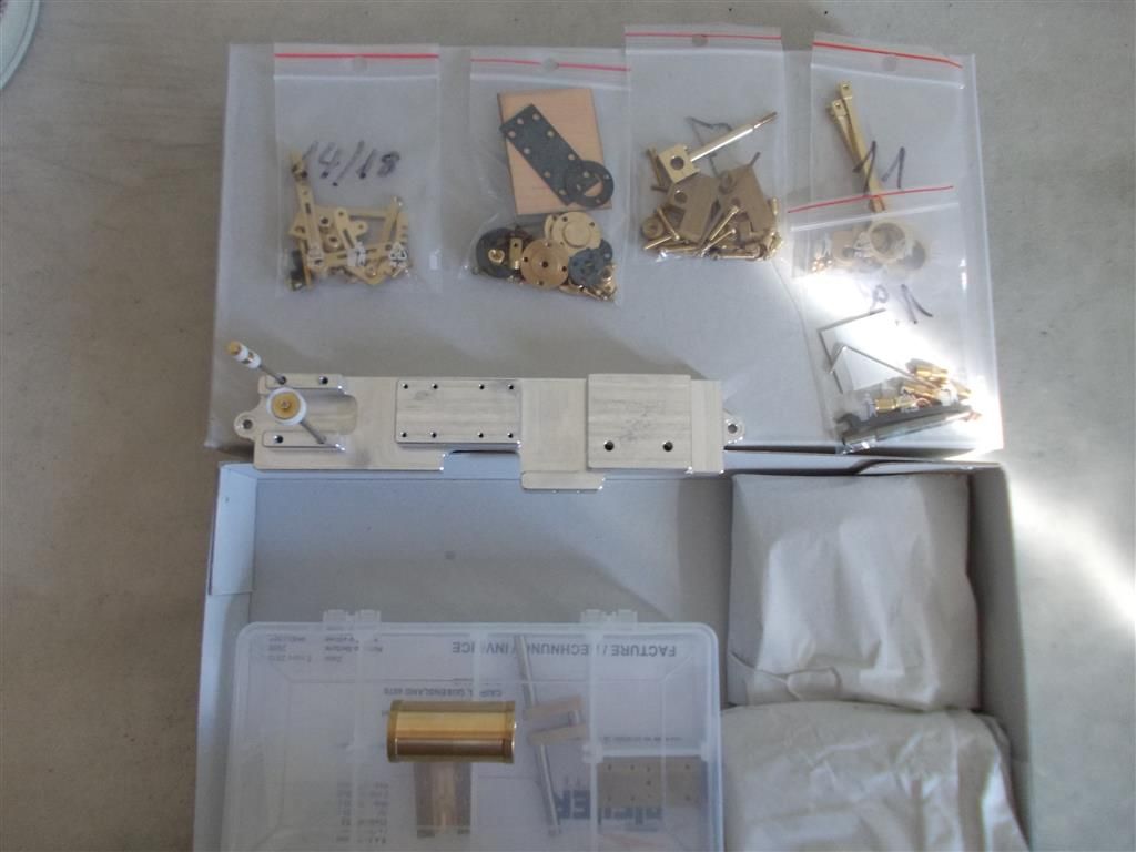

                              #184210
                              Brian John
                                @brianjohn93961
                                Here are some photos of all the bit and pieces. I have tried to show the Teflon wrapping around the piston and the valve. I initially thought it was just protective wrapping to be cut away ! If the Sieg C0 lathes ever come back into the country again then I would love to make a proper piston and piston ring to replace this.
                                #184224
                                Ian S C
                                  @iansc
                                  I think you'll find that the piston you have is pretty good, you just want a smooth bore for it, once it's bedded in it should last for ever (well a long time).
                                  Ian S C
                                  #184288
                                  Brian John
                                    @brianjohn93961
                                    I think the fit is a bit on the stiff side. If I had a piston without Teflon wrapping then I could put it in a drill and polish it down with some 2000 sandpaper. That is what I did with the PM Research engines ; it worked very well. But I will try it as is when the time comes for assembly. Perhaps some steam oil will work wonders !

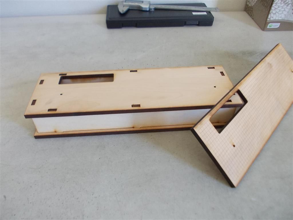

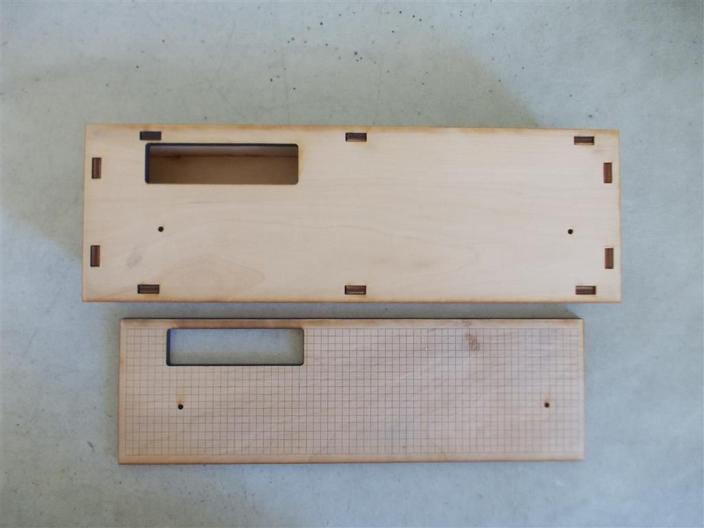

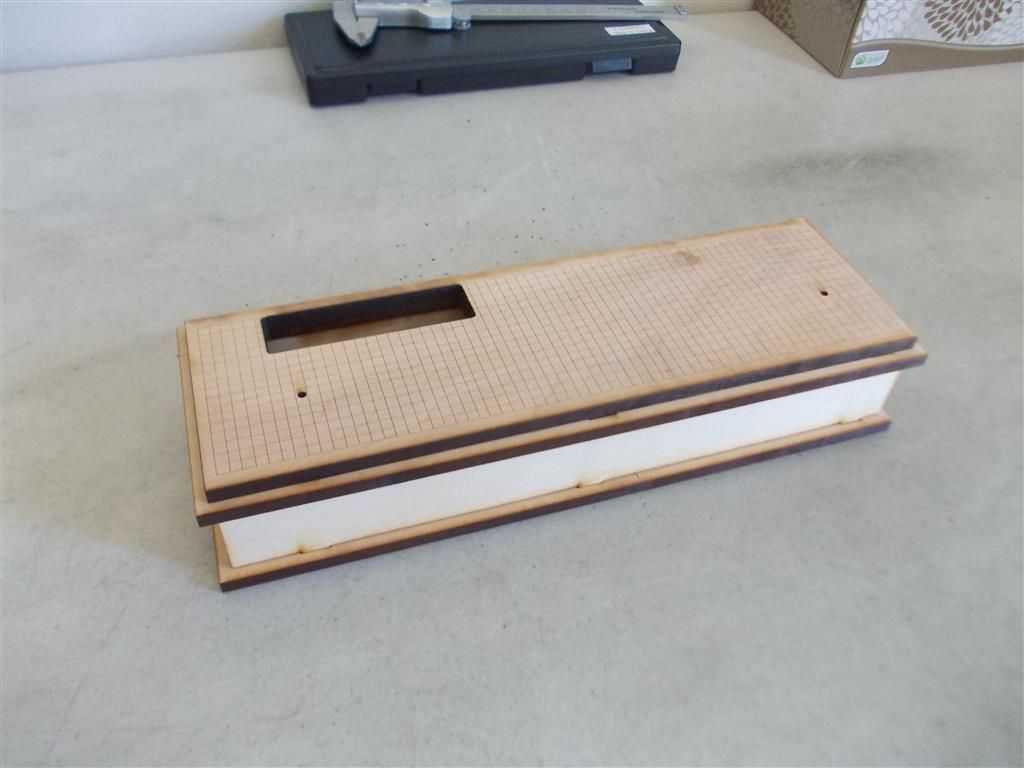

                                    #184704
                                    Brian John
                                      @brianjohn93961
                                      Here are some photos of the wooden base…all 40 Euros of it ! When the top is fitted it does not quite cover up the slots. I have purchased some thin balsa wood from which I will cut thin strips to act as beading. I am hoping that this will cover up the defects. I am hoping that a light sanding will remove the ''burn'' marks and the darkened edges. I assume that this has been laser cut ?

                                      #184705
                                      pgk pgk
                                        @pgkpgk17461
                                        I'd wonder how much sanding would be needed to shift the burn marks.. almost worth using them as accent features perhaps with a dark stain? Other options might include iron-on veneers, just paint, being clever enough to paint woodgrain – a bit of a dark art using combs and rag-in any knotting or tile/brickwork all flat surfaces while sanding/staining in the edges to be varnished beading….

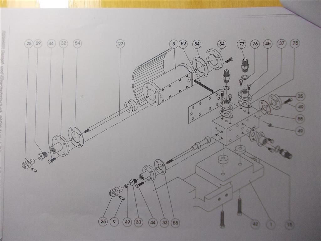

                                        #189215
                                        Brian John
                                          @brianjohn93961
                                          I have just arrived back after 5 weeks in China. I am making a start on this kit. I will put it together to see how everything fits and see what rubs together before deciding what to paint and what not to paint.
                                          I notice that this engine has two steam inlets which I have not seen before. Do I spilt the steam line into two using a T junction or something similar ?
                                          #189220
                                          MichaelR
                                            @michaelr
                                            Brian.
                                            I think the two ports are for the exhaust as your engine seems to have a piston valve, it may well have a centre steam connection for the inlet steam.
                                            I will stand to be corrected on this.
                                            Mike.
                                            #189223
                                              Yes piston valve
                                              In the instructions on page 3 the central connection has "zu dampf" or TO STEAM
                                              How it works
                                              J
                                              PS did you manage to bring back a lathe in your hand luggage?
                                              Edited By JasonB on 09/05/2015 17:48:19
                                              #189285
                                              Brian John
                                                @brianjohn93961
                                                Thank you : the centre connection is the steam inlet. That makes things easier. I still do not like their Teflon coated piston. It does not look like it will last very long. A new piston and piston rings will be the order of the day when I get a lathe.
                                                No, I did not bring back a lathe . I thought Melbourne Tool Shop would have new stock of the Sieg C0 by now but again they have been told by the supplier : ''end of next month'' . This has been going on for many months now ; it is very frustrating.
                                                Edited By Brian John on 10/05/2015 04:06:31
