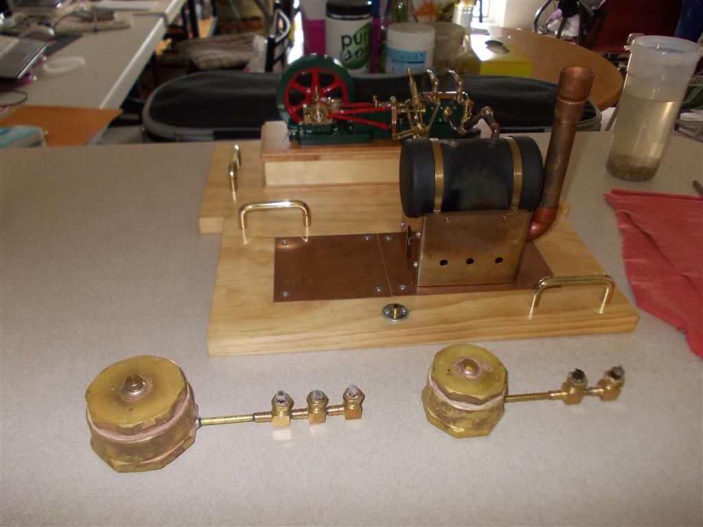

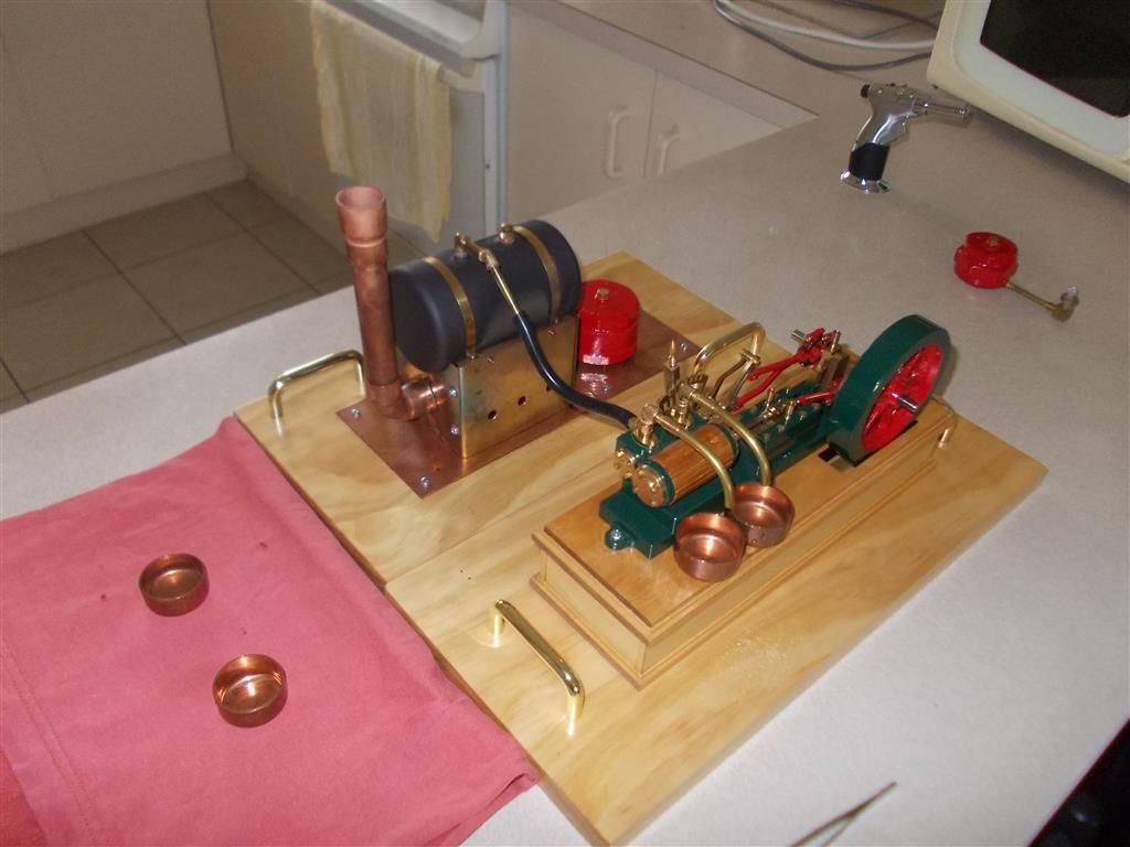

                        NEW STEAM TESTING : I have been running this engine on air for an hour per day for the last month. I suspect that this may have worn that Teflon seal down a bit so I tried to run it under steam today. The results were better but not outstanding. It did run at first but quickly ran out of puff. This happened with the MIDWEST wobbler engine so I then placed a piece of 1/8 tube inside the 3/16 steam outlet to restrict it. It worked with the Midwest engine but not with this one. I then installed a globe valve (not in the picture) in the steam line and opened it just a crack but with the same result. The engine runs for about one minute and then runs out of puff. I think I will need a stronger boiler to get this engine going for any length of time.
                        Quite strange as the PMR twin cylinder and single cylinder engines runs very fast for about 20 minutes with this boiler. But at least the Liegende engine was running on steam today so some progress has been made. I think I will still have to make proper pistons for the valve and main cylinder. I will also have to find some way to increase the heat to this boiler….gas perhaps ?
                        NOTE : the chimney came off the firebox towards the end of testing. I had used 243 degree soft solder so I was quite surprised. I did not expect that to melt. I will have to silver/hard solder it tomorrow but this could be tricky as the front plate of the firebox is only 0.6mm thick and could easily melt. A copper front plate may be required.

                        #208298
                        Brian John
                          @brianjohn93961

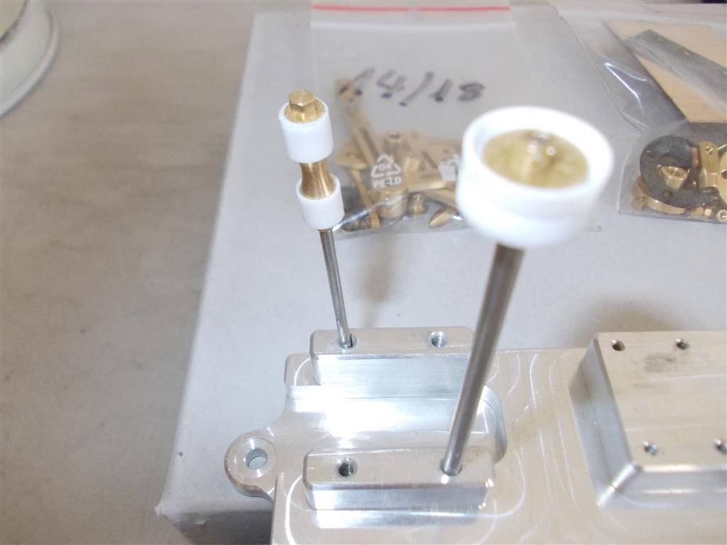

                          Rather than cutting a new valve piston and new main piston from scratch, might it be easier to remove the Teflon wrapping and fit a brass or aluminium sleeve around them. The sleeves could be fixed in place around the existing pistons with Loctite.
                          Edited By Brian John on 18/10/2015 08:58:08

                              Try plugging the chimney hole. That way the hot air will travel up and around the boiler and I bet you will get more puff.
                              The molten solder proves how much heat is being wasted up the chimney.

                                Ian : I managed to get plenty of stainless steel rod from Hobby Mechanics. I cleaned him out of all he had left ; He will not be getting more. Some of it is bent but most of it is useable. There is plenty available on ebay as it is used for model helicopters.
                                Neil : yes, good point but the Teflon has to be replaced eventually. It is only designed to last about 200 hours. I suspect it is already starting to wear.

                                      I used graphite impregnated Teflon for the bush through the piston of my second hot air engine, a BETA type, after 1000 hours of running I stripped it, and overhauled it. I had to ream out the Teflon bush, as it had got some oil on it and it swelled, It has done a hundred or so hours since overhaul, still no wear. It has a 1/4" stainless rod running through it, and generally runs at 600 to 1000 rpm.

                                        The Teflon that is on the main piston is a type of flexible cloth. The Teflon on the valve piston is firmer….more of a solid sleeve.

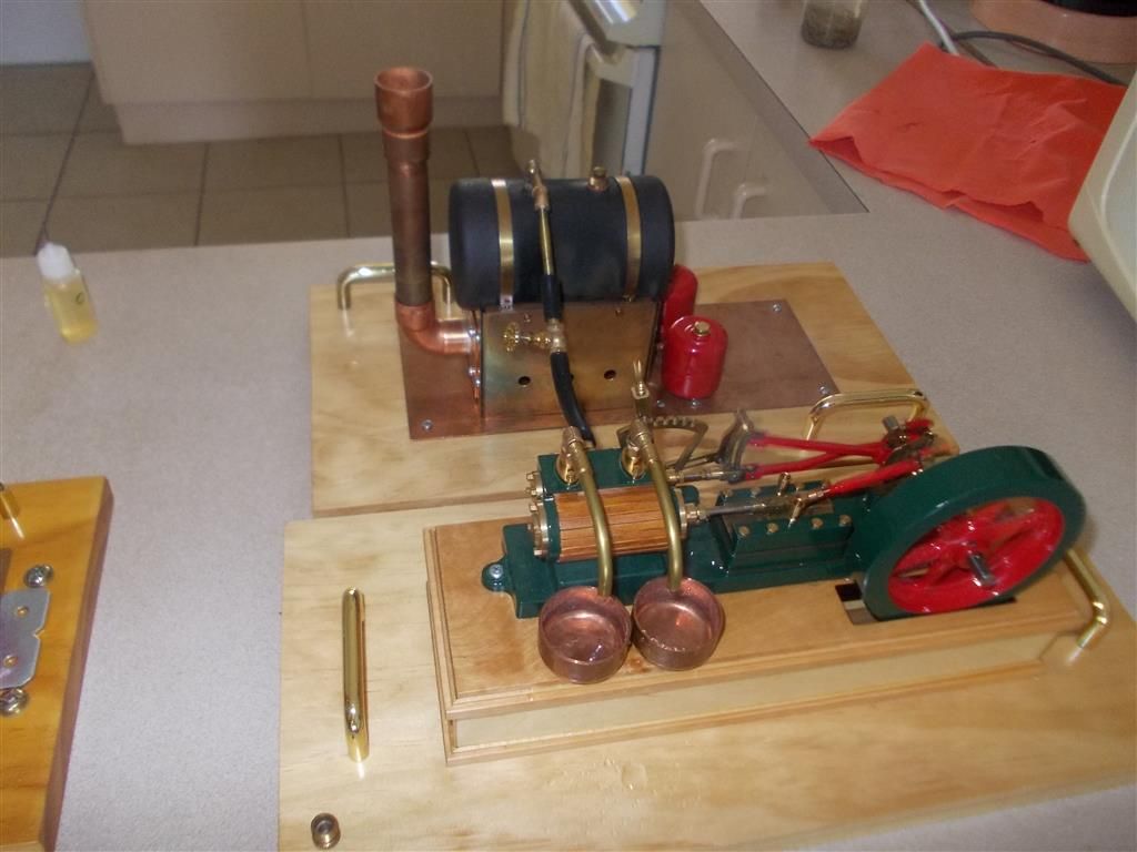

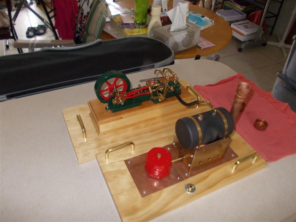

                                          Some success today steaming this engine. I plugged the chimney as advised and the engine ran well for over an hour before it started to jam up. I suspect that eventually some water formed in the cylinder. It even ran badly on air for about 15 minutes before it settled down. I always run the engines on air after steaming.
                                          I will have to get back to building the triple meths burner as originally planned. This engine runs better with lots of steam ; the double burners are not quite enough.

                                            Today I have tested the new triple burner and another double burner ; it ran well but not much better than the double burner. I was expecting a big improvement but did not get the result I wanted. I may need a gas ceramic burner for this engine. There is still a lot of water going through to the engine but it is not causing the problems that it used to. I am yet to try running the steam pipe through the firebox.
