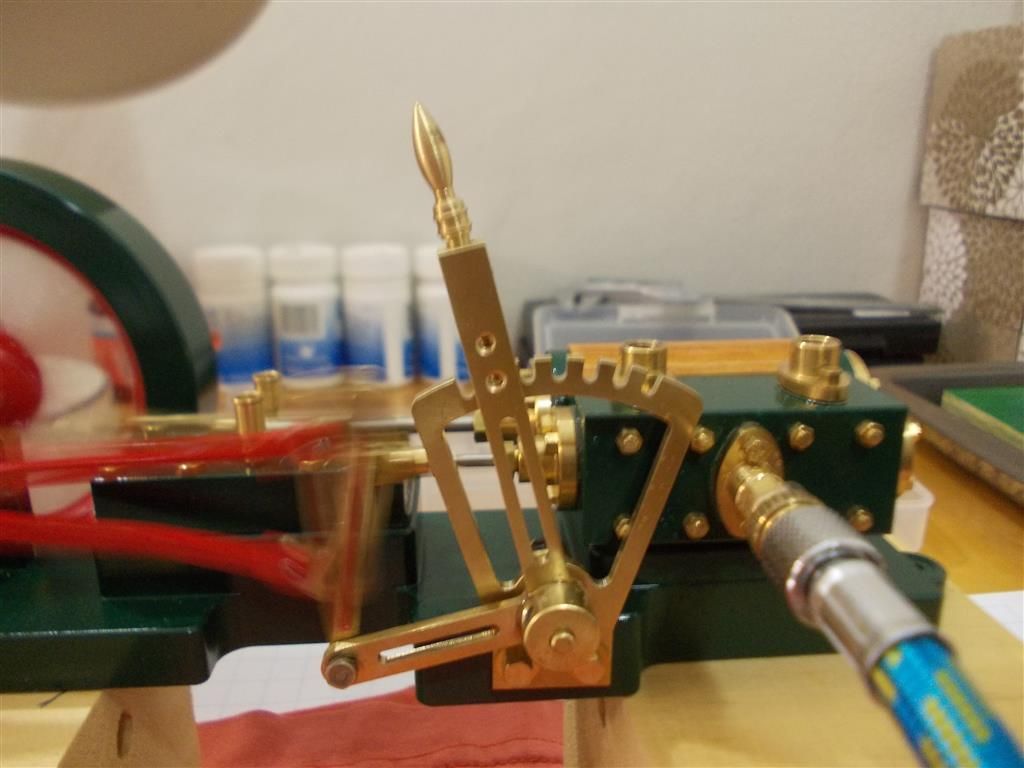

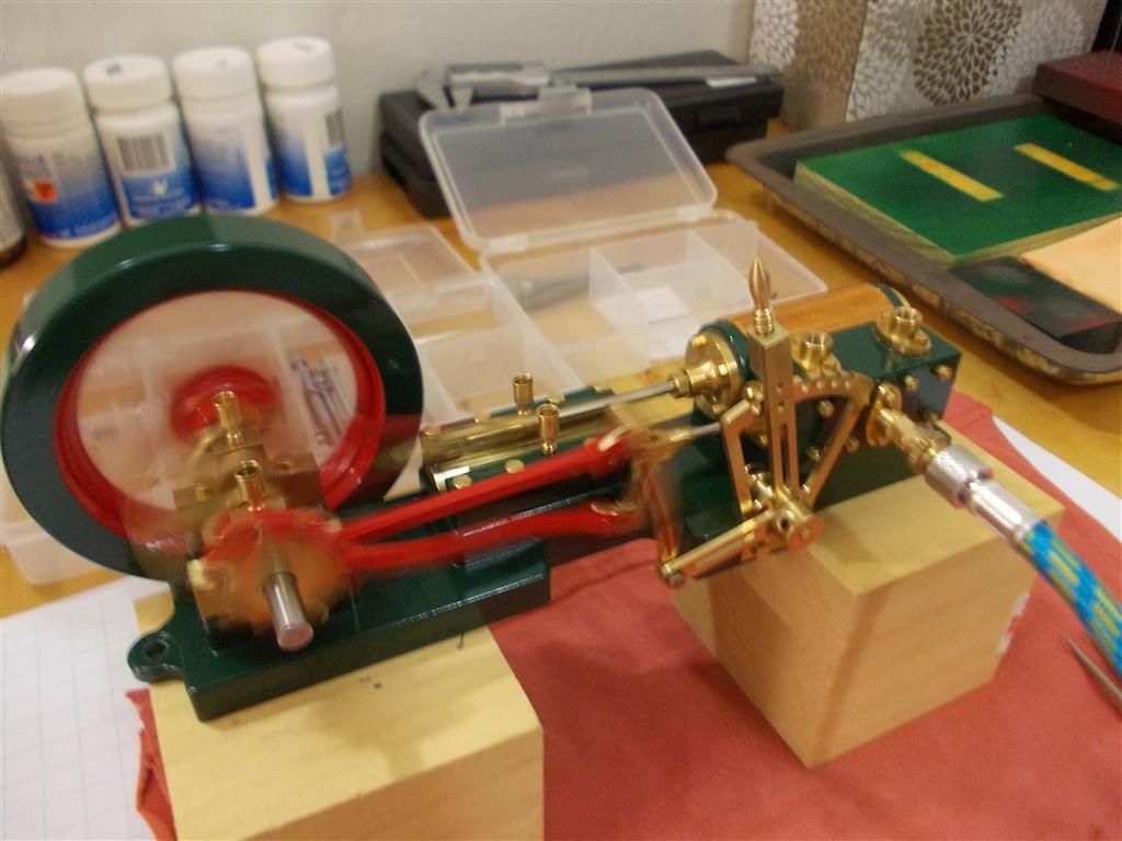

            I have assembled the engine for test running : it does run but not very well at this stage. I do not think I have the control/valve cylinder set correctly. It is the only part of the translated instructions that are not very clear to me. The main piston is set correctly as the cross head runs evenly in the cross head guide as per the instructions.
            The engine does not run when the reversing lever is on the middle notch (neutral?) and I think that is correct. It hardly runs at all on the 1st notch to the right or left . It runs very well on the 2nd notch to the right or left. Then it run slowly on the 3rd notch to the right or left. I think it should be running at maximum speed on the 3rd notch. This is why I do not think I have it set up correctly.
            Does anybody have any suggestions ?

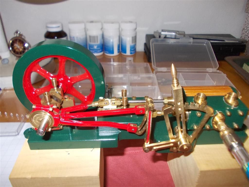

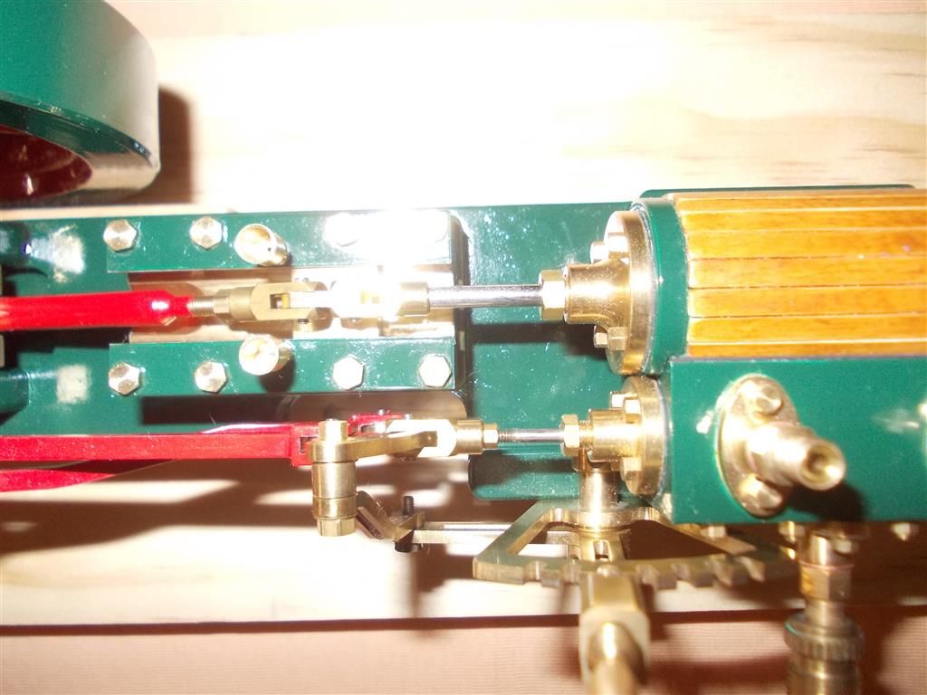

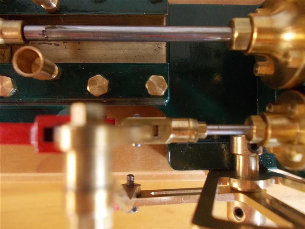

                I have got this engine running perfectly …for a while ! The problem is the lock nut on the control valve : it keeps coming loose. If I tighten it up too much then the engine binds. You can see the lock nut just in front of the clevis on the control valve rod. After about 30 minutes of running the control valve has worked its way out of the clevis hence affecting the timing and it starts to run badly. PM Research engines have a similar lock nut but I never had any problems getting their engines adjusted to run smoothly. Any suggestions ?
                NOTE : the engine is mounted on some scrap timber while I wait for the PU on the wooden base to dry and harden.
                Edited By Brian John on 03/08/2015 12:05:26
                #199044
                  The thread is possibly not perfectly aligned, so tightening it up may be skewing the clevis to one side.
                  Simple bodge – a drop of nut-lock.
                  No one will know except you and me

                    Neil : yes, I had considered that too but I thought I would try to get some other ideas here first. I know exactly where to set things now so it should be no problem to do it that way.
                    Oddly enough, the instructions mention using Loctite on the main cylinder locknut (you can see it on the connecting rod/clevis) but there is no need for Loctite there as it cannot possibly move ! They specifically mention NOT to use Loctite on the control valve rod
                    UPDATE : Amongst the many odds and ends left over in this kit was a small washer. I had been warned that there are many left over bits and pieces in this kit as it has been revised many times over the years so ''do not panic''. I decided to fit this small washer between the clevis and the lock nut. I will run it for a few hours tomorrow to see if it helps.
                      That's so you can adjust it. Once it's set right…

                        Posted by Neil Wyatt on 03/08/2015 14:48:19:
                        Brian,
                        Sounds like an ideal place to use Loctite 222
                        [you shouldn't need me to find the specification for you]
                        Edit: … as I have mentioned before; Loctite is a brand-name, not a specific product.
                        Personally, I would not take seriously any advice to use or not use "Loctite"
                        Edited By Michael Gilligan on 03/08/2015 15:37:04

                          The washer seems to be helping and the lock nut is not loose yet. But now the tiny screw holding the clevis is coming loose . Amazing : the only two screws you do NOT want to Loctite on the whole machine are the two which keep coming loose !

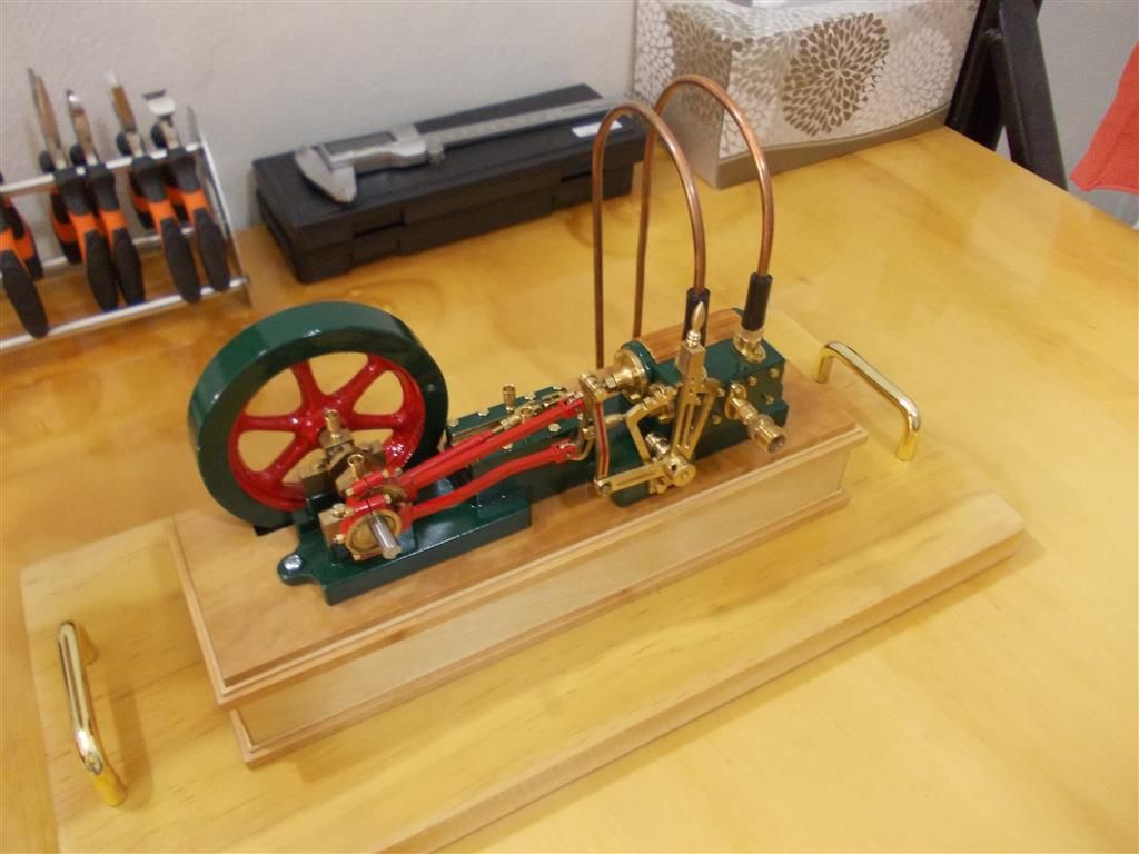

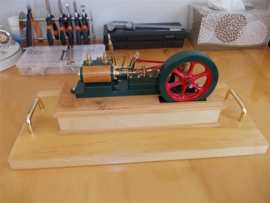

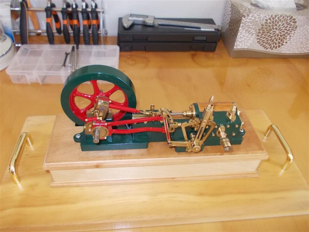

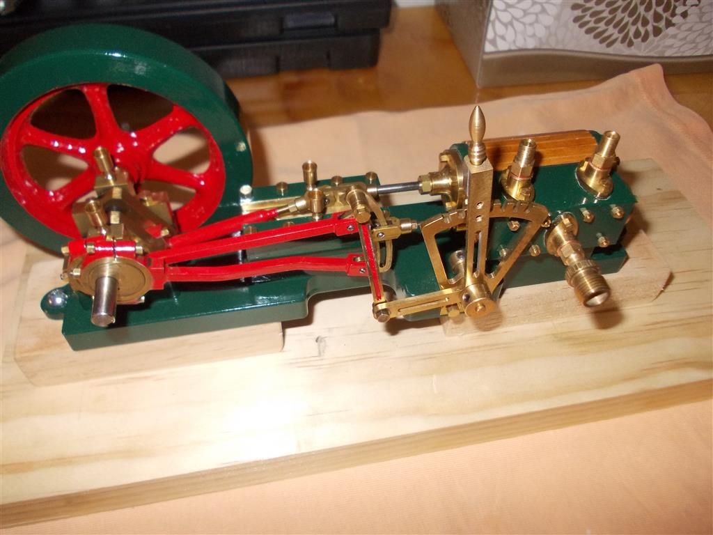

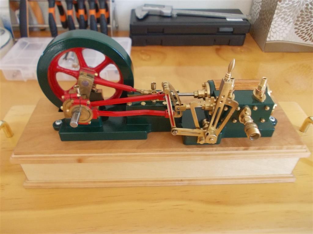

                              Here is the completed engine mounted on its wooden box. I think there was as much work to make the box as to build the engine ! The engine runs well on air ; I will run it on steam later this week. I will fit a displacement lubricator when I make a 3/16'' to 5mm adaptor.

                                Well, the first steam test did not go well. This is my first engine with the exhausts on the top rather than the sides and as I suspected the water is not readily emitted and the engine ''chokes''. I will try again tomorrow : I will only half fill the boiler to eliminate any water getting into the engine. Unlike my other engines, this one does NOT like water in the cylinders as it jams up tight !
                                The lock nut on the control valve is still causing problems. It is time to try something different : I have moved the lock nut to the farthest point on the rod closest to the cylinder and used Loctite to hold this in place. It is now no longer a lock nut ; it is an adjustment nut. Hopefully I can now use this to adjust the length rather than having to remove the cylinder cover and adjust the valve using a nut driver. I know exactly where the valve should be set so I will put three 8BA washers between the nut (total of 1.6mm) and the clevis and then Loctite the rod into the clevis.
                                I suspect that the thread on the clevis is a bit oversize and this is why it is not holding. If I could get spare parts then I would order another but Regner in Germany never respond to my emails.
                                Edited By Brian John on 10/08/2015 08:13:00
                                Edited By Brian John on 10/08/2015 08:30:00

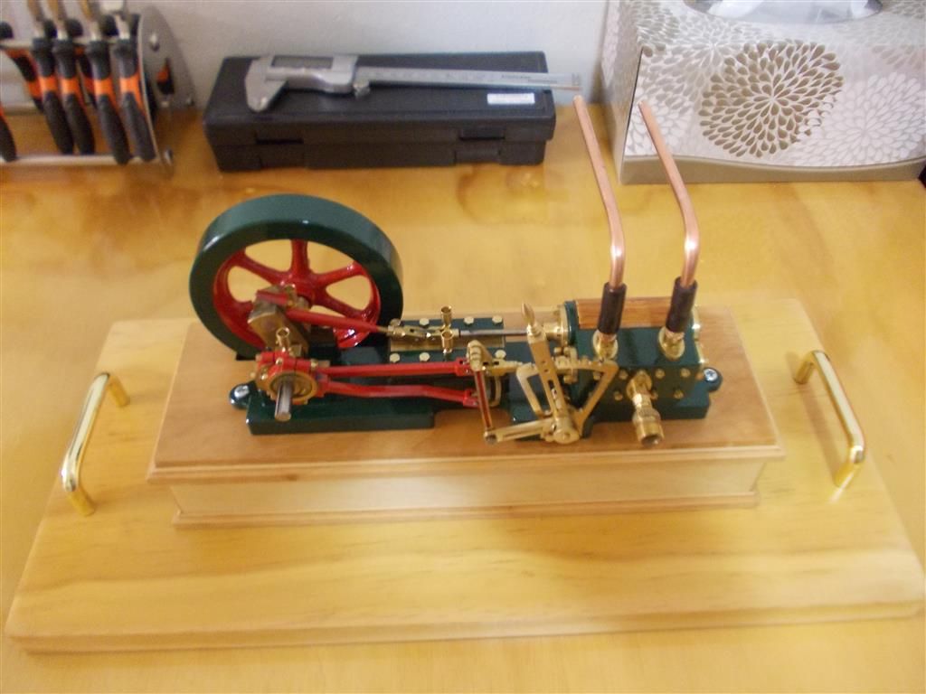

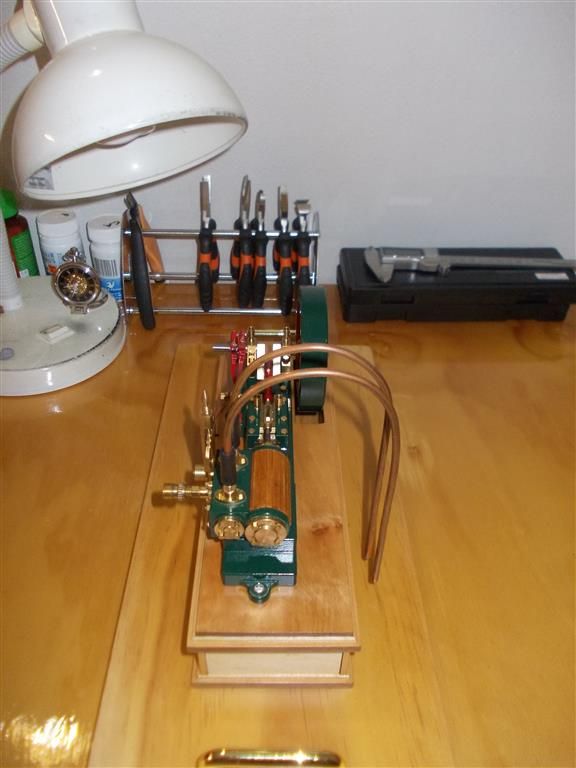

                                      I am trying to bend some copper pipe to fit to the exhaust so as to help the steam and water drain away but my results are not very elegant at this stage.
                                      1. Does anybody have any photos of other engines with the exhaust vents on the top of the engine ? I am not sure what I am trying to do !
                                      2. Why put the exhaust on the top anyway ?
                                      #200005
                                      Brian John
                                        @brianjohn93961

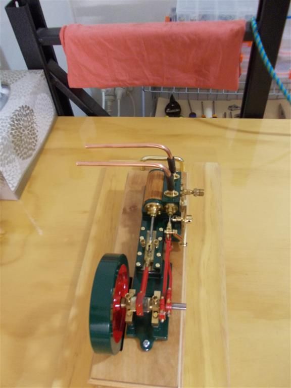

                                        Here is some 3/16 copper pipe used to make the exhaust. It was my first attempt at using the bending spring and I am not really happy with it….it looks ugly ! Today, I bought a bending tool used to bend pipe for brake lines. What is the smallest diameter I can expect to get on 3/16 copper pipe ?
                                        #200010
                                          To me that will just make things worse as any steam making its way out of the engine will condense in those pipes and run back into the cylinder, if you want to pipe it away put a tight 90degree elbow onto each outlet then the pipe.
                                          Bend will be determined by the former on teh bender.
                                          Edited By JasonB on 11/08/2015 12:23:04
                                          #200017
                                          Brian John
                                            @brianjohn93961
                                            The tube bender is useless as it puts a kink in the bend. I will take it back tomorrow. This is the best I could do for now as I have run out of pipe The good news is that my modifications to the control valve and its lock nut seem to be working as intended.
                                            NOTE : I did the rounds of air conditioning suppliers, brake line suppliers and the scrap yard today in the hope that I could find something to use as a nice short sharp bend but I came up with nothing. One guy suggested beer tap fittings which I will look into tomorrow.
                                            This is what I need  but I cannot find in Cairns :
                                            http://www.ebay.com/itm/20-Pieces-New-Schneider-Barb-Elbow-90-Degree-Brass-3-16-/151375065088?hash=item233ea83000
                                            Edited By Brian John on 11/08/2015 13:09:31

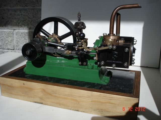

                                              Here's a Stuart Turner That I did a rebuild on with the plumbing on top, I think if I had done the original build, the exhaust would have been on the bottom, and if it was being built for steam, drain cocks would have been fitted. It will have to stay as is because it got nicked 2 or 3 months ago.
                                              #200022

                                                    Brian, you could make a very simple version of those elbows that you linked to, just drill two holes at 90degrees into a block of metal so they meet and then solder a bit of pipe into each hole.
                                                    This is 1/4" stainless pipe bent on one of those cheap Record hand benders, about 3/8" internal radius
                                                    Edited By JasonB on 11/08/2015 14:49:30
                                                    #200046
                                                    Brian John
                                                      @brianjohn93961
                                                      Michael : Wait until I have the lathe ? How would I use the lathe to make a 90 degree pipe bend ? That is not something I thought I would be making on a lathe.
                                                      Jason : yes, tubes into a block should work. I see now that the height above the steam outlet must be kept to a minimum. I still think it is a poor design putting the exhaust on the top.
                                                      Edited By Brian John on 11/08/2015 17:40:27
