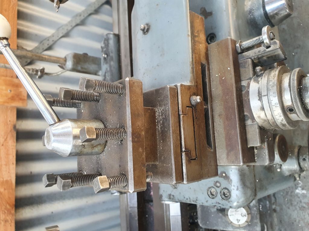

  • #543010
    Francis Greenslade
      @francisgreenslade46432

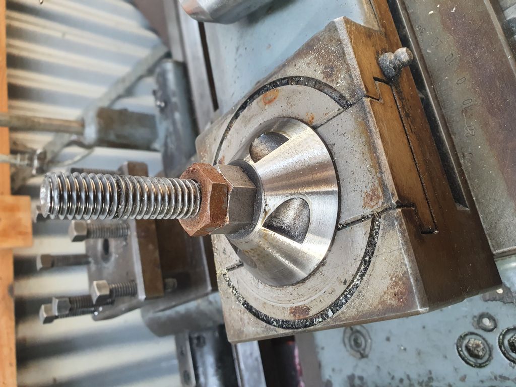

      hi All,
      Any recommendations for fitting a QCTP to my Harrison L5A. I would like to do the least amount of modifications as possible. The main bolt has a cone which can be removed but it works really well locking the original tool post down as it is.. I was wondering if there is a QCTP with internal cone that would fit on it? I tried removing the cone and just locking the 4 sided turret down on the flat surface but it doesn't hold as well as the cone.
      Really all I want an adjustable way of centering my tools without having to use packers.
      Any advice welcome.
      cheers
      Frank Greenslade
      New Zealand

          Clive Foster
            @clivefoster55965

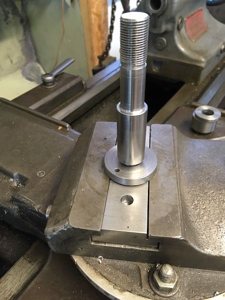

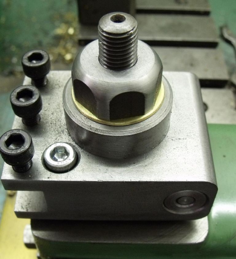

            Frank
            No way of accommodating the cone inside a standard QC post. They are usually harder than a woodpeckers beak so modification isn't realistically possible.
            Nearest you can get to the cone for rotational location is the Dickson style pin that can be dropped into suitable holes.
            As you have a T slot mount its not too difficult to make a new full-lengthTee nut to take a new pin sized to match your new tool-post. Picture shows one I made a while back for my P&W model B.
            I screwed and glued together two standard flat bar sections to make the Tee nut. Post screwed and loctighted in with a collar matching the recess in the Dickson T2 tool post screwed down to further locate it. Index holes provided for the tool post pin even though I never use it. I put a couple of short hex socket grub screws in to further locate the Tee nut. I made sure the top of the slide was flat so the post holds without heaving up on the spanner. I have a thin alloy shim between post and slide to equalise the tool post heights on my two lathe so I can swop tooling. The alloy shim improves grip.
            Do remember that the approved technique is to make the stud undersize so its a slack fit in the tool post bore and use a top hat style spacer made a nice sliding, shake free, fit in the bore and on the stud to centralise things. Official parts seem to be about 1/4" thick on the outer rim that the nut clamps down on with about 3/8" going down into the bore. Presumably this avoids issues should the stud not be truly vertical. My rim is about 1" deep to clear the tool holder studs so I could use an ordinary spanner until I got round to making a dedicated box spanner.
            Worst issue with a QC system for ordinary folk is the cost of all the holders needed to keep the tools you use ready for action. Most folk seem to reckon 12 would be nice! I have rather more.
            Hafta say that if I were in your position of not already having a QC system I'd seriously look into organising rapid change block tool posts. Shimming tools to centre is much less of a faff when you cna do it on the bench by measurement. Much cheaper than a QC system as 2 and 4 way blocks can be built up from standard sections screwed and glued together. Easy way to make a rapid change block is to make the stud free rotating with a large hollow castellated "nut" screwed into the top with a tommy bar going through both nut and and stud. Half a turn will release things sufficiently for the bar to be withdrawn so the block can be lifted off and another one with a different load of tools fitted. and locked with an opposite half turn of the bar. May be easier to make the tool post stud in two sections with just the top part turning.
            Clive

            DC31k
              @dc31k
              Remove the rusty half nut and the full nut below it. The cone will then come off, leaving the stud screwed into the T-nut in the slide. Remove T-nut and stud, leaving bare top slide casting. This is your starting point.
              Make new T-nut, stud and centring bush if required to suit chosen QC toolpost. If the dimensions suit, you can make the upper thread on the stud the same as you already have so you can reuse the clamping handle.
              If you want to seamlessly swap between the current one and a QCTP, you need to make a quick change toolpost post.

                Nigel Graham 2
                  @nigelgraham2
                  That coned fitting will almost certainly be special to Harrison so you won't find a QCTP to suit if.
                  My Harrison's L5 has a plain top surface to the compound slide, and to fit a QCTP I found I needed simply make a bush to accommodate the tool-post stud and tool-holder body.
                  I would guess that the cone will come off the stud, giving you a plain mounting surface and stud to hold a quick-change post with appropriate bushes as I did. Or replace the stud if the new tool-post needs a smaller diameter.
                  Keep the removed parts so they can be put back in future if ever needed. On mine, I can easily swap back to the original clamp I need to use a tool too large for the QCTP.

                          John Baron
                            @johnbaron31275
                            Hi Francis, Guys,
                            I think that the cone is used to clamp the "T" slot, so removing it will mean you need something to replace it ! A flat steel plate would work, and give you a surface to mount another type of tool block. Personally I made my own new toolpost and tool holder to replace the QCTP and four way tool block. A relatively simple job, but you would need a mill to cut the tool holder slot. Even that could be done on the lathe but I wouldn't recommend milling using the lathe.

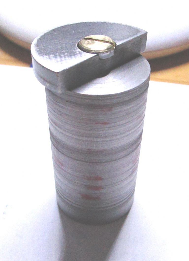

                            This is a picture of mine !
                            It is called a "Norman Patent" tool post. I also made one for the rear of the cross slide, mainly for a parting blade but the tool holders are interchangeable so I can use either at the front or rear. No shims needed to set tool height either. The silver cap head screw sets the height of tool.
                            I made this height gauge to use to set the tool on centre. The underside of the cap is used for the front and the top of the bar used to set the parting blade height.
                            Moe pictures in my albums.
                            HTH.

                            Clive Foster
                              @clivefoster55965
                              Francis

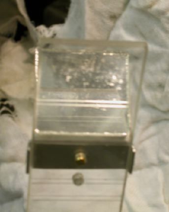

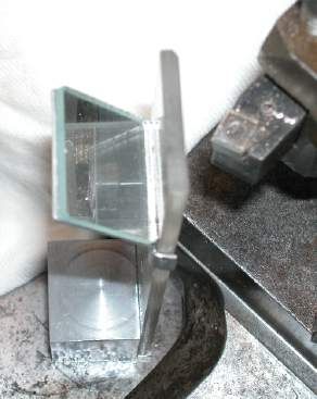

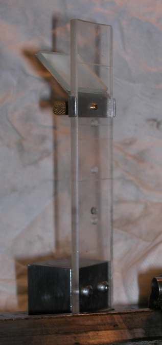

                              There are many designs of tool tip height setting systems out there.
                              Possibly the simplest "quick and dirty" one is a simple block to sit on the bed with the bent end of a scriber screwed into it so the point is exactly on centre height. Needs a three piece scriber but if you are willing to sacrifice the bent end cost is basically nowt.
                              Most common designs have a base and stout post with a pair of flat bottomed indicator pointers affixed to it. One pointer is set so its bottom is at centre line when the base is on the lathe bed and the other, set lower, is on centre line when the base is on the cross slide. Normal practice is to make the indicator pointers sharp so they can be used to scribe witness lines at centre height on a job. Not a feature i've ever felt the need for but most well respected correspondents consider it desirable.
                              I prefer an optical version having an adequately thick transparent plastic plate is held vertically on a base with witness lines scribed on both sides at using a sharp centre. One set of lines is made with the base on the lathe bed, the other with it on the cross slide. Some creativity is needed to do the lathe bed reference lines. Unfortunately I can't remember how I did mine. Having lines on both sides means that when looking horizontally through the plate you see only one line so tip height can be judged from some distance away. I have a mirror that can be mounted onto mine so I can look down rather than through. Most of the time I just work off the front line but sometimes when setting up mid job the device cannot be got close too the tool tip. My perspex plate is only 5 mm thick which is on the thin side, 10 mm would be better. I'll change it if a piece of 10 mm ever comes my way but what I have works well enough.
                              Using the mirror
                              Lines
                              Although effective all these versions of the conventional tool height gauge work best with QC and similar screw height setting systems.
                              If you are using packing it would be much nicer if the actual tip height could be measured and packing stacks made to the correct height rather than trial and error. I have seen depth micrometers and verniers set-up to do the job but usually only as temporary expedients. Back in the day dedicating a proper measurement instrument to the job was unaffordable for Home Workshop and Model Engineer folk.
                              These days perfectly adequate dial gauges can be got quite inexpensively so fitting one with an "elephants foot" and on a suitably sturdy stand with fixed height arm would work well to measure actual tip height. Dial gauges have a small ball end screwed into the probe as standard so measurements can be accurately mate at a point even if the surface is imperfect. The "elephants foot" is an alternative end fitting able to measure edges and the like where aligning a small ball end is impractical. Typically 1/2" to 1" diameter made very flat and set exactly at right angles to the dial gauge probe. Can be bought as accessories but esily made with a bit of care. 1/2" will be fine.
                              Clive
