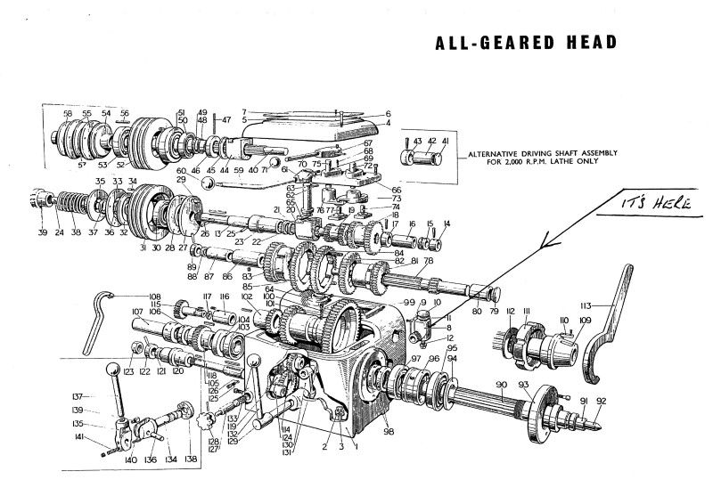

I am not a fan of stripping any machine more than I have to, particularly something like a headstock, or anything that will involve having to set it up again afterwards (apart from levelling, which is inevitable).
