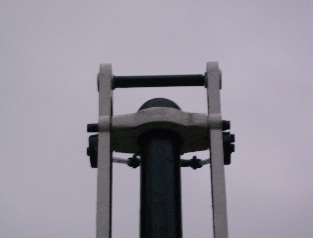

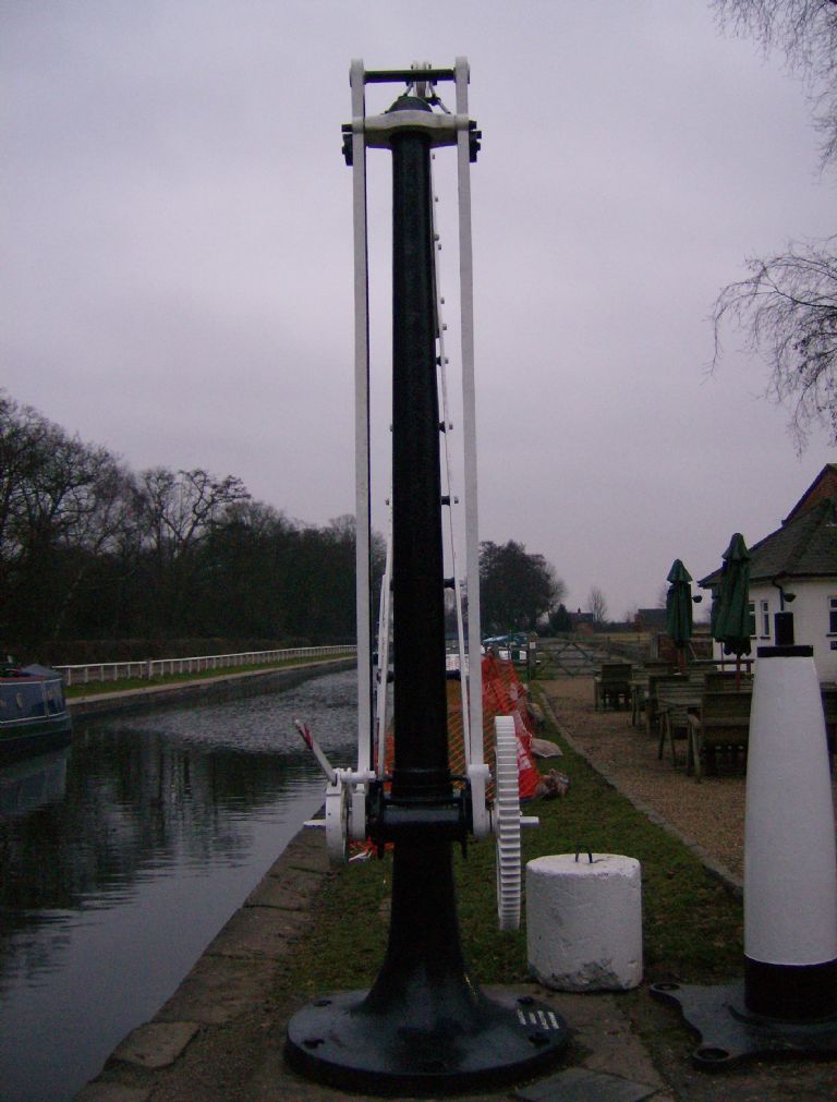

        I’ve nearly finished drawings for a hand crane that can be found at Fradley Junction. It is built around a double fram hanging on a tall central pillar. The winch drum is on one side of the pillar and the jib is on the other. This means the cable had to go up, over the top of the pillar and across to the end of the jib.
        There is only room for a small pulley, not large enough to guide the cable away from the top  bearing. Also, I imagine any pulley up there would need to be similar in diameter to the winch drum (8″) and the jib pulley (12″). I’m imagining a second large pulley stood off from teh top of the frame above the winch. I’m also assuming a wire cable, not a rope for this 15 cwt (about 750kg) crane.
        Is anyone familiar with this type of crane? Would it have had a rope or a wire cable? Any suggestions how it would be routed over the top?
        Thanks in anticipation for any suggestions!

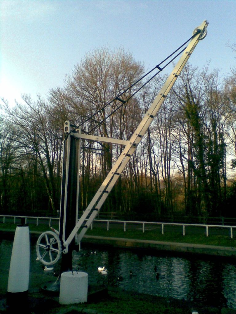

            Nothing as grand as that! It’s a small wharfside crane that was restored about 20 years ago:
            The cable run has to come from the drum up and over the pillar:

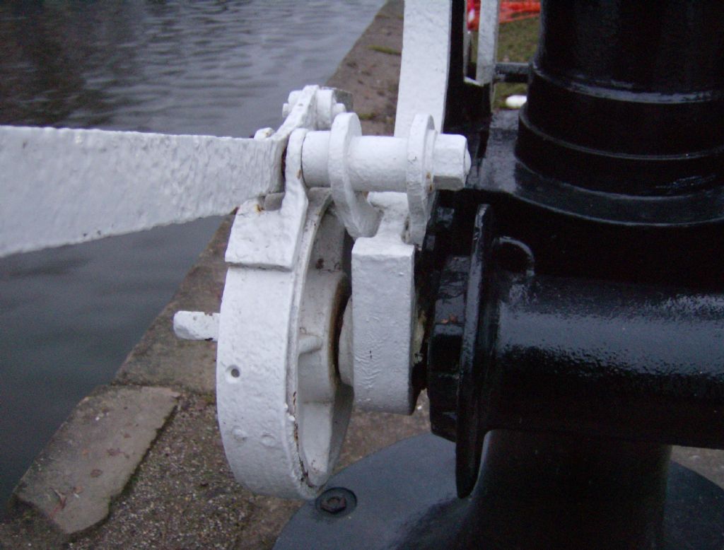

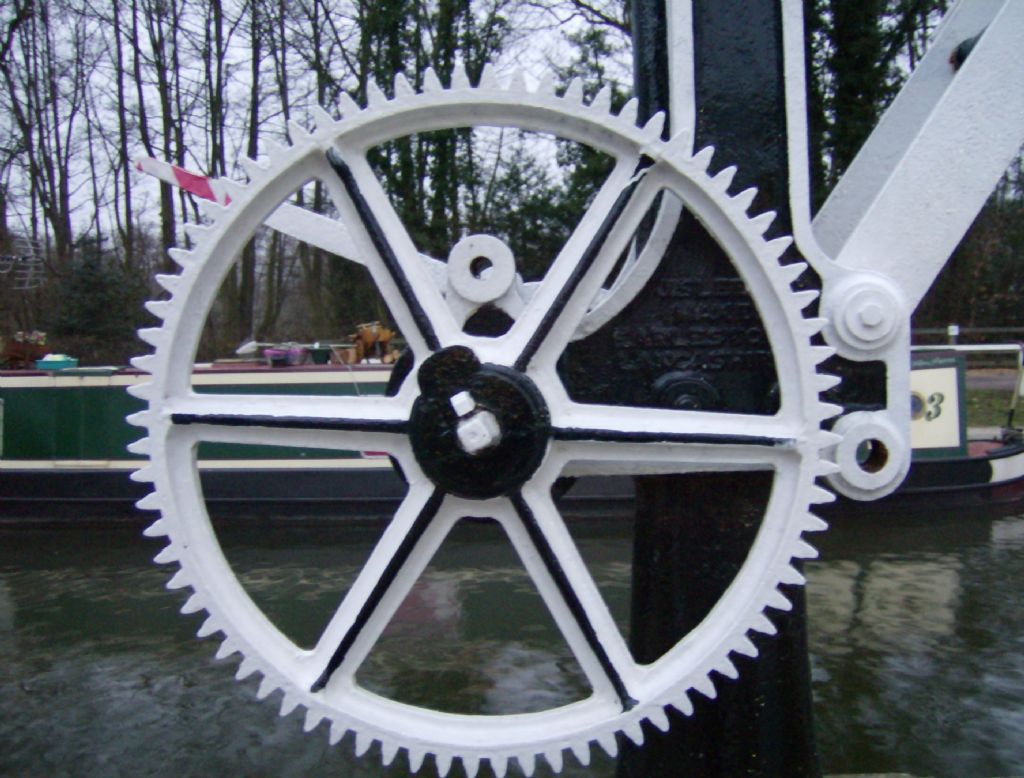

            The cable drum is here (note the fixing loop and ratchet – the brake is fitted to a replacement for a broken lug on the ratchet dog, the brake should mount on two studs that would position it to work on the – missing- winding handle).
            But this is the obstacle the cable has to get over – no room for a decent size pulley?
            My thought – the bar across to the jib looks wrong, if the pivot was mounted the other way around it could provide a mounting point for a pulley support:
            That’s the evidence! An ideas?

                Is it possible that a roller arrangement went on the axle at the top of the vertical column frames. Can’t make out whether this would give enough clearance for rope/chain to clear the yoke holding the top pivot of the crane or not. I have had a quick browse for hand cranes, both canal and railway, and not found anything comparable yet.
                Cheers
                Martin W
                Edited By Martin W on 09/02/2010 00:39:16
                #48402
                Ian S C
                  @iansc
                  I imagine the pully at the top in the form of a roller with a flange at each end,ie cotton reel shape,it would perhaps help with laying the rope/cable evenly on the winch. Ian S C
                  Edited By Ian S C on 09/02/2010 09:59:35

                    Much better explained but that was the sort of arrangement I was trying to suggest in my post. Its is the only thing that would appear to fit with the existing structure unless a second frame was mounted on the top axle which held a pulley but then why not just extend the side frames.

                      It is hard to measure something that’s on top of a 12 foot pole, but a 6″ diameter roller would foul the top bearing, and a 4″ diameter roller would not be large enough for the rope/cable to clear the bearing. You might just get away with a 5″ roller, but that’s a tight  bend. I shall go away and consult my old Machinery’s Handbook to see what would be a suitable rope and wire cable for 15 cwt SWL, and what radius it would bend to.

                        Hm – much food for thought. 15cwt is about 3/4 of a ton, taking a safety factor of at least 10 and the lesser typer of steel in Machinery would indicate 1/2″ wire rope (the groove in the pulley would take a larger rope, but the fixing loop on the drum suggests smaller.
                        A calculation for pressure on drums or sheaves in Machinery is
                        P=2*Tension/(sheave dia x rope dia)
                        With a 12″  sheave and a 1/2″ rope and 15cwt tension I make the pressure 550lbs. The safe limits given for cast iron with different types of wire rope vary from 300 to 800lbs.
                        With the winding drum itself being 8″ diameter, this suggests a wire rope at least 3/4″ diameter for safe running, and there’s no way you could get away with a small roller at the top if it was cast iron or ordinary steel.
                        For manilla rope you would need 1″ dia for a 3/4 ton SWL, perhaps that’s the answer, but a tight fit in the loop on the winding drum.
                        I’m leaning towards adding a second 12″ pulley on some sort of added frame.

                          I have had a look at the photo of the winding gear and, I expect you have tried this avenue, it looks as if the crane was made in Earlestown Lancashire. The manufacturer’s name I haven’t been able to decipher but it looks almost like Jeslee. Have looked at some historical maps for Earlestown but couldn’t see them mentioned, dead end . There was of course the railway works there which may have produced cranes etc. but no records.

                            I’v been looking at the net,and on a number of cranes of similar size and vintage chain is used rather than rope or cable.You proberbly will have see or know of the Ellesmere Boat Museum in Cheshire.They have a hand crane,and the chain is supported by rollers up the jib support similar to what I suggested.(type in Ellesmere Boat Museum, you’ll find photos,worth a look anyway). This looks like an interesting project, I get into similar sorts of jobs here in NZ,ie a vintage water turbine. Ian S C

                              I won’t lose anything by trying your suggestion – if there isn’t room, I just add a pulley instead.I will try and take l look at the elsemere crane.

                                You are probably aware of the fact that this crane was rescued from Horninglow Basin, Burton on Trent and re-erected at Fradley in 1977. I have a quick look to see if I could find any historical photos of Horninglow but to no avail.

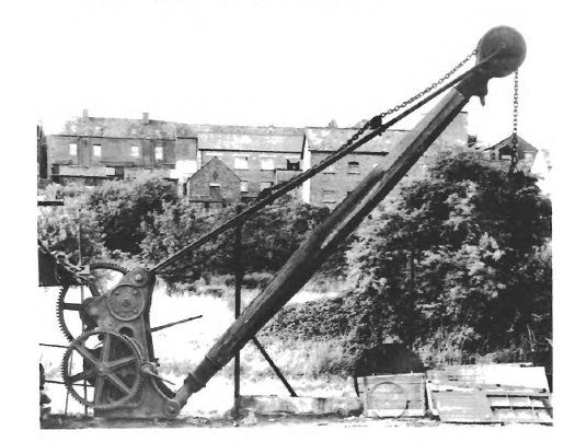

                                  I found this picture of a crane, not the same as yours, but it has a chain to the hook and like yours the stay from the jib to the column has several cross members which appear to be the chain support.

                                    Martin, that’s an amazing photo, the wooden beam is extraordinary!
                                    I’ll have to add that pic to my ‘future models’ file
                                    It’s rather bigger than mine – you can see it has two sets of gears instead of one and the handles are quite low down by comparison (or the crane is bigger and they are the same height, if you get what I mean). I’d guess the cable drum at right is about 4′ diameter.
                                    I see what you and Ian mean about rollers.

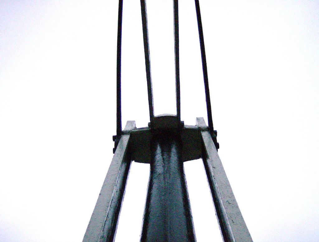

                                            I was wondering about J S LEE – I it doesn’t look right on the base so I took a close look at this:
                                            Get in close and it says  “J.SLEE” google Slee Earlestown and you turn up a plenty of links to a 19C manufacturer. So the info plate is wrong!
                                            Thanks for your description Ian, I think a second decent sized pulley belongs at the top of the pillar now. I have been reading ‘Machinery’s Handbook’ and a rope strong enough for 15cwt  would need a big pulley too. My money os on 5/8″ or 1/2″ rope and two 12″ pulleys now.

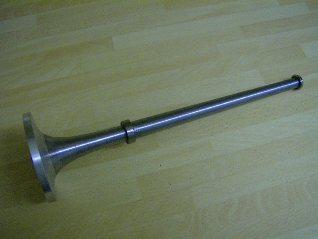

                                                    Well I’ve made a start!
                                                    This is the main pillar- about 12″ high – it’s in three parts. There is a small ball race at the top and one in the middle, to fit in housings which will be the spacers for the frames.
                                                    The upper part was the first taper I’ve made by offsetting the tailstock – not as traumatic as I expected, though using a toolmaker’s clamp as a driving dog was a bit ugly.
                                                    The base was a bit of 1 1/2″ “hi-tensile something” and a big square of 1/2″ aluminium chequer plate, fitted on a spigot. I truned the curve by working out co-ordinates to the nearest 5 thou, then taking it down with a round-ended bit, files and eventually a coarse foam-cored sanding block. The bottom is hollow and an M6 bolt goes into the bottom of the middle and runs into a spigot on the bottom of the top (if you know what I mean).
