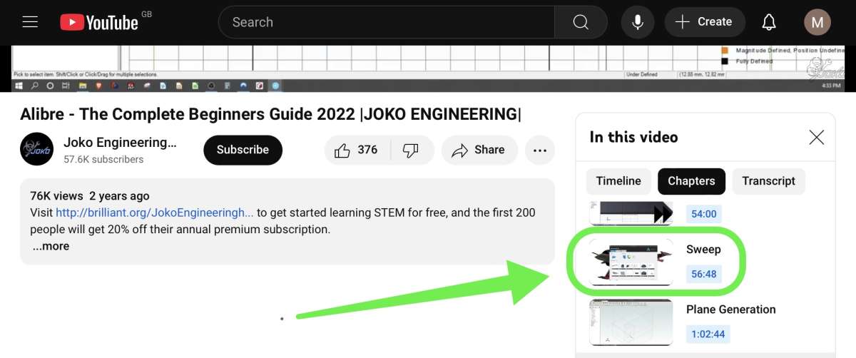

            I hesitate to throw-in yet more advice, Nigel … but I think I may have found a tutorial that would suit your mind-set.
            Caveats:
            1. I have only watched a few minutes so far
            2. it includes advertising for ‘Brilliant’
            3. I am unlikely to ever actually use Alibre Atom
            With all of that said: I plan to watch it later today, just for the sake of background learning.
            https://youtu.be/YyXBWuQy3ss?feature=shared
            Nigel
            Please don’t worry about why I am posting at this ungodly time … that’s my problem not yours.
            For the sake of my sanity though  … Could you please watch the ‘Chapter’ about Sweep.
            I don’t use Alibre, and have only watched his tutorial out of general curiosity, but this Chapter  [in the space pf less than three minutes] seems to perfectly convey the basics of using that tool.

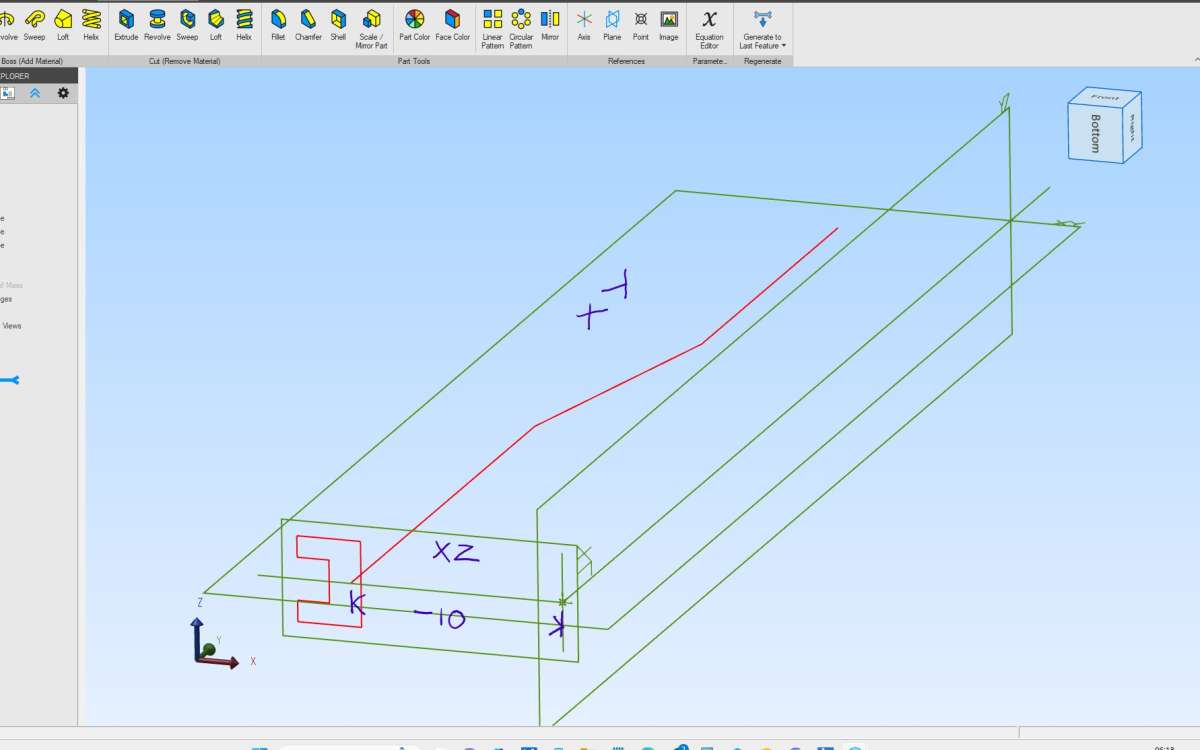

            IMG_0544
            #779486

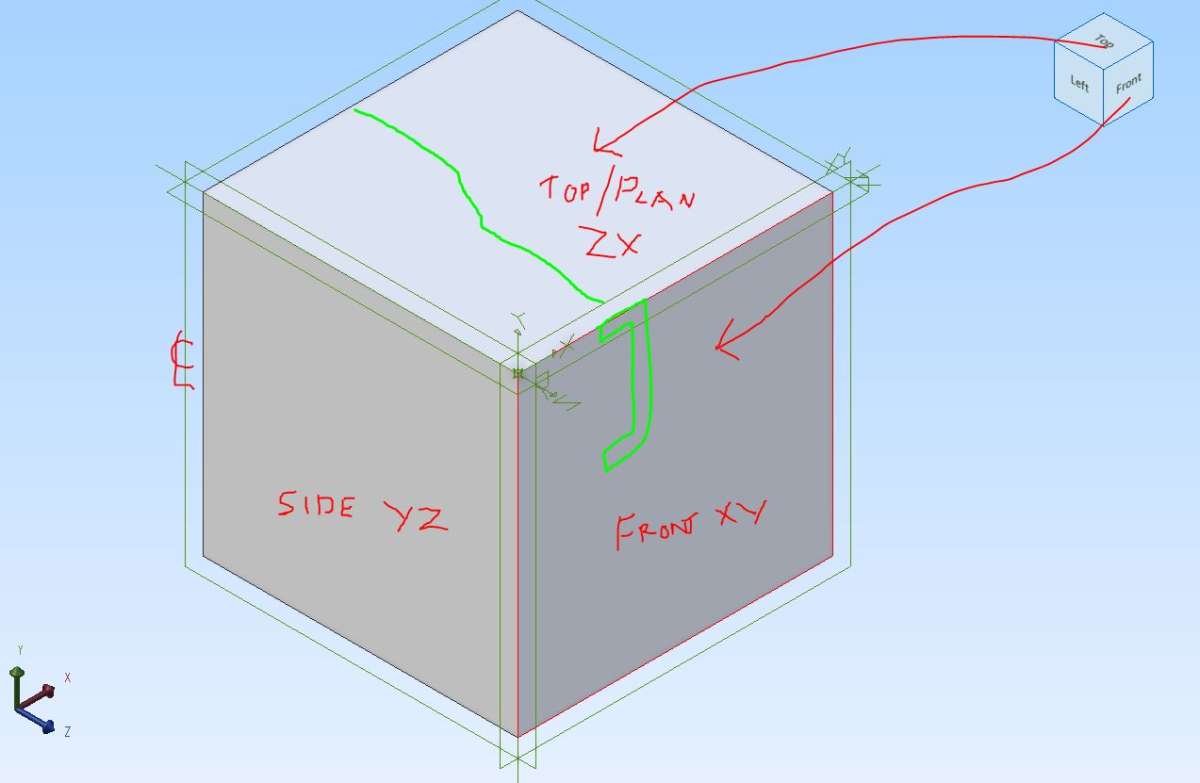

              As for what sketch goes where, Again I will suggest for you that looking at the cube in the corner should guide you.
              You will see the Z shape of the chassis when you look at the top of it so use the plane that is orientated the same as the top of the cube ZX
              You will see the C section of the chassis when you look at it from the front so use the plane that is orientated to the front of the cube XY to draw the chassis cross section.
              Nick suggests other planes but for your level of learning I have suggested these as the parts will be the “right way up” when files are opened, when they are inserted into an assembly or when you start a 2D drawing which will make things easier for you. It also corresponds to the names on the navigation cube which seems the obvious way Alibre intended it to be.
              what plane

                A basic strategy that works for me..
                I open a sketch in ‘XY Plane’ and draw out the path, starting the line at some easily remembered distance from the origin (here I made it -10).
                When satisfied with the Path detail and dimensions I deactivate the sketch. In my mind, this is the ‘Plan view’ of the path.
                Without doing anything else, I then click on ‘ZX Plane’ and activate another sketch – now I am looking ‘End-on’ along the path – I can’t see it, but I know the start-point lies -10 from the origin.
                I now construct the Profile Sketch so that my ‘Path start-point’ is either enclosed within, or touching/co-incident with, an edge of it.
                The sketch can now be deactivated and the sweep modelled.
                ..I suspect that there are more advanced ways of doing it..

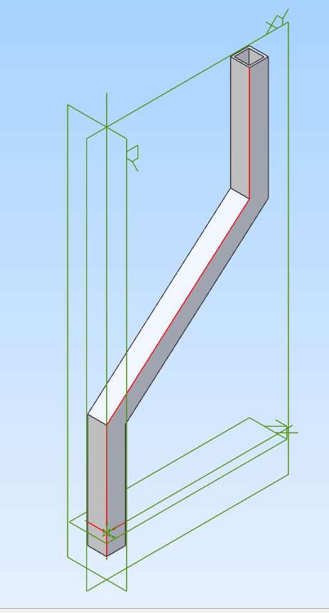

                  Like the model below, Nick?
                  I created it as you described though didn’t follow the lengths too closely as I have Alibre set to open in inches. I also looked at what happens if you edit the initial profile: the swept shape follows suit. I also tried it from the start as you suggested, as a pipe.
                  Alibre’s own manual is nothing like as you describe. It is in English not Chinese / English, but most such manuals are brief, sometimes more reminders for experienced users than introductory aids.
                  “Chinglish” is worst for power-tools, household appliances and gadgets and the like, manufactured in China; not IT apart from “smart”-‘phones… they come with no instructions anyway. Most software publicly available, including Alibre, is made in America so the supporting literature is written in English (well, the American dialect of it!).
                  Thankyou!

                      I realise that you didn’t feel inclined to watch the video end-to-end, Nigel
                      BUT please, please, please … just set aside three minutes to watch that chapter.
                      With the experience that you already have, it should be extremely easy viewing and [I can only hope] will bring enlightenment.
                      MOD EDIT this will take you to where Sweep starts

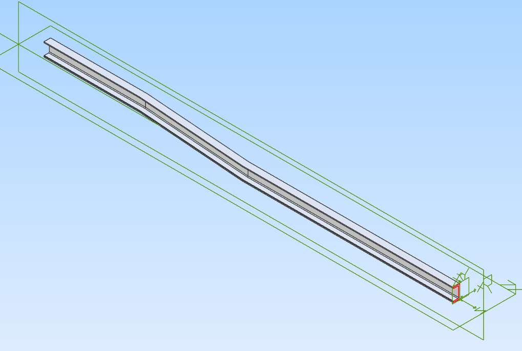

                        Got There!
                        By ‘eck what a struggle.
                        Thankyou all very much.
                        Jason – I copied your annotated View Cube to a desktop picture for ready reference.
                        I do wonder if a lot of the antics I was having with planes is that I am too used to thinking of (X, Y) being flat on the floor (or milling-machine table, where I prefer to use the names rather than algebra for the travels) and (*, Z) as the walls. It seems Alibre defaults to the screen being the “floor”.
                        Also with this tool there are times when you can see only one sketch at a time as its mate disappears into its plane viewed edge-on, and that’s a bit disconcerting.
                        I made one then tried to use the Mirror tool to create the second (as a separate Part file). I knew if I reflected just the sweep line the profile would face the wrong way, but confused myself and ended up losing the profile on the second model, so having to re-draw it, facing the right way. At least that showed the swept figure will follow changes to the original sketches, provided of course the editing does not ask for something not possible.

                          Yes, just like that.
                          Cool.
                          That leads onto a similar exercise for Mirror:
                          Start the Mirror operation
                          It will ask what you want to mirror and the plane to mirror it across.
                          What is the rail you just created, so select that in the appropriate box
                          The Plane is the one parallel to the sides of the rail, which is YZ in your fancy model. Select it from the browser list so you don’t accidentally pick something else and get a weird, hard to diagnose result.
                          Click OK, and you have a pair of handed rails. But they will be touching, which isn’t quite what’s wanted.
                          If you’re happy with modifying the Path sketch so the line is offset by half the chassis width from the axis it’s currently constrained to, do that. If not, start a new part and draw it like that.
                          Follow the same Sweep process, then the above Mirror. That will place the two rails so they look like the start of a chassis.

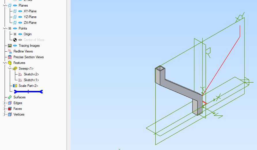

                            If you want the opposite handed part in a separate file from the original, the simplest option is;-
                            After saving the original part, Save As using a distinctive name.
                            Use the Scale/Mirror Part command to mirror the entire part (you have to select mirror plane from the choices provided).

                                We posted simultaneously, and it turns out you’re already well down the road I suggested.
                                You’ve probably got the ‘correct’ rails from an understandable process, and several odd looking combinations from experimenting.
                                If I was doing this demonstration in person, the next step would be how to split each rail into the three pieces that you would cut from real material. It’s easy to show, but time consuming to write.
                                That and the previous work would be a productive evening lesson.

                                  I took Nick’s previous example – which I interpreted as the angled length of square pipe shown above – saved it as a separate file and used the Scale/Mirror tool to produce its reflection.
                                  It puzzled me for a bit as the word “mirror” is not immediately obvious on the menu, but once I found it, here it is complete with the steps I used:
                                  I have used the ordinary mirror tool and know that allows you to place the original and reflection symmetrically a set distance about a central plane.

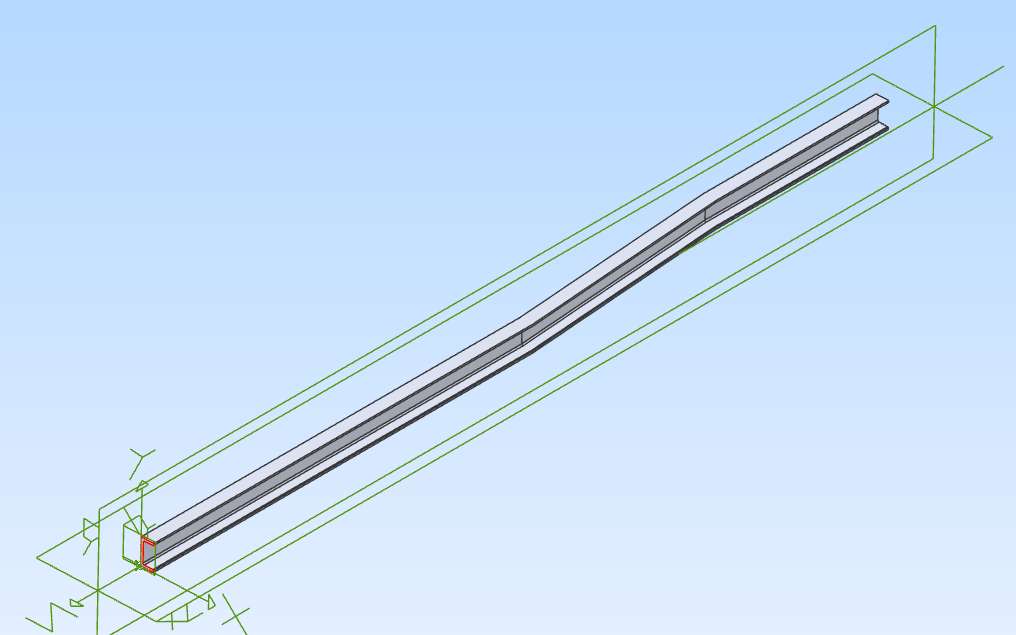

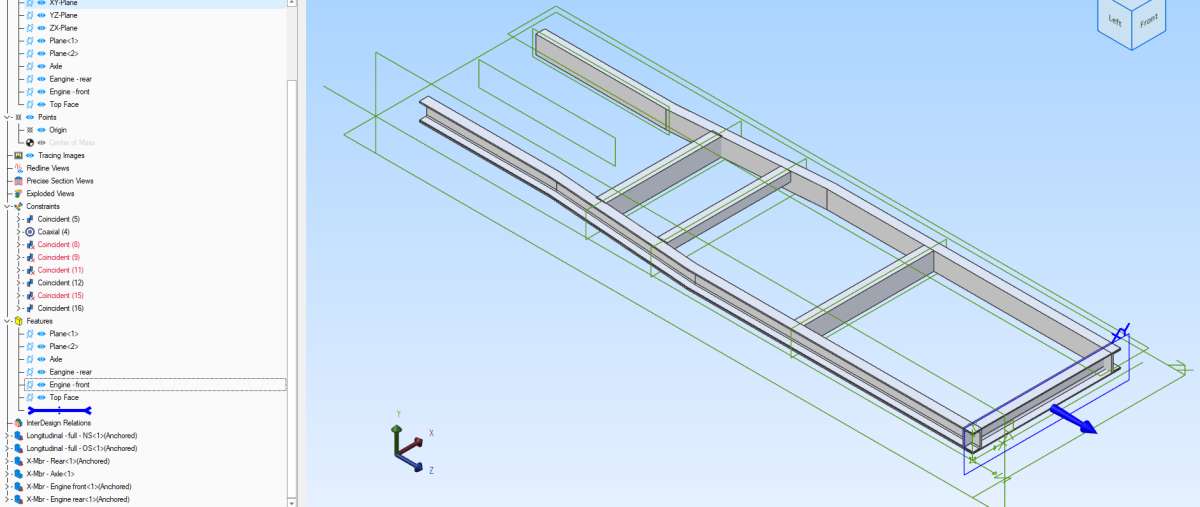

                                    I’ve just the last, ooh, probably two hours building up the full chassis.
                                    I found a use for that new-found “Scale/Mirror” tool: turning bits of channel the right way round. If they came floating gaily into the Assembly facing the wrong way I went back to their Part models and used that to flip them over. I don’t suppose that’s the tool’s “official” use – presumably you are expected to model everything pointing the right way in the first place.
                                    I had to spend a lot of time trying to sort out the lengths. The built frame is an awkward beast to measure within 1/4″ with any accuracy, and I think I mis-measured some bits. Then of course in the Assembly model the two cross-members on that tapered section were the very devil to “fit”, with some revising of the Part drawings to try to make somewhere right. It is their distances from the front ends that count, though.
                                    The curiously webbed appearance of the back end came from my thinking I’d placed the cross-member wrongly. It should go across the ends of the channels, where in fact I placed it first; but I could not put it right without risking ruining the whole thing. Luckily that error is unimportant. The only area of functional significance now is that wretched trapezoid so hard to measure and model accurately.  The rest is useful for Alibre practice and blood-pressure raising.
                                    Somehow the Design index shows a lot of faulty constraints and although I can highlight them by pointing to their list entries it doesn’t really help me determine what was wrong, or what would go to pieces if I delete them.
                                    Screenshot 2025-01-24 223043

                                      Instead of measuring the trapezoid, to tell the program how long to make the crossmember, use your increasing understanding of how CAD actually works by drawing the profile on your central plane and extrude to the inside edge of one rail. That’s probably in a menu attached to the distance box of the extrude command – Atom can’t be that different to Fusion. Using it saves the hassle already mentioned, and will form the end to the appropriate shape without any extra work from you. You don’t need to know the actual numbers until you’re about to cut real metal.
                                      It also means that if you have to change the chassis width for any reason, the crossmembers will also adjust. This is another reason for developing CAD thinking, which is the opposite of the traditional drawing approach which says you should never measure off a drawing.
                                      #779830
                                        That’s 2 hours well spent, as you’re very close to a respectable model. But don’t spoil the progress by thinking its anything other than a learning exercise. If you don’t find the cause of the errors, or ‘risk ruining it’ now, you’ll never learn to avoid them in the future. And that will be utterly soul destroying when working on something that matters.
                                        Don’t forget there’s an Undo command….

                                            And As I’ve said repeatedly – sort out or delete failed constraints immediately they occur.  At that time you know what you did most recently that triggered the constraint error.  If you leave it, errors will only accumulate.
                                            You’ll probably find that fixing/deleting the most recently added constraint will clear the errors on other constraints.
                                            Your chassis is an obvious example of where it’s possible to get a cyclic series of constraint references which are all mutually dependent and hence can’t resolve.   That may not be the reason for the errors in your case, but I’ve seen it many times in the past.   My default example for this is a simple picture frame – in real life you glue & pin all four corners, but in CAD you only constrain 3 – mathematically constraining the fourth corner is unnecessary (the other joints and all members are infinitely stiff).
                                            If you can’t sort out the assembly constraint errors – create a Package file from the assembly and send that to me – I’ll diagnose and advise what I find.

                                              Nigel Graham 2
                                                @nigelgraham2
                                                I don’t always see the faulty constraints immediately, by an error-message. Some seem to disguise themselves until further down the line I’m told the object is “over-constrained”, then the disguised ones in the list all blush bright red with embarrassment.
                                                So select each to let it highlight the broken area in the model, but still don’t know what I had done wrong.
                                                Jason –
                                                Oh, I can wave the object about as much as I like with the Shift key and mouse but it moves wildly (I have wobbly hands, which doesn’t help!) and some still refuse to face the right way.
                                                Nick –
                                                [Undo] will only work up to a point, although Alibre gives it an unusual ability to step back many times, but it’s best to use it immediately. If the fault is something built in a long time back and not showing then, Undo might Undo a lot you don’t want Undone – and it’s still not necessarily obvious what you did wrong. Nor how to put it right.
                                                The major dimensions of the frame are correct as far as I could determine but the real thing is very hard to measure accurately. The two awkward cross-members are the most difficult and it never occurred to me they could be generated in place. I think Alibre does allow extruding to another part, but I’ve not used that.

                                                    Over constrained will turn all involved constraints red.  The one added last (at the bottom of the list) is likely to be the one that triggered the error. Try suppressing that to see if errors clear.

                                                    Nigel Graham 2
                                                      @nigelgraham2
                                                      Tried to correct that frame as shown above – I had to delete the misplaced part and replace it, but I think I damaged the rest of the thing in the process!
