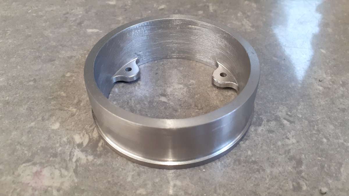

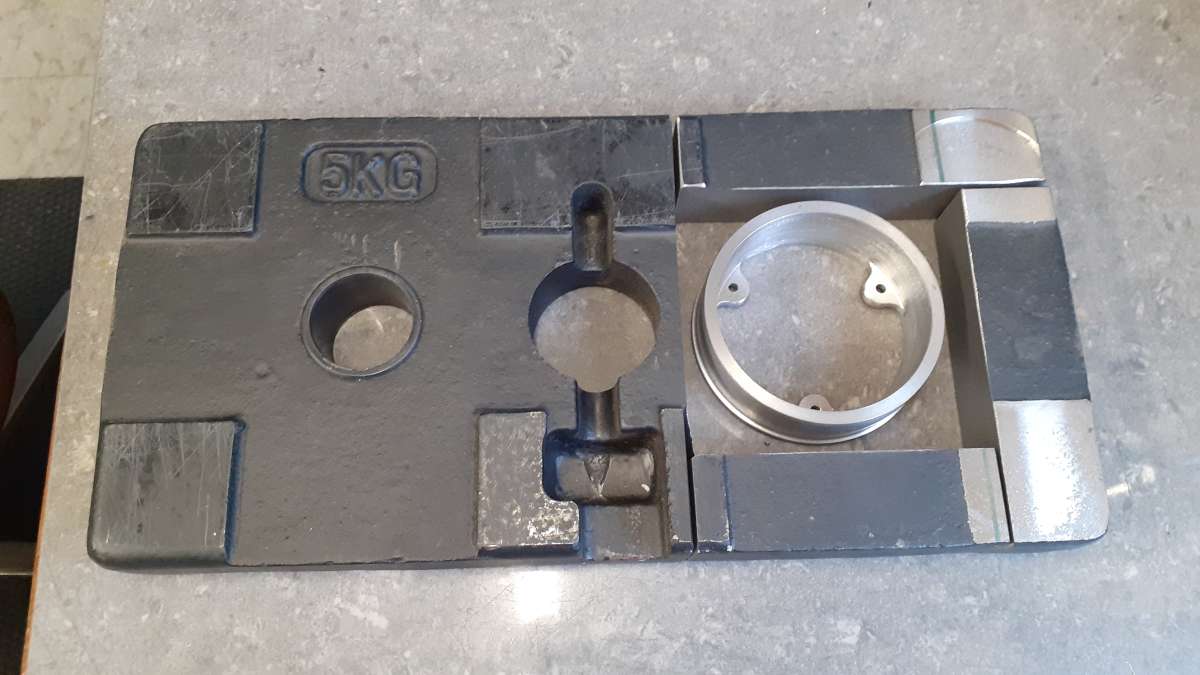

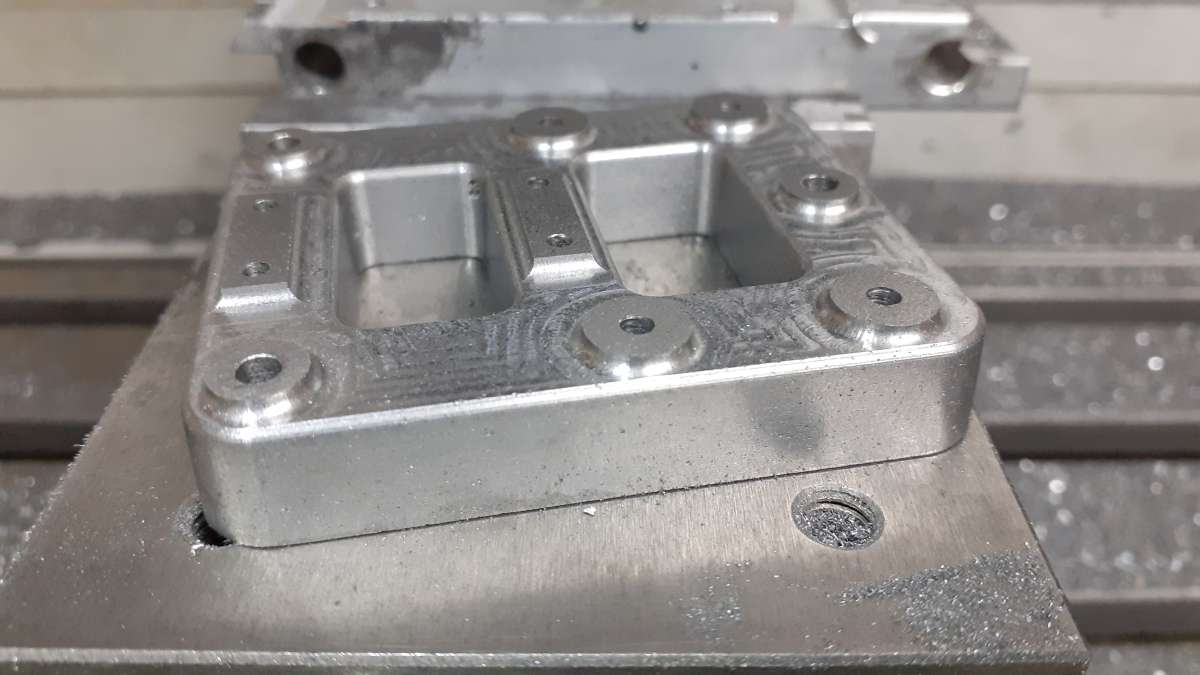

          #751192
            A while ago I got several weights from a Yokk Multi-gym and have used them for various non-critical items such as engine bases, valve cheats and a flywheel pully. The iron is a bit grainy but otherwise machines OK with carbide tools.
            Probably not the best if your engines will be doing 10k rpm but for a hit & Miss or steam engine running just for display shoild be OK You may need to bond in a hub as the round weights usually have quite a large hole.

            #751234
            Mick Bailey
              @mickbailey28509
              Those parts look to have machined quite nicely. Not bad at all and I’d be pleased with that kind of result. I’ll try a facing cut across a sample weight and take a look. The size of the hole may be the deciding factor even if my weights are OK, as even with a pressed/bonded centre it may look wrong. I’m intending to use them for a part-completed vacuum engine that I want to complete, but as a Loyal cycle engine. Perhaps 400 to 700 RPM or thereabouts. Or slower if possible.
