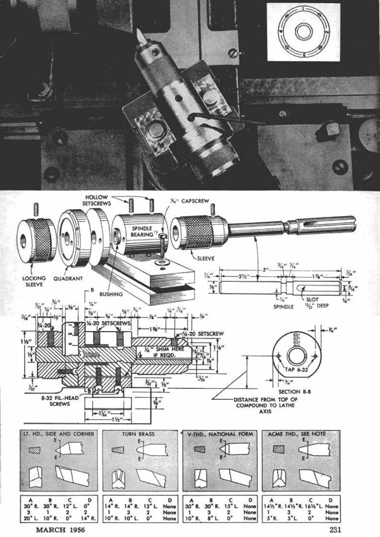

                                                  #426273
                                                  Paul Lousick
                                                    @paullousick59116
                                                    I recently found this article in a 1956 edition of Popular Mechanics magazine for a basic tool cutter grinding holder, used for sharpening tools on the lathe and written by Rodney B Wyatt.
                                                    Neil, any relation ?
                                                    Paul

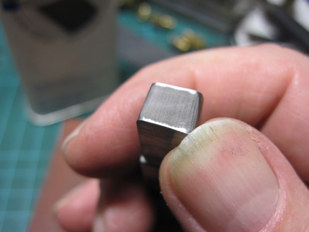

                                                    #426314
                                                    IanT
                                                      @iant
                                                      Just to add a few thoughts on "honing" (entirely my own views).
                                                      A good deal of time I don't hone my HSS/Carbon tooling because I'm working larger pieces or don't need any special finish. I'll just touch up a HSS tool on the grinder but it's useful to be able to use roughly repeatable settings, so some aid/guide in grinding is essential and for some tools I'll make a scratch mark to show where the tool 'sat' in the jig/fixture previously (when using the Diamond jig for instance).
                                                      Where honing is important is when you need a very sharp tool – for very small work, a very fine cut or awkward work needing a tool extension (a sharp tool helps reduce chatter). For some time now I've tried to always use the front of the wheel on my 6" grinder and this will give a small curve to the grind. This can be exaggerated by slightly lifting the tool above the grinders centre height. This curve does two things, it gives a small clearance but also creates two edges (top & bottom) that can be honed much easier than a flat surface.
                                                      I always hone with the tool out of the tool holder and although I do sometimes use a small stone to 'touch-up' the tool in-situ, I don't really think of this as "honing".
                                                      It's a very simple thing to do once you get the general idea and does give a very sharp edge. A tool can also be re-honed several times but (in my view) the tool must be removed from the holder to do this properly. I've dug out a photo I thought I'd posted before (but it wasn't in my Albums – so maybe not). It's a shaper tool I probably honed for cast iron but you can clearly see the (bright) honed cutting edge (the bottom edge just helps to level the tool when honing). The 'dull' face between the bright parts has in fact been ground and you can see the grinding marks in this face – the honing smooths this and gives a very good edge. This approach works for just about any cutting tool.
                                                      For context, I work on mainly on smaller stuff and others may have very different needs and experiences. I do use insert tooling but not for my general work. Maybe it's a matter of personal preference – a bit like Marmite.
                                                      Regards, IanT
                                                      Honed Edge
