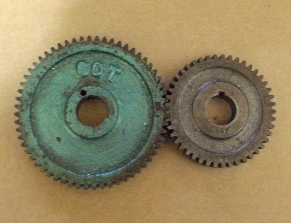

          Does any body know if I could use Myford gears to get the screw cutting set up as I only have what seems to be the minimum set up at the gear end.

            As for the gears i dont know as mine came with a set.. you could get in touch with tony from lathes.co maybe he could say
            Now you got me thinking about myford gears and wondering
            Edit… maybe one of the myford boys might be able to tell us

              Hi Dave George 1,
              The Grayson change gears and the Myford ones are interchangeable, again seems Myford copied the Grayson design.
              The only difference is the Myford ML7 ones have a keyway in the bore whereas the Grayson ones do not. They instead have one or sometimes two dowel holes in the boss. This takes a dowel pin to couple two gears together for compounding.  One both types the bore is 5/8-inch. They are are both 20DP and similar thickness, the Grayson ones being a tad thicker. Nominally 1mm thick against the 9.5mm for a ML7 but not an issue.
              In the picture the Grayson gear is on the left and the Myford on the right.

                That's great I should be able to purchase a selection of gears from the well known auction site. All I need to do is figure out a gear stud that's suitable for both myford and Grayson gears. Thanks for the info John

                  The Grayson gears are nominally 11mm thick, probably 7/16-inch, I see I typed 1mm in my earlier post. Finger trouble on a cold day!

                    Posted by Michael Taylor 8 on 11/06/2016 22:22:24:
                    MIight be easiest to convert those Grayson pin holes into keyways by slotting them in the lathe once you get it together. Easily done in the lathe using a boring bar with the toolbit ground to size and turned sideways, they use the carriage feed to to gradually open out the slot. Then you can use standard Myfrod gear studs.

                      Thanks Hopper I hadn't thought of that. I was considering putting pin hoes in the myford gears to lock them together but was wondering the feasibility of that.

                        Even easier – if you have the correct drive for the Grayson gears – is to drill a hole in the Myford gears to accept the Grayson pins. From the lathes.co.uk website early Myford gears (ML1 &2 era) used pin drive rather than a key anyway.
