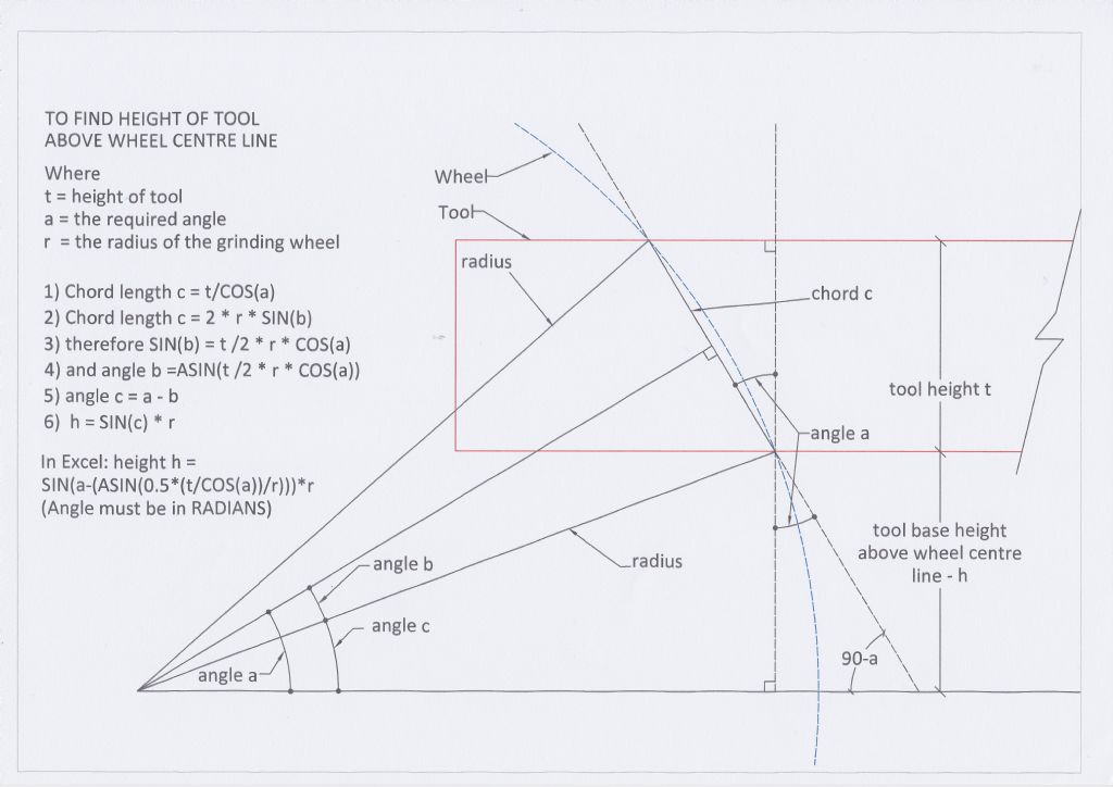

      I liked the concept of this grinding rest and decided to make one, albeit with some modifications, but when drawing up the parts needed I got a bit confused! The fundamental concept is that with the tool to be ground set at the correct height relative to the wheel centre, the curvarure o the wheel would automatically give a standard 8 degree angle. To achieve this, according to the article (page 654) the TOP of the tool needs to be set 14mm above the centre line of the wheel, but, unless I’m missing something, the design does not make allowance for different HSS tool sizes. Obviously, smaller sections could be packed up, but this affects the practicality of the design and possibly the accuracy. Any ideas?

                Bazyl, thanks for the reply. The height required is a function of the tool size. I mainly use 5/16" tools and to check the height required to give 8 degrees, I drew it in autoCAD with the 5/16" tool intersecting a 150mm diameter circle with the chord joining the intersecting points at exactly 8 degrees to vertical. The height required for 5/16" is 14.4mm. For 3/16" it is 12.8mm, 1/4" – 13.6, 3/8" – 15.2 and 1/2" – 16.7. So if you set the height correctly for the smallest tool size you use you can get the exact 8 degrees that Graham recommends and then using 1/16" packings you will get the same for each size. The hollowness is pretty insignificant, 0.11mm for the 5/16" tool, 0.275 for 1/2", and, as you say the big advantage of the design is accurate repeatability.

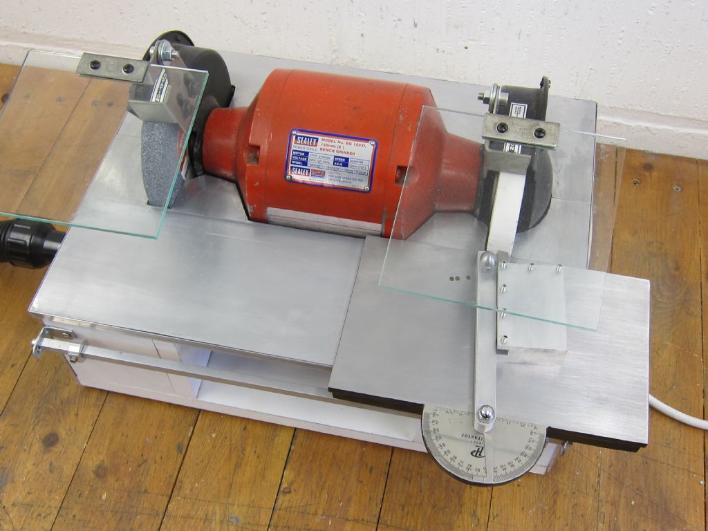

                      Bazyle, I meant to thank you for the invitation to your club meeting on Friday, unfortunalely it would involve me in a 500 mile round trip! The modifications I’m thinking of involve the tool holding method and partially enclosing the grinder with an extract aperture to reduce the amount of dust flying around my small workshop area.

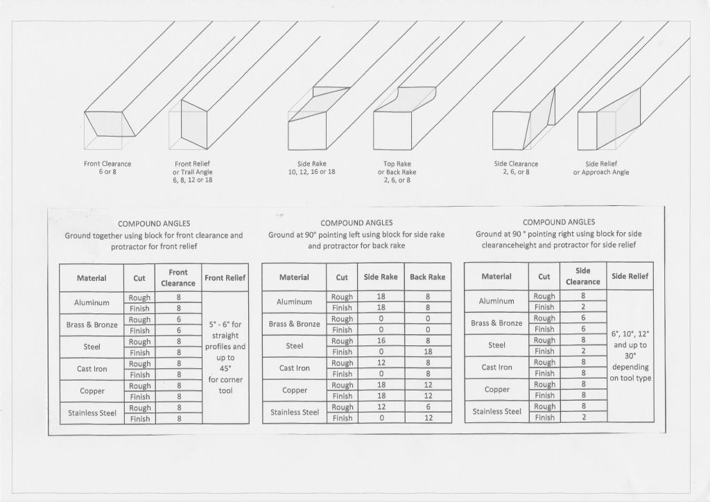

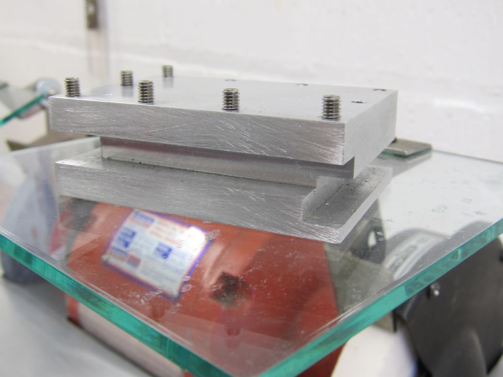

                          I have completed my version of the tool grinding rest. The wheels are partly enclosed and the casing has extraction holes which work well in reducing the dust spread. The casing top and sliding part are made from plywood bonded to 0.5mm steel sheet (from B&Q!), the protractor is a cheap one from eBay and there are holes at commonly used angles with a tapered pin to lock the arm, this makes for easy repeatability. If you vary from Graham Sadler's design you need to re-calculate the tool height relative to the wheel centre line, the geometry is shown on the drawing image and if you use Microsoft Excel the expression for the height of the bottom of the tool above wheel centre is: SIN(a-(ASIN(0.5*(t/COS(a))/r)))*r where a is angle required, t is the height of your tool and r the radius of the wheel. I also prepared a sheet which simplifies the various types of angles on the tool. Finally I made tool holders to give front clearance angles of 2°, 6° and 8°, these are simply machined from aluminium and have slots at 90° for grinding side rakes etc. Photos and drawings attached.
