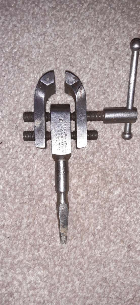

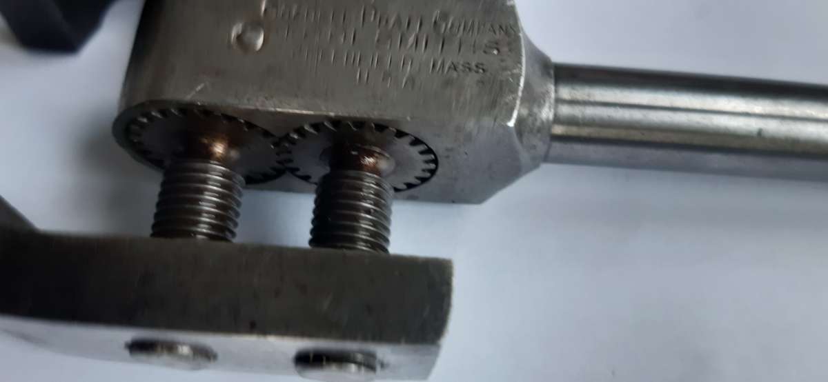

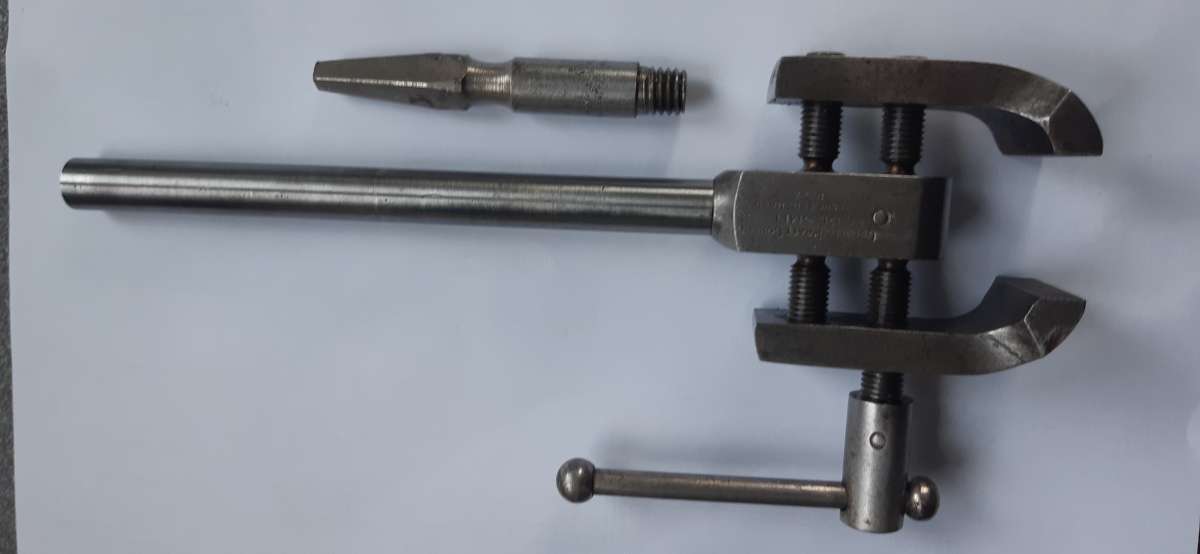

      20251101_20001120251107_15214520251107_152132I I bought this vice at the Lomax show for the bargain price of £2. It has the unusual gearing and left and right hand threads to maintain parallel jaws which I have not seen before. I have changed the original tapered square drive for the 1/2″ dia shaft to use in a Hemmingway instrument vice. The question I have is why did it have the square taper which looks similar to the old brace and bit drills. I cannot think where you would use it in a brace like that or have I got it completely wrong.

      cedric 1
        @cedric
        No idea about the square shank, but the double geared screw mechanism is certainly wondrous to behold. You have to love old tools like that. A very nice find, indeed.

          Dave Halford
            @davehalford22513
            Some mini anvils  have a square hole, so a stake vice perhaps?

                          Graham Butcher
                            @grahambutcher80356
                            Thank you for all the replies.
                            Not sure of a definite answer. Now that I have fitted a plain shaft to the vice I can always put it in the drill if needed!
