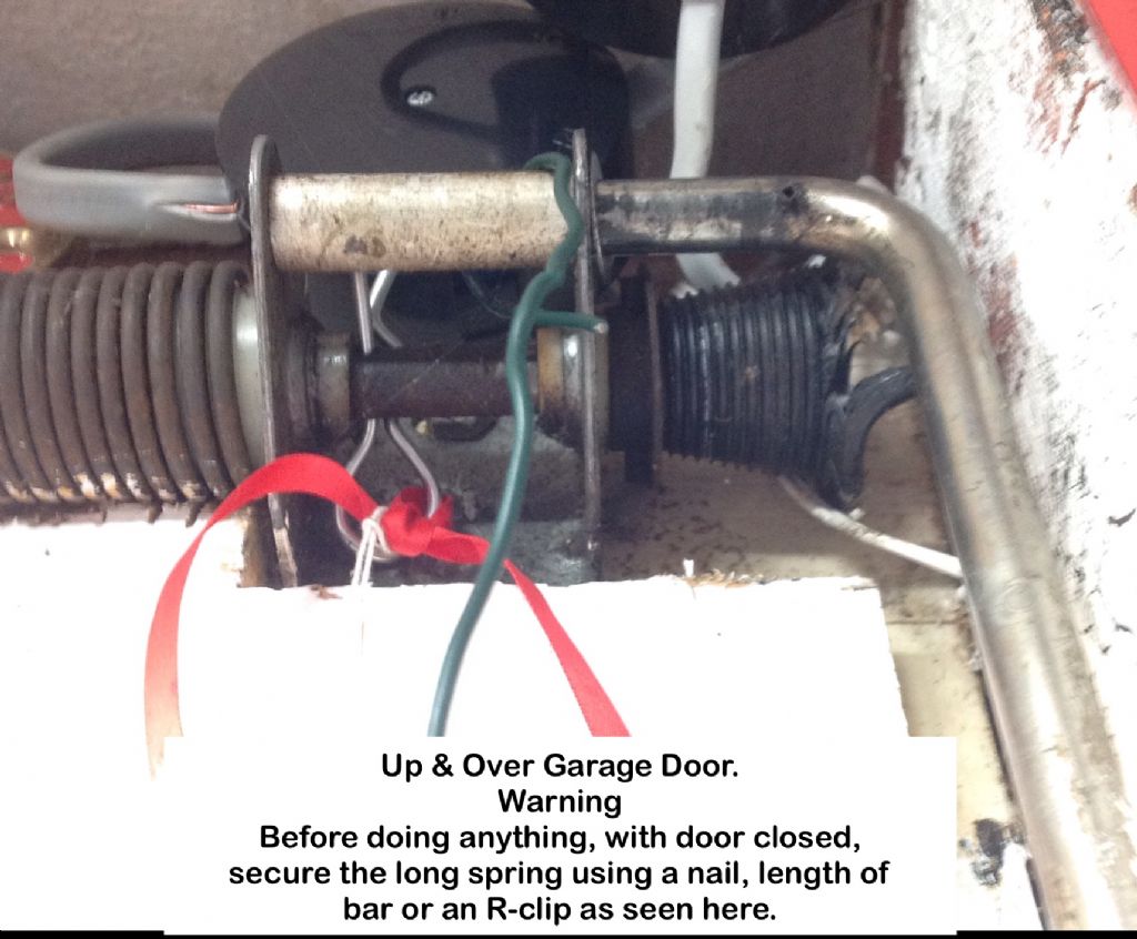

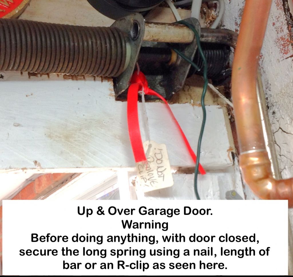

                                          Morty,
                                          I converted my Up & Over into a side hinged door, and released all the space it needed to swing up.
                                          ‼️WARNING‼️
                                          If you are going to remove it, PLEASE secure that long spring, using either a nail or R-clip as seen in my photos.
                                          That Spring has an enormous amount of stored energy, and it's sudden release led to it breaking free and causing the tragic death of a man, when the slider arms where disconnected, he having failed to lock the spring beforehand.
                                          When I mentioned what I was about to do to a counter hand at my local Jewsons outlet, he crooked his finger at me to follow him round to the back of the building, where a complete spring assembly had been dumped, and proceeded to show me how and where to lock the spring.
                                          All I can say is fortune smiled on me that day, as even now I have no idea what I would have done, research hopefully before touching that mechanism!
                                          Up&Over Garage Door
                                          Up&Over Garage Door
                                          Geoff – I sliced one end off to make a std width door, the rest kept closed, both insulated.
