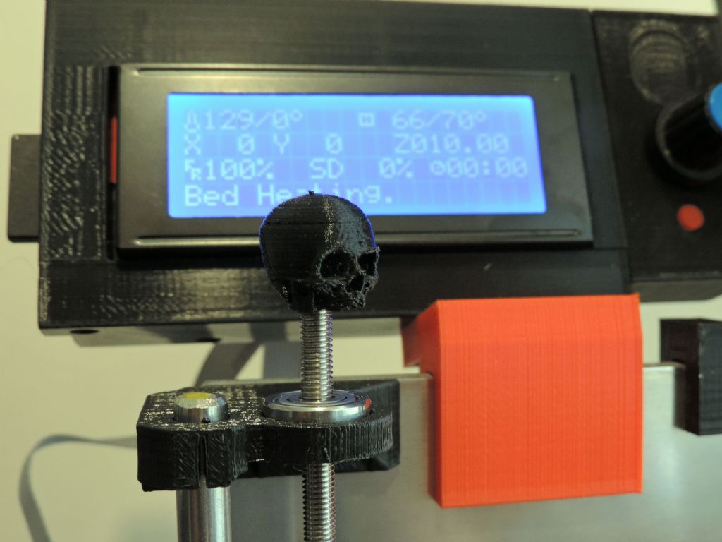

        I have an odd problem with using Autodesk Print Studio. It uses a completely different approach to supports to Cura, and also allows you to easily slice bits of badly designed parts and print them as multiple items for gluing together.
        The problem is that when it starts a print it goes down on the z-axis flat out, and can stall the steppers (perhaps I need to up the current a bit?) There's no dedicated setting for z-speed, so I can't slow it down without slowing down the whole print process.
        When this happens the two Z-axis steppers can get slightly out of synch, upsetting the carefully done bed levelling.
        So, I thought, I'll stick a little pointer on top of each z-axis screw so I can easily see if the two steppers are, ahem, in step.
        Then I had a better idea, grabbed an STL of thingiverse, added a 5mm hole in Turbocad and…
        Hopefully, by their vigilance at all points of the compass they will also keep the three evil spirits of poor bed adhesion, combing and filament stripping at bay!

            It's been done, but to be honest the skulls have now shown me that the two steppers DON'T get out of step when they stall.
            Also, the skulls are much more fun
            I wish I could find a setting to stop this as it affects about 1 in 3 print runs, but never happens with Cura. At leats it always happens in the first few seconds, not 8 hours in!
