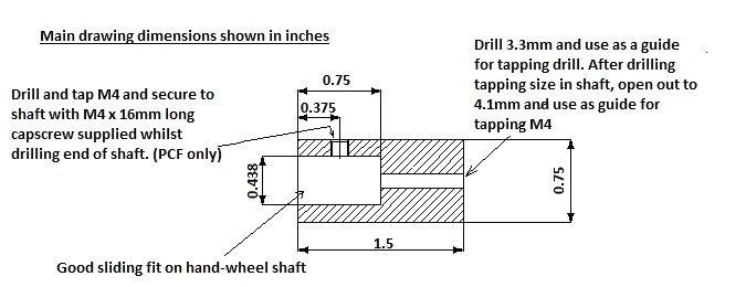

                      OK, so I had a proper look last night and you are all correct in that the back plate is counterbored for the oil level screw to be a direct fit.
                      However the pinion shaft needs a 4mm tapped hole down the end to take the retaining screw. So two options. Strip the apron which as I have just got the lathe I am (probably illogically) reluctant to do or turn up a sleeve with a cross drilled and tapped hole to fit the shaft with a tapping size hole up the end to act as a drill guide and do it in situ with a hand drill. The shaft would be prevented from being pushed back into the apron by the sleeve and its grubscrew and locking the saddle will prevent rotation.
                      I will have a go tonight.
                      regards Martin

                          No need to dismantle the apron.
                          Make a drill bush with an 3.3mm though hole and a concentric blind hole that is a nice fit on the pinion shaft – No need to make any form of locking provision.
                          Lock the saddle to the bed to prevent the pinion turning then make a short piece of wood to fit tightly between the end of the pinion and the lathe bed just below to rack to prevent the pinion moving back.
                          Drill the 3.3mm end hole with a normal battery drill tap the hole and the job is a "good un".
                          Hope this is of help.

                              The reason I think I need to lock the bush onto the shaft is you can't get to to the rear of the pinion as it's a power cross feed lathe. If you push the pinion inwards you end up shoving the plastic plug out of the casting. I could as you suggest wedge the plug with a bit of wood but if I fit a grub screw the shaft will be retained in the same manner as when the traversing wheel is in place. I could just do it all by eye before I take the wheel off. The shaft has a centre in it so it's only the axial truth that needs care but to my mind that lacks finesse.

                                    Below is a copy of the drawing of the jig that I recommend when drilling the original shaft. This drawing is included as part of the fitting instructions that I supply with the dial. You pretty much have the same idea. I will also include a paragraph from the same instructions:-
                                    "Whilst the majority of Power cross feed machines will be able to utilise the apron oil level screw to anchor the back-plate to the front of the apron, some of the later machines have the oil level screw positioned to the left of the earlier placement. In such cases, the dial should be fitted as per the non-PCF versions. It should be noted that there may be an issue with the wall thickness of the front of the apron casting and therefore it may be necessary to drill the tapping size for the M4 thread to a depth of only 8mm. This will prevent breaking through into the cavity and subsequent contamination of the oil. In this instance, it will be necessary to slightly shorten the 16mm long M4 cap-screw so that it grips the back-plate before becoming thread-bound at the bottom of the hole."
                                    Hope this helps,
                                    Best regards,

                                      Thanks for that Steve. That's exactly what I came up with. Do I assume I bought the thing from you. I really have no idea except it was purchased at Harrogate one year. I don't have the fitting instructions any more but I may have subliminally remembered the bush. I'm pretty sure I drilled and tapped my last pinion shaft in the lathe. As I wrote previously the back plate is already good to go on the oil filler tapped hole. It's a Myford reconditioned lathe so I'm not sure how much they have re-manufactured. I'm pretty certain that they made a new tail-stock base. Difficult to see how they could have maintained the centre hight without doing so. The apron may also be new stock too.
