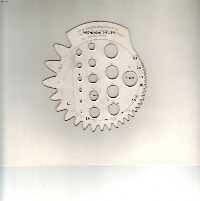

              I think it was Davall Gears that used to give out a free plastic disc about 3" dia with a wide range of teeth moulded on the circumference, whether they still do I don't know, and I don't know what happened to mine.

                                Sandgrounder is right about Davall Gears give away gear size disc, I have scanned mine and put a couple of hole dimensions in to enable the correct sizing, it is only for MOD gears 0.5 to 6.0
                                Emgee

                                    Thanks Emgee! I'll print that out. I don't need a Mod size gauge yet but I just might.
