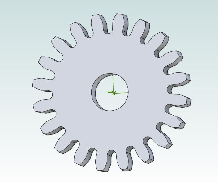

            I suppose if you can draw out a 1.91 MOD gear in CAD then all you need is to find someone who can print, laser, water jet or CNC them.
            This is a 20T 1.91MOD, 14.5pa with a rounded root to make milling easier.
            Edited By JasonB on 23/07/2019 20:43:28
            Edited By JasonB on 23/07/2019 20:47:08

                taking it one step further you could do a helical extrude of the profile and print that.
                Or if going the CNC route then mount the blank at an angle then index it round cutting one tooth gap at a time assuming you don't have 4th axis and all day to do the helix for you. That's if a helix is really needed.
                Edited By JasonB on 23/07/2019 20:53:25

                              Could you amend your 3D model to the correct pressure angle? Think about it: is any module gear in the world likely to have a 14.5 degree PA?
                              The 14.5 degree PA corresponds with the 29 degree thread angle of imperial ACME. Metric trapezoidal has 30 degree thread angle, which would be 15 degree PA (I wrongly stated that it would be 30 degrees in a post above but cannot find any way to correct my error).
                              #420966
                                I based my sketch on Andrews suggestion as it seemed the 14.5 pa would give a longert thinner gear which looks more like the actual Harrison ones than your 30degree pa (not 20) suggested angles being far closer to 15deg.
                                As it is actually a 6mm CP gear we could just as easily say it can be cut to 13.299DP in which case 14.5pa would have been quite common at one time. Infact a 14DP, 14.5PA gear may be a better option than a 2MOD, 20pa one if substituting nearest standard gears, only 0.01MOD further out on size from 6mm CP but a lot closer on pa.
                                I've deleted the file now but happy for you to post a corrected one.
