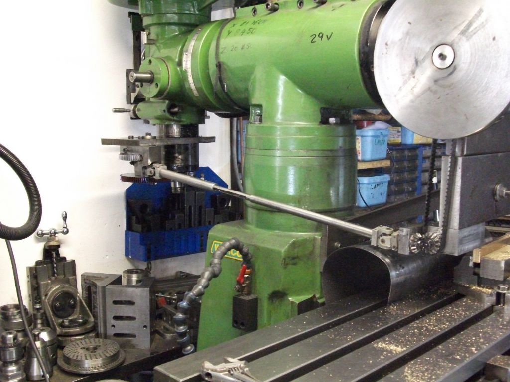

                    Here is a 20 dp rack cut on my Warco mill ,as is usual with these sort of jobs there is some parts that need to be made to enable this to be done .As the machine is part cnc the spacing and driving the cutter through is done with a small cut file ,the cutter depth is set on the knee.The rack has about 160 teeth and is about 25 inches long.

                            Whilst in theory – I could turn the vertical head on my Victoria horizontal through 90 degrees to cut a long rack – in practice I wouldn't have enough clearance to use gear cutters held directly in it's spindle. I'd need some kind of secondary spindle, as John has produced for his Warco vertical mill. Not sure how I'd do that on mine however (at least simply) – interesting problem though…
                            BTW – always like a photo or two to make things clearer. Can you show us the other side of your set-up please John?

                              Hi Ian, The first photo shows the drive to the spindle ,as you can see the head is swung around by 180 deg and the drive gear is mounted to the main spindle.A reduction gear arrangement is clamped around the quill ,this originally was going to form part of the mechanism for a mechanical gear hobbing unit on the mill but was abandoned in favor of an electronic hobbing unit made by Richard Bartlett (Compucut).The keyed driveshaft transmits to the spindle via the bevel gears .The hardened spindle runs in bronze bushes in the spindle housing,the cutter is home made as in the book Gears an gear cutting by Ivan Law and at 1 1/2 inch diameter protrudes just enough below the edge of the spindle block to clear.The spindle block as can be seen in the earlier photo is held on the rear of the head column ,a diagonal brace connects to the main column and provides considerable support  to  the mounting.
                              The second photo shows a close up view of a shorter 20 DP rack.The vice provides the main support ,the two blocks either side are secured to the table with T nuts and milled level in situ to provide the support either side of the vice jaws.

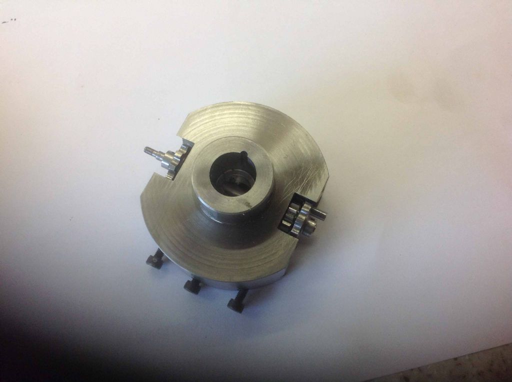

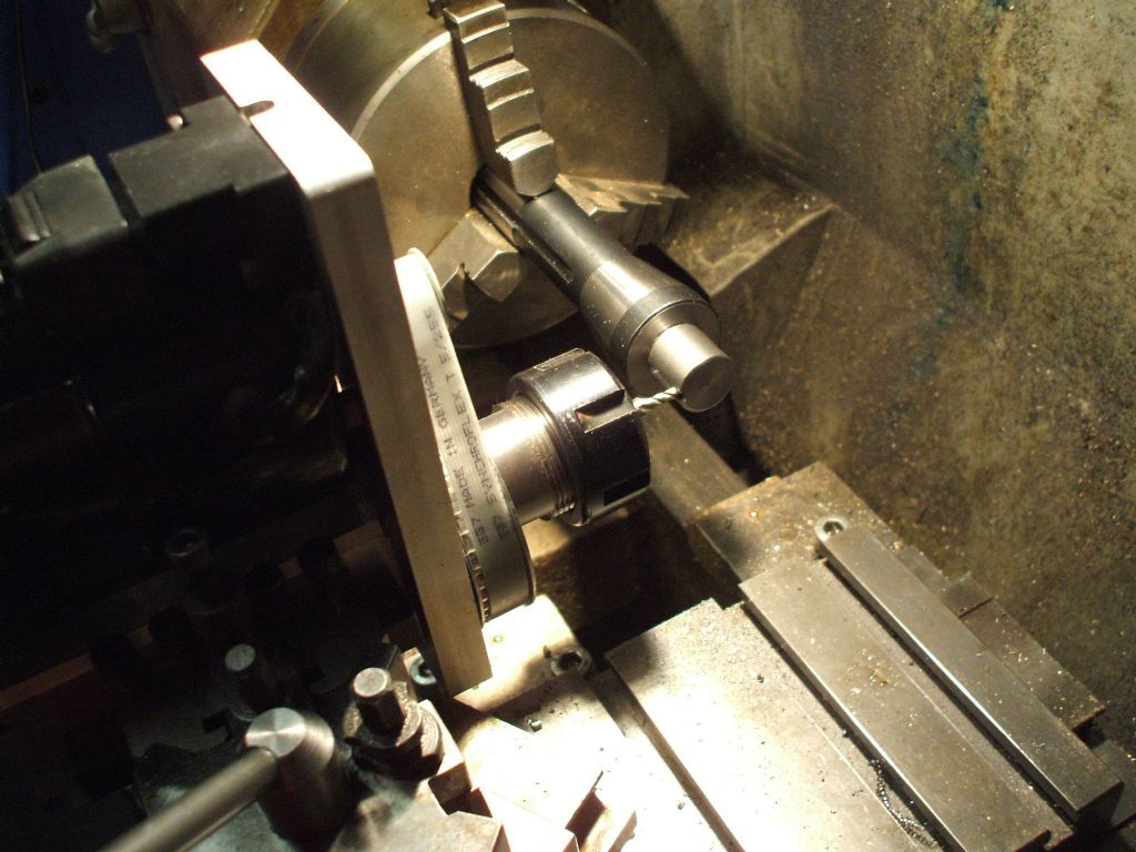

                                Like Ketterinboy, I used a similar method to locate the R8 arbor to the top of the boring/facing head that I made, as I don't possess a broaching kit. Slightly differently, though, I used a piece of silver steel rod instead of a "normal" square key to provide a positive drive, cutting a semi-circular groove in the arbor with a ball-end milling cutter and a matching one in the boring head body. The short length of silver steel fits snugly in both parts and the grooves can be seen ( just ) in the pictures below.
