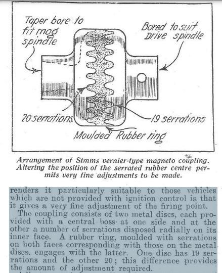

      The prime purpose of buying it, is I wanted to make Simms vernier couplings for the magneto drive on my Austin Seven projects and this is where I would. appreciate some help. I'd like to do other work in the future.
      As I understand it, one buys sets of gear cutters each one of which is suitable for a gear with a specific range of teeth. Say, for the sake of the argument, any number between 36 and 48. The next cutter would then take you from 49 teeth to 60 and so on.
      But how do you establlsh the angle between the teeth? I think I'm talking about diametrical pitch (?). There seems to be a value in degrees on the cutters – for example 20°. Is that it?
      So would the way forward, along the 'Simms road', be to count the teeth on the gear (19) measure the angle between them (?) and choose a cutter that includes 19 in its range and is of the appropriate angle?

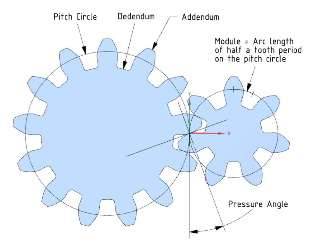

          The diametral pitch (DP) determines how fine or coarse the teeth will be. (Number of teeth on the gear plus two) divided by the diameter in inches equals the DP.
          THE angle denoted on the gear cutters basically refers to the shape of the teeth on any gear of that pressure angle (PA). Most plder gears were 14 1/2 and later (more modern) ones 20 degrees.
          The cutters generally come in a set of eight ranging from the smallest tooth count to a rack (infinite diameter🙂 ). You will need number three of the set of eight for a 19 tooth gear (I think).

              The angle stated on the cutter is the tooth pressure angle and is more often than not either 20° or 14½°.
              You will need to work out the cutter required from the finished diameter of your coupling and the number of teeth required on it, so it will be the DP (Diametral Pitch) number if using imperial cutters, or the M (Module) if if using metric.

                  My understanding of the construction of the Simms Vernier Coupling is that it comprises of two serrated flanges, with a one serration difference, and a moulded hard rubber disc fitted between them. I assume that the rubber disc is to allow for slight misalignment between the two shafts, it may also cushion the drive depending on the hardness of the rubber. As has been stated, the serrations look similar to the teeth of a knuckle gear and seem to be cast rather than machined.
                  While machining the metal flanges and serrations, once the shape needed has been determined, would be reasonably straight forward, I think that you will still need to use a moulded rubber centre section to complete the coupling. Using metal for the centre section would result in fretting between the parts as there will be no way of lubricating them.
                  The link given by Phil P shows all the parts of the coupling, including the rubber disc. You may wish to purchase the rubber disc to get the profile you need. Remember, you could spend a lot of time making a part from scratch when you could purchase parts which only need the bore machining.

                    Simms couplings are coaxial couplings which take into account a 'slight' misalignment of the two components and also act as a torsional damper for intermittent loading, especially where an intermediate rubber 'sandwich filling' is used. The tooth profiles of these face couplings is not generally of an involute form – more akin to a spline form. The trick in the vernier coupling is the dissimilarity between the numbers of teeth which allows a finite adjustment between the two components to dial in a precise timing. This is achieved by the 'sandwich filling' having differential teeth. It is a more complex arrangement to an Oldham coupling.
                    For using the dividing head you will need to know the turn ratio and then look for a suitable plate. For instance a 40 turn ratio with a 21 hole plate gives 21 x 40 =840 then say divide by the number of teeth required, say 20 then 840/20 = 42 so you need to advance the plate by 42 holes = 2 turns exact. say you need 28 teeth spacing then 840/28 = 30 so you need to advance the plate by 30 holes, which equals 1 turn and (30 – 21 = 19) 19 holes.

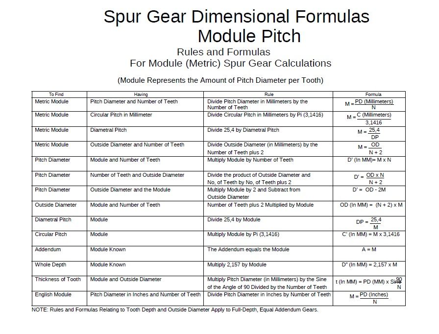

                          The way I've read this thread – rightly or wrongly – is that there's a little confusion on the OP's part regarding the exprsssions Diametral Pitch and Module. Here's my 4d-worth of chips ( without salt or vinegar ).
                          I find this chart useful:
                          Gear formulae
                          Note it specifically references spur gears, so whether it can be applied to the gears being sought here, I would caution against, their tooth form being anything but spur gear-like.
                          But I find it a useful aide memoire when cutting gears.

                              Looking at the pictures provided by Phil's Vintage Car's link, I see the Simms Coupler is made like a Contrate gear, ie the teeth are at a right angle to the face, not around the edge.
                              Oily Rag explained how Simms Coupler's are adjusted, and here's words and music from 1922! Note the description refers to 'serrations', not gear teeth.

                                                      No one seems to have answered the question, obviously in the OP's mind, about the difference between DP and Module.
                                                      Effectively, they are the same, other than the units used in the calculation..
                                                      DP is for Imperial dimensioned gears. Module is for Metric dimensioned gears.
                                                      A 20 DP gear with 20T will have an OD of 1.100 inches. OD = (Tooth Count +2 ) / DP (20+2 ) / 20 = 1.100
                                                      A Module 1 gear with 20T will have an OD of 22 mm, purely by using mm instead of inches as the unit of measurement in the formula.
                                                      This formula, and many others are in Ivan law's book, "Gears and Gear Cutting", No 17 in the Workshop Practice series.

                                                      Each set should allow you cut gears from 12T to a rack;. No.1 will cut from 135T to a rack, while a No 8 will cut 12T anf 13T only.
                                                      The depth of cut (Usually marked on the gear. as Df ) will be the same for all the gears of a particular DP or Module, but will differ as the DP or Module changes. (2.16 mm for a Module 1, but increasing to 8.63 mm for a Module 4 gear, or 0.0108 inch for 20 DP gear to 0.360 inch for a 6 DP gear )
                                                      to find and compare pictures of 6DP gears, likely to be used on Traction Engines, with the 20DP changegears on a Myford ML7. It will be obvious that they are different. ) Similarly compare a 0.8 Module gear with a 2.5 Module gear
                                                      You should not mesh gears with different pressure angles, such as a 20 degree PA with one with 14.5 degrees .
                                                      The tooth form is slightly different
                                                      In the absence, (Not the case apparently ) of proper Simms couplings of the correct size, I advocated using gear cutters, across the face of the couplings, rather than the OD, to produce what Meccano called "Contrate" gears, as already mentioned..
                                                      HTH
