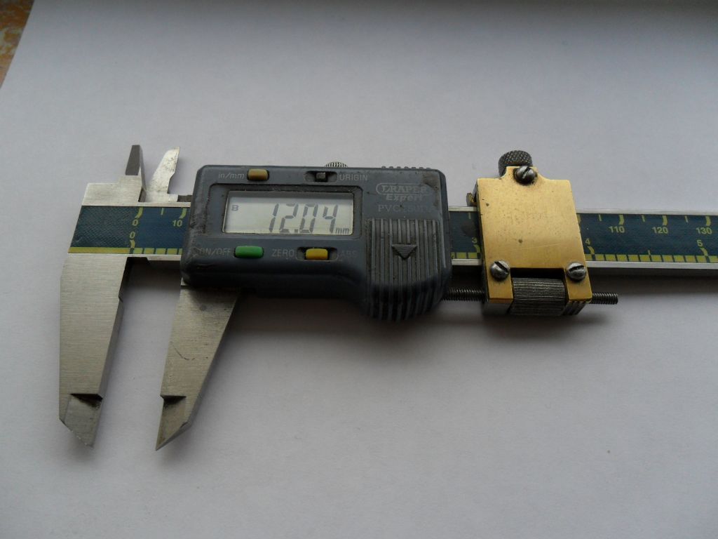

                  I added fine adjustment to my digital caliper
                  Nobbycaliper

                      If I recall it was 6 BA / the pitch is no problem as its just for adjustment. If I was marking out a job against an angle plate on a surface plate as Neil says I'm lucky I have a 10 inch Mitutoyo height gauge

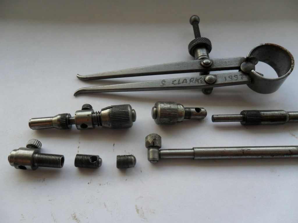

                        Does anyone practice the art of using simple internal calipers and a micrometer to measure hole size?
                        Your vernier caliper is all well and good but it will only give you the "max metal condition". You won't detect that a hole is big at the back edge, it is not easy to find a bell mouth hole with the vernier caliper and its unlikely that you will spot any out of roundness with the vernier caliper.
                        OK the spring bow caliper requires a bit more practice and feel to transfer the size to a micrometer but once mastered it can be as consistent as your typical digital caliper and more importantly tell you a lot more about the geometric shape of the hole.

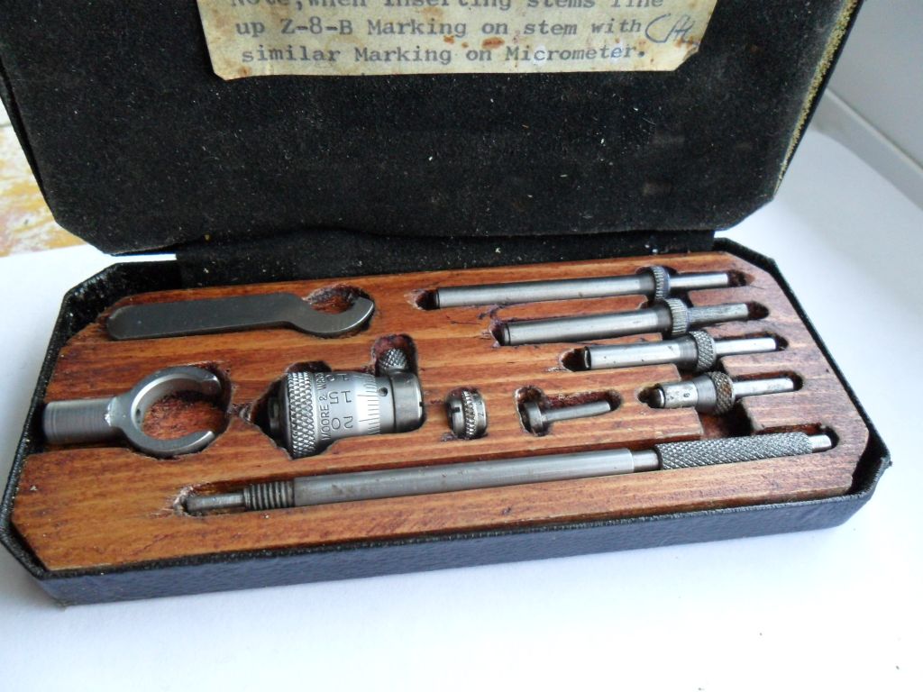

                          As Bob says .you may wont to check holes for roundness, bell mouthed etc inside calipers are tended to be forgotten in this digital age . I always talk now about the home shop machinist not industry . you can measure deep into the hole you are boring . I have also made some gauges similar to inside micrometers but have to be measured with a micrometer I also have a metric M&W set Nobbymoore wright
                          measure bores

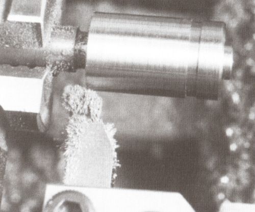

                            Regarding the gauges, I would not suggest they serve no purpose but as far as the book is concerned they are there to provide exercises in working to very close diameters and lengths.
                            For me, I only used the hole gauges very occasionally, that is when I need to get a hole diameter as close as I can to the gauge diameter. To do this, I set my top slide at about half a degree off of parallel with the lathes axis so that a 10 thou feed of the top slide will result in radial movement (depth of cut) of nominally 1/10th of a thou.
                            By this method I can take very shallow cuts as I arrive near to the required diameter for the bore, doing this until the gauge just enters the hole. Of course the tool has to be honed to a very fine edge for these depths of cut to be taken. You do also need to clean the hole completely to make the test.
                            This is basically the method I use in the book to arrive at very precise diameters and lengths. The following, scanned from the book, shows a round nose tool that has become magnetised and producing swarf almost like grinding dust. It shows a hole gauge being made with a chamfered leading edge to give early warning that one is approaching the required diameter and then a very slightly reduced diameter to show you are very close.
