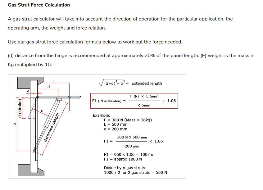

                                        Yes, sometimes! The figure is torque on the assumption the strut is for use in a known hinged arrangement like a car hatchback. I guess it's convenient buying spares for particular vehicles or something. But really they should be in Newtons. From this website:
                                        Maths make my head hurt, but you're good at this stuff Duncan. Assuming the strut is vertical, and the head is 'x' kilograms, what formula would give the strut in Newtons?  (I think it's the above with d = 0)
                                        Buying a strut for a mill, I would always go for one calibrated in Newtons rather than Nm, mainly because I don't have a feel for the difference! Working in kg for struts calibrated in N is inside my comfort zone and 1kg being close enough on earth o 10N for most practical purposes keeps the arithmetic simple. (And I need all the help I can get.)
                                        Edited By SillyOldDuffer on 22/05/2020 10:36:19

                                            I don't know where the 1.06 factor comes from, but otherwise the sum is correct. The cosine of the angle twixt strut and vertical (call it alpha) is (c/d)
                                            the vertical force required is F*(L/d), and the vertical component of the cylinder force is F1*COS(alpha), so for equilibrium
                                            F1*c/d = F*L/d.
                                            multiply both sides by d/c gives F1 = F*L/c. Perhaps the 1.06 is to make it stay up, not be just in balance. If the strut is vertical, c = d.
                                            Still doesn't involve Nm, which may well have been an imsprint
