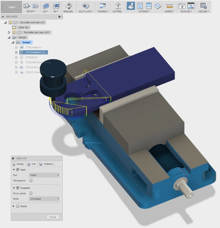

                                      Once you have created the required physical bodies, you can apply appearances to selected faces only ie not necessarily to the whole body. This would give you the option to select different colours / textures for the sectioned faces.
                                      There are no hidden catches to most 3D models. Very few modern companies would design products other than in 3D CAD and they have better things to do than model up commodity parts like bearings, fasteners etc. Conversely, few suppliers can afford to ignore that as a basic requirement of doing business.
                                      Even if you can't find exactly the part you need, it's often handy to take a std part and then edit it to suit. I've done this with fasteners, bearings, pulleys etc.
                                      Another (fascinating!) source of professional parts (that description includes the pricing BTW) is Misumi. They allow you to configure many (most?) of their parts, then download the resulting CAD file. And if you were feeling extremely rich and were sitting down at the time, you could even order them online. They would then be machined up to your requirement and delivered in remarkably short time. You don't need to order anything, so they can be used to generate convenient components and assemblies as a starting point for our own designs. The range of products they offer is truly staggering, as is the service they appear to offer.
                                      Quite a few tools and fixtures are supported with CAD models, so things like Kurt vises and fixtures can be imported and in fact there are quite a few already loaded in Fusion by default in the "CAM samples" folder. You might wonder why you would bother – but when you are generating CAM toolpaths, it allows you to identify bodies such as vises etc as "fixtures" and the CAM simulation will check for and flag up any clashes between the tool and the fixtures (none in this example):
                                      CAM fixturesMurray
