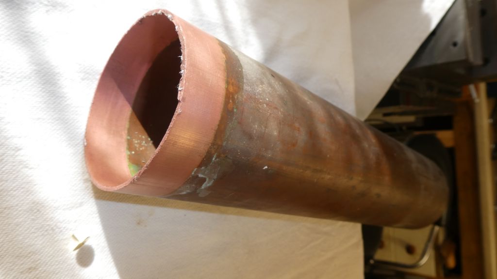

        I steeped the end of this bit of 3" copper tube in my "pickle" for 24 hours and was quite pleased with the result.
        £1.90 a litre from Morrisons – bargain!
