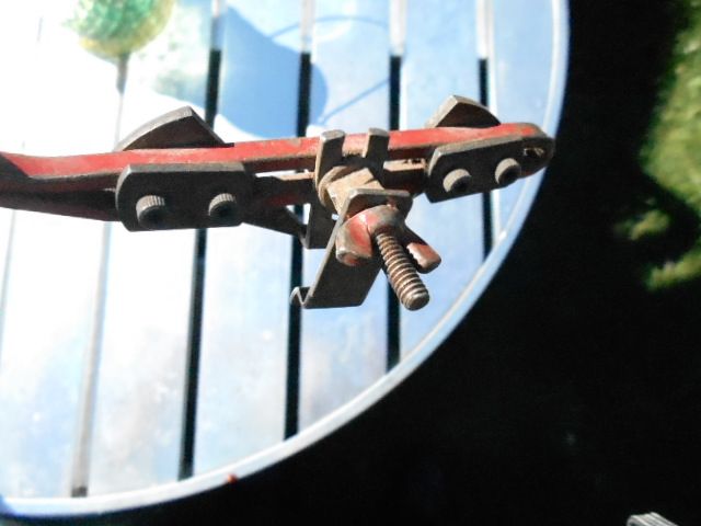

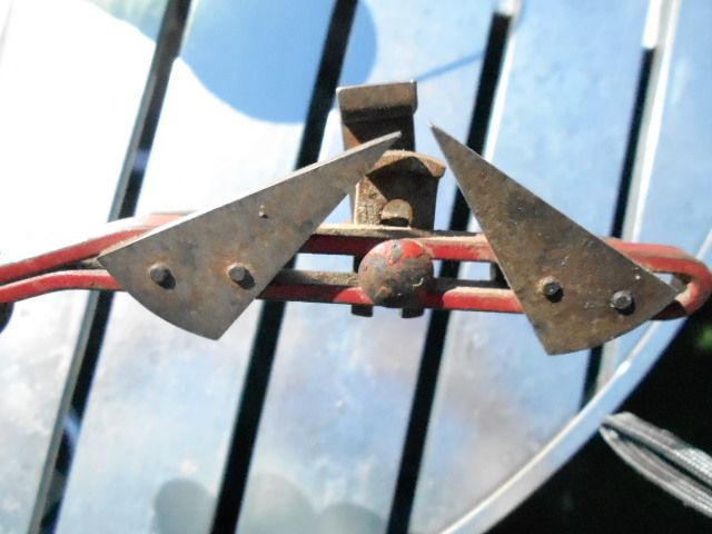

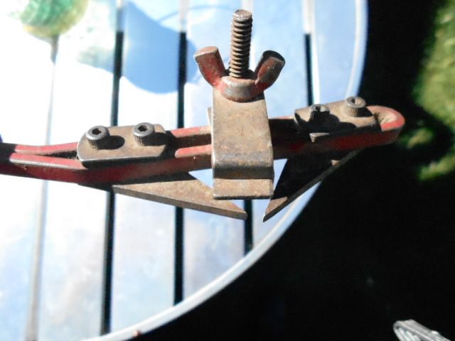

    BOB BLACKSHAW 1
      @bobblackshaw1
      dscn0931.jpgdscn0930.jpgI found this in my fathers shed, he was a maintenance fitter years ago, looks like some sort of cutter.dscn0929.jpg
      #26207
      BOB BLACKSHAW 1
        @bobblackshaw1
        #373507
        BOB BLACKSHAW 1
          @bobblackshaw1
          Sorry for the pictures.
          I found this in my fathers shed having a clear-out, he was a maintenance fitter years ago. looks like some sort of cutter, had a try but cant make it out, any ideas what this was used for.
          Bob.
          #373514
          Brian Wood
            @brianwood45127
            Bob,
            I have a feeling we have seen one of these before and if I am right it is a grooving tool used in woodworking. It cuts in both directions, when set correctly with one tip acting as the support for the one opposite while it shaves the bottom of the groove.
            Regards
            Brian
            #373515
              Yes that is what I was thinking Brian, the two parts held by the wing nut set depth and distance from an edge then the tool is drawn towards the user and the shallower angled "blade" acts like the sole of a plane and limits the depth the more vertical "blade" can cut.
              #373525
              roy entwistle
                @royentwistle24699
                Wasn't there one on here some time ago ?
                Roy
                #373533
                Speedy Builder5
                  @speedybuilder5
                  Looks a bit crude for woodwork? The "cutters" look very blunt to cut wood, looks more like a slate/ tile nibbler ?
                  #373618
                  NIALL HORN
                    @niallhorn50878
                    It's a Tectool – there are a lot of them about and they do work but need practice to get a clean result.
                    See the thread https://www.ukworkshop.co.uk/forums/tectool-two-cutter-plough-t16198.html
                    Niall
