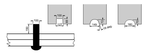

                                      John Ockleshaw 1
                                        @johnockleshaw1
                                        Hello Ken, I think it was the late W.J.Hughes who recommended using three hollow punches to form rivet heads.
                                        The sketch shows their proportions. They limit random buckling of the shank and offset heads.rivet head.jpg
                                        #248751
                                        Ken Bevan
                                          @kenbevan42381
                                          Thanks for the detailed drawings John. I have made up some 'sets' as per previous suggestions in the thread so far, & have met with very good success compared to my previous attempts. Would like to make up a set like you suggest but how could I achieve the dimensions attained, particularly in diagram 2, in the home workshop?
                                          Regards
                                          Ken

                                            #248756
                                            John Ockleshaw 1
                                              @johnockleshaw1
                                              Hello Ken, I use D bits to form the cavities. Machine the taper on and hand file the radius on the second punch's D bit. For the third one hand file that as well if you do not have a ball turning tool.
                                              One other thing – machine say a 5 deg. chamfer on the face of the punch leaving say a 0.020" land around the opening. This will save marking your workpiece if the punch is not perfectly plumb.
                                              Best wishes, John
