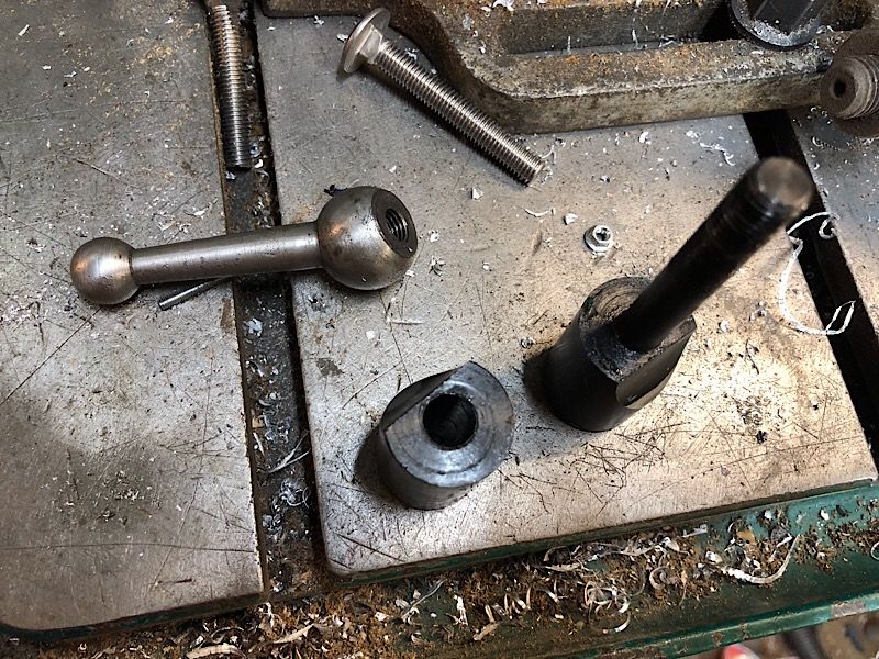

      I have a Fobco drill . The table won't clamp up securely , I have a scissor jack under it . I notice that the split in the rear if the clamp doesn't go right to the bottom or the casting . If I cut through this last bit will it clamp better or could it be a disaster . Anyone had similar problem ?

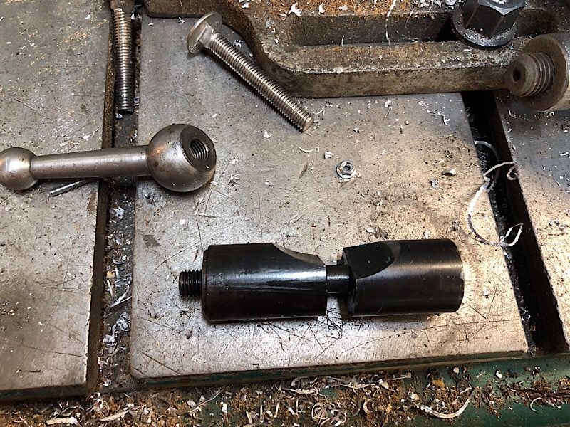

              take the clamping mechanism out and look at it
              its a bolt with a collar ( loose) that has a piece machined out of it to fit round the shaft
              and a nut at the other end with a similar part machined out.
              when you tighten the 2 pieces pull together and grip the shaft
              theres no moving of the casting

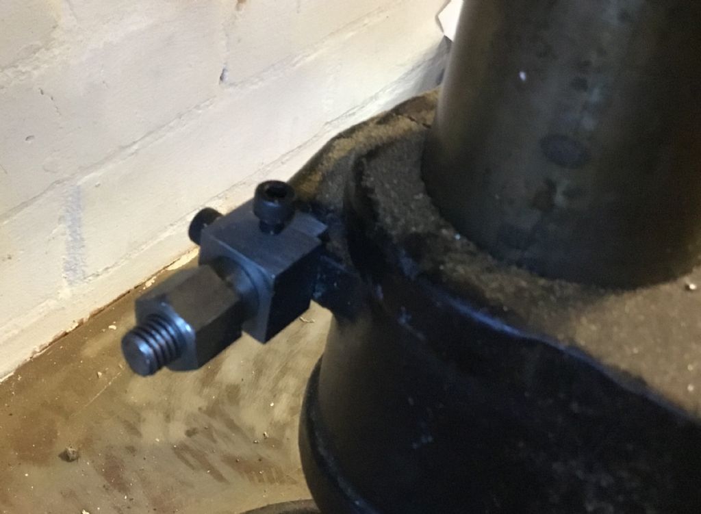

                      I had the same problem which drove me mad for ages, probably caused by slight wear on top part of column.
                      Replaced original small handle with much larger one. Handle boss has blind tapped hole. Long spacer keeps handle away from column. Thrust bearing between handle and spacer.
                      Replaced bolt with piece of studding running through square spacer with nut on left.
                      Square spacer has corner cut away to engage with cut-out on column clamp and stops it rotating.
                      Studding has part of thread machined away to allow cap screw to lock position of studding when nut has been tightened to set handle throw.
                      It all works so well that the handle could be a bit shorter but haven't got round to it yet.
                      A lot of faff but works a treat!

                                    I have had three Fobco drills and a friend has another. All of them have the same table clamping arrangement. The slot in the casting in all of them did not extend the full height, it was closed at the bottom.
                                    I think there may be some confusion. There are two clamps of the type Ian Parkinson refers to on a Fobco. One provides a clamp for the quill, the second provides a clamp for the head assembly on the column (note it does not “support” the head but prevents – or allows – the head to swivel clear of the table and base).
                                    There is a collar under the head which clamps to the column to support the head itself, and as Peter Spink says it prevents the heavy head falling and smashing into you, or worse the table! This collar is clamped by a through bolt with the chrome handle as the nut.
                                    The table is also clamped to the column by a through bolt in the same way. Both through bolts mentioned probably had square heads originally as the castings have a square to fit the head and prevent it turning.
                                    I have had the same problem as Phil and others have mentioned in getting the table to clamp firmly on all the Fobcos I have encountered. It appears to be the Achilles Heel of an otherwise excellent drill and like others I have resorted to a longer lever. The original 2.5 inch handle just does not do it so I use a stout tube spanner giving me a lever 6 inches long but it still requires some effort to avoid movement. Incidentally when the clamp is relaxed I can get a 0.080” feller in the slot and when it is securely clamped only a 0.030” feeler will fit so it is not closing the gap completely. The gap is clean by the way!

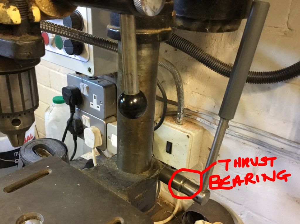

                                      not just me then !! I will make up a new bolt and I have a small thrust bearing to try , I will see how a longer arm works out The scissor jack holds the table up but have been getting some sideways movement , when clamped

                                        My Fobco Star is as others say. The Table is clamped by  a through bolt and short ball handle. The slot is closed off at the bottom. I too use a piece of tubing to get more leverage. I put this need down to 50+ years of wear causing a slight increase in clearance on the column. In use I try to minimise the number of times I move the table with an array of wood packing kept by the machine.
                                        The head is clamped by a two-piece clamp, also shown above. It's more effective than the split clamp but there is not enough metal in the table casting to modify it to that type.
