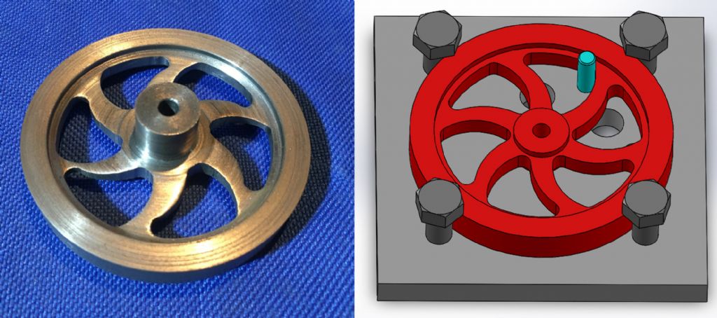

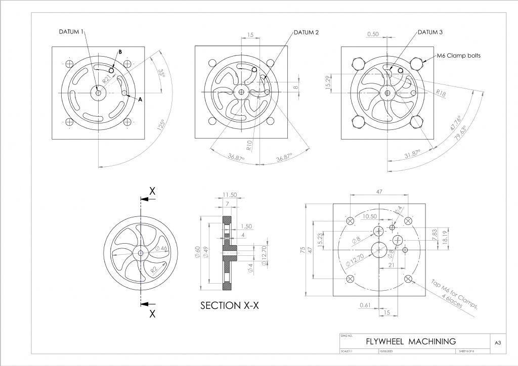

              Paul Lousick
                @paullousick59116
                This is a flywheel which I made on a rotary table. (Dimensions are for this flywheel only).
                A CAD drawing made first to determine the geometry of where to position the work on the mill.
                1. Turn a solid flywheel from round bar and make mounting plate for milling on RT.
                2. Center the RT under the mill spindle and zero the DRO, Clamp centre of mounting plate with centre of RT.
                3. Clamp flywheel (FW) to mounting plate and move X-axis (21mm). Mill curved slot (35 degrees)
                4. Rotate FW for cutting next slot. Use pin for positioning. Repeat for remaining slots.
                5. Move table to 0,0 position. Align Datum 2 with centre of RT.
                6. Move table to position of Datum 2 (15,8) and mill slot.
                7. Repeat for Datum 2.

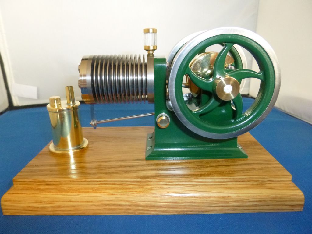

                                      I made 2 curved spoke flywheels from cast iron slices. I have the details somewhere. Is this what you want ?
                                      regards
                                      Steve
