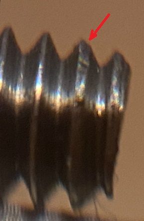

      Hello all, I'm busy restoring a Flexispeed meteor-II lathe. The Cross-Slide lead-screw is quite badly damaged.
      And herewith starts my challenge. (I'm not very clued-up in the imperial sizes)
      I've measured the OD of the lead-screw thread @ 0.188 with 24tpi. My best guess would be that this should give me a 3/16 – 24 BSW thread.
      ,,, I bought the taps & die. The tap fits perfectly into the Cross-Slide. But the die does not fit the "good" lead-screw at all. (however, the "good" lead-screw also fits the cross-slide perfectly)
      "forcing the die onto the 1st 1 1/2 threads, I took a photo,,, definitely Not good.
      (,,, not sure how to add the photos)
      Any suggestions as to what's going on here most welcome. (I've used FEW taps & dies)
      Thanks, Johan

                Is the die a ‘split’ version ?
                … if so, it may need adjustment in the dieholder.

                  You need to be careful with the threads on the Flexispeed Meteor 2. I found that the threads on my particular one were UNC and not Whitworth.
                  When I made a longer cross slide the thread I used for the lead screw was a No 10 – 24 UNC, this has a 60 degree angle against the 55 degree angle of the Whitworth. This could be why your die does not fit the good lead screw very well.
                  I hope this helps and does not confuses the issue.
                  #521167
                    Good point, Neil
                    Johan’s photo of the thread does look more like Unified than Whitworth in form
                    … obviously can’t be sure, but it would explain why the Tap ‘fits’ but not the die

                      Just to underline the inconsistency with threads on the Flexispeed Meteor: I have two lead screws which have the same number of TPI, but have different thread forms. One is quite square in section, whereas the other is much more triangular. Similalry, I have a spare cross slide and the gib screws are not interchangeable between the spare and the slide on the machine.
                      Regards,
                      James.

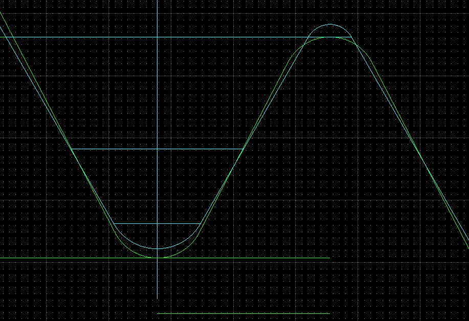

                        I'm surprised the fit is that bad if it is just a UNC vs BSW difference. When trying to identify some threads a while back I drew up the two forms overlaid on each other. Yes their angles and treatment of the thread peaks and troughs are different but…
                        1. I think it's very difficult to tell either by looking or by measuring which one is which
                        2. When trying off the shelf nuts and bolts together they seemed to all fit each other, both ways of mixing.
                        Off the shelf nuts and bolts can have a generous tolerance allowance which may account for point 2 and may be less true for your lathe parts but hopefully you get my point.
                        That's not to say it's fine to mix them in critical situations – one is 60 degrees and the other 55 so the thread flanks won't apply load to each other evenly… but in the majority of cases they do seem to fit together.
                        To me, UNC vs BSW doesn't add up to the amount of misfit that your photo shows.
                        I don't have any speific knowledge of the threads on the Flexi but if I were you I would also check the measurement over wires of the male thread before going any further – it may not fully resolve the question but it will be a measurement of the thread that you are dealing with at the part where it needs to engage with its friend. The link below will tell you the wire size and measurement over wires…

                            Andy Carlson
                              @andycarlson18141
                              Posted by Michael Gilligan on 20/01/2021 08:45:53:
                              (a) The difference would also be between 3/16” and #10 diameters … small, but non-trivial
                              (b) May I ask : what ‘misfit’ do you see shown in a photo of a single item ?
                              A… yes, I was using bigger sizes where UNC and BSW have the same nominal size
                              B… I was assuming that the deformation of the end-most threads in the photo was showing the misfit. Maybe that wasn't right?
                              I dug out my drawing again. It was just done for my own amusement some time back and never intended for sharing… or even necessarily for me to remember the full detail later, but…
                              Checking the dimensions again, this is for an 18 TPI thread with UNC in blue and Whit in green – the colours were less muddy until I exported to JPEG. This assumes zero tolerance (which is never the case). The male side is at the bottom. UNC chops off the peaks of both male and female threads as shown by the lines on the drawing.
                              After doing this I decided that trying to determine UNC-ness or BSW-ness of an unidentified thread by fitting it to a known nut or bolt was probably not going to be very informative with real world tolerances in play.
                              Hopefully the OP is making progress.

                                            #521913
                                              Posted by Johan Viljoen on 22/01/2021 17:56:01:
                                              Posted by Andy Carlson on 20/01/2021 19:20:42:
                                              B… I was assuming that the deformation of the end-most threads in the photo was showing the misfit. Maybe that wasn't right? This is exactly the misfit.
                                              My apologies to you both … I had assumed that the ‘deformation’ was evidence of slight chamfering to ease engagement [noting that this is a fairly small diameter] :
                                              If it’s been done by the die, then the die [or its adjustment] is suspect.
