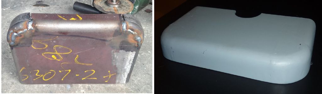

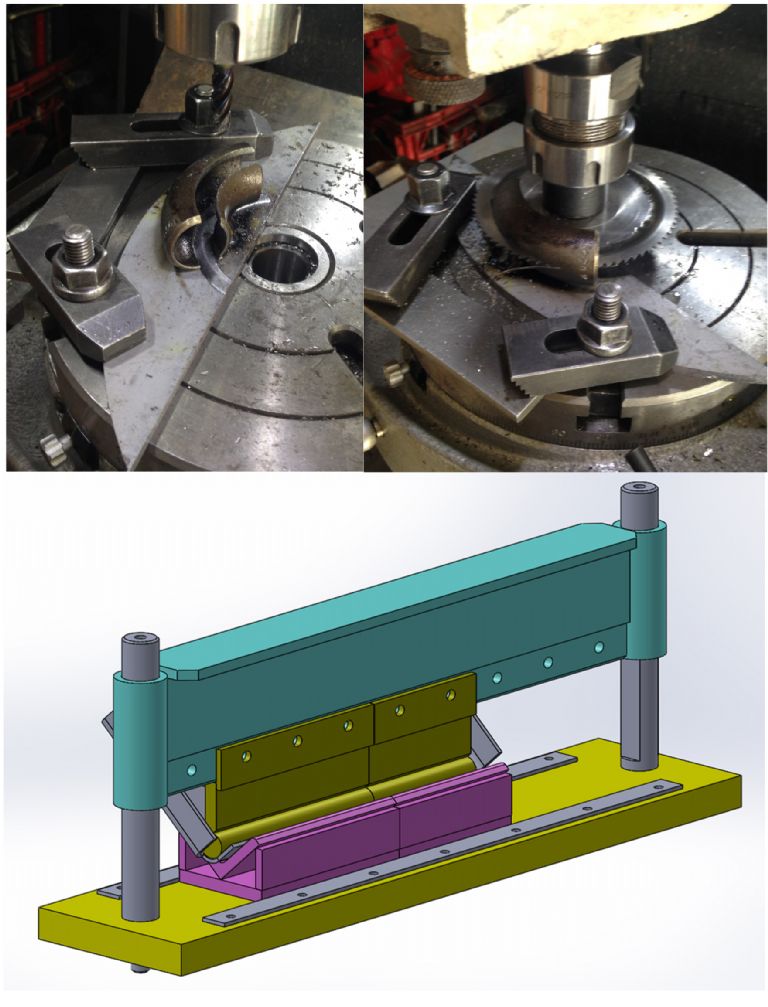

          #314423
          Paul Lousick
            @paullousick59116
            I had a similar problem making the spectacle plate for my traction engine. Plate used was 5mm thick and corners cut out of a 20mm pipe elbow. The radius of the straight edges made the same as the radius of the elbow. The pipe elbow was tack welded to a plate and mounted on a rotary table and machined to size on the mill.
            2 days making the brake press and 10 minutes to bend the plate. (Took about 10 tonne to bend 5mm thick x 220mm long plate).
            Fabrication welded and finished product after grinding and painting.
            Paul

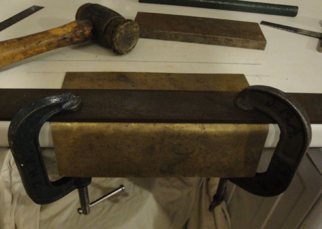

                Hi Clive,
                Do not under any circumstances anneal the brass sheet.
                I would suggest making up an internal former out of standard kitchen work top with a radiused edge. The brass is then sandwiched between this and another piece of kitchen top or steel which is then clamped on top but exposing the length to be shaped over the lower kitchen top.
                The brass must be very securely fixed so that it cannot slip.
                The exposed brass is then slowly beaten to shape.
                This is the set up I have used which is rather Heath Robinson-ish. I ought to have added something better to secure the brass as it did slip. However this really is my kitchen work top and drilling it was out of the question!
                I have used the same sort of set up for GWR tender bodies and bunkers and pannier tanks. There is something to be said for having material greater than the height of the tender sides as the bend is more easily formed. Then trim back to the required height.

                #314543
                Phil H1
                  @philh196021
                  Julian,
                  Is the bend visibly uniform at both ends? I can imagine a nice uniform radius all the way along the bend but maybe a slight distortion (maybe a slight upturning) at both ends i.e., is extra attention required at the ends or do you trim the sheet to length after the bending operation to clean the ends up?
                  PS: I hope you did that when everybody else was out of the house.
                  Phil H
                  #314633
                  julian atkins
                    @julianatkins58923
                    Hi Phil,
                    I know exactly what you mean.
                    Just a bit of extra dressing required with my Thor hammer using the copper face on the ends.
                    Cheers,
                    Julian

                      #314672
                      David Taylor
                        @davidtaylor63402
                        When I made my 6 wheel tender with flared top I used a steel bar with the desired radius welded to a flat plate of steel as the former. To do this you'd sit the bar and the plate on a flat surface and weld them such that the plate was sort of tangential to the bar.
                        The brass was sat upon this, situated so the start of the bend was where the bar joined the plate.
                        Another flat sheet laid on top of the brass, and everything clamp together. A bit like Julian's solution.
                        I did anneal the brass. I think I did that when it was already clamped between the two sheets of steel.
                        Then just tap the brass over the former. Luckily it worked well – I would have been upset after drilling all the rivet holes if I messed up!
                        The join at the rear corners was tricky, I just kept filing until I had a reasonable fit. I did mess up the rear plate of the tender and had to make another.
                        Sorry I don't have a photo of it, I borrowed the steel bits off a club member.
