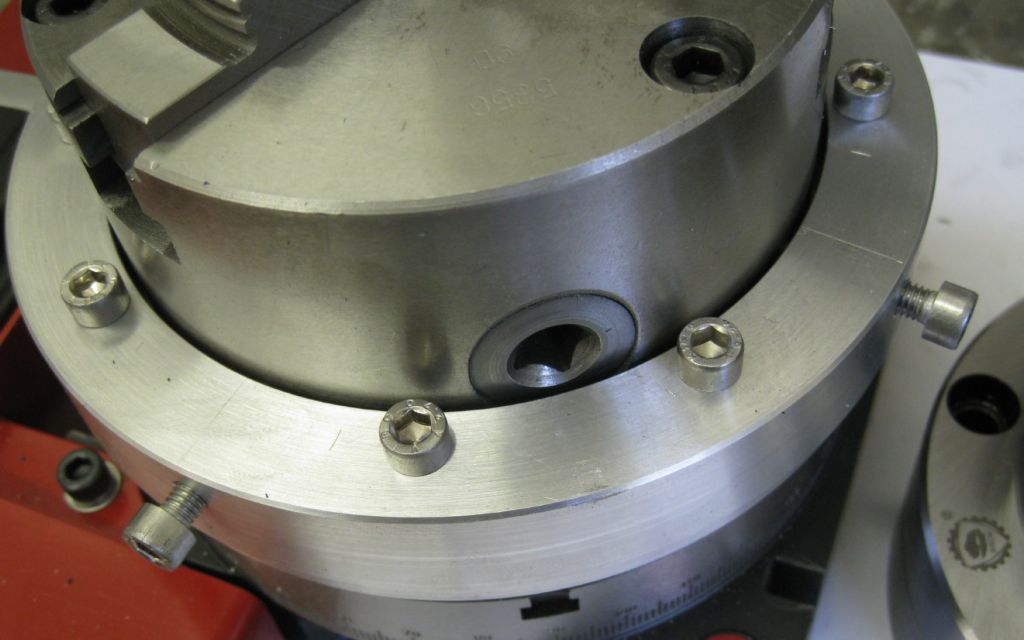

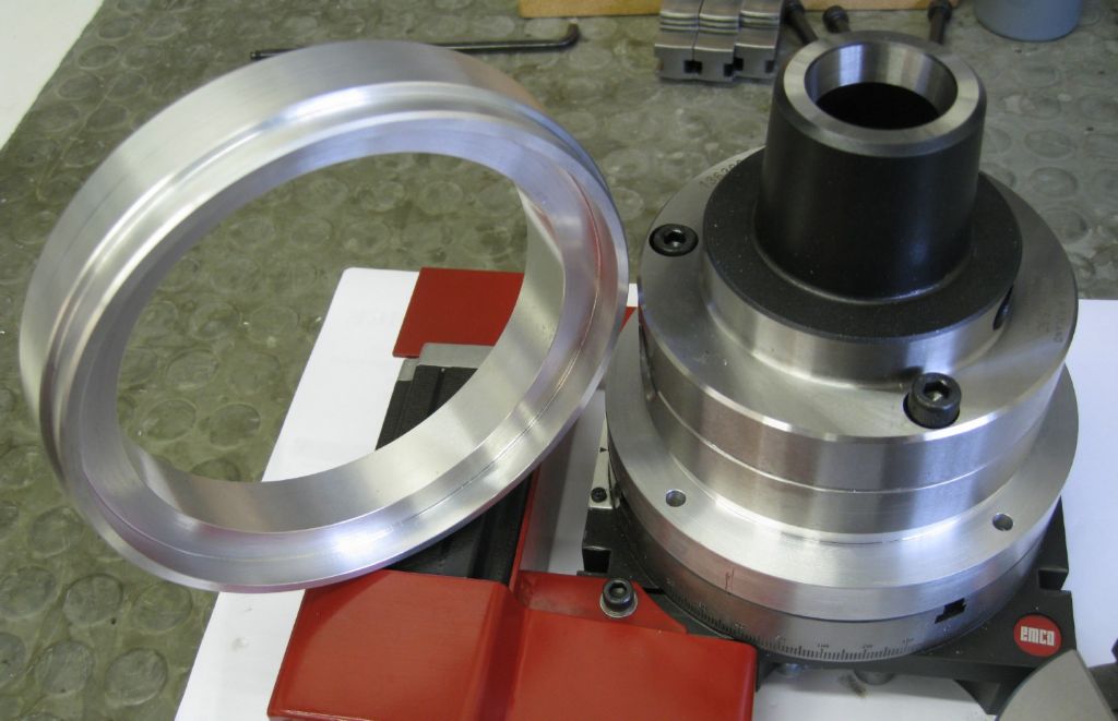

                                      Joseph Noci 1
                                        @josephnoci1
                                        Hi Peter,
                                        a week or so ago I posted a bit on my rotary table fitted with a chuck. I made a base-plate (photo below, right) between chuck and table- The base plate bolts to the table and is larger in diameter than the table and chuck. I drilled the chuck through so that it bolts onto the base plate from the front of the chuck.
                                        Surrounding the chuck is a larger ring that also bolts to the base plate ( below left) and has four screws through the side that impinge on the chuck. Backing off slightly on the three chuck bolts allows the work piece to be nicely centred using the 4 side screws, and then tighten up the chuck bolts.
                                        Forgive the repeat of the photos of the previous post – I have not managed to work out how to give a link to just a specific section post in the forum…

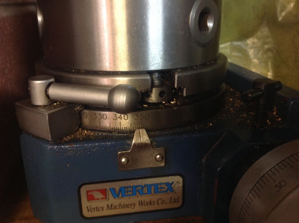

                                          I have drilled 4 M10 holes in my RT allowing me to bolt down a 4 jaw chuck. They were carefully located to make the chuck body as near concentric as possible. But the way I look at it is that I would never put something round in the 3 jaw in the lathe and expect it to run true – I always try to plan to get all the concentric things turned at one setting. If something has to run true it goes in the 4 jaw on the lathe. So why is it different on a rotary table?

                                            I used the threaded holes in the chuck body to fit studs and bolted it to the RT using round nuts with radial tommy bar holes to bolt to the slots. Clocked the chuck true and tightened. I have a 6" RT for non- chuck use. img_0080.jpg

                                              Joseph Noci 1
                                                @josephnoci1
                                                Just made 12 M8 fine stainless hex-head bolts for a mates bike – made the bolt from round bar and machined the hex on the rotary table using the 3-jaw chuck. Centred the chuck with a piece of 8mm bar in the chuck, and then did the bolts one after another – no faffing with 4 jaws ( or 2 at least..) each bolt time…The chuck centres as quickly as one would centre a bar in a 4-jaw.
                                                The same backplate /centering ring also takes the 5C collet chuck, so the centering ring mechanism works a treat.
