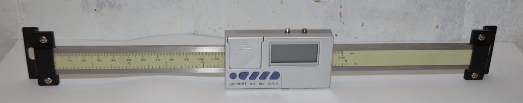

I'm in the process of fitting a DRO setup to a Myford Lathe using the same slides.
I'm using Shahe scales bought through AliExpress, I had no trouble with ordering and the slides arrived in 2 weeks.
