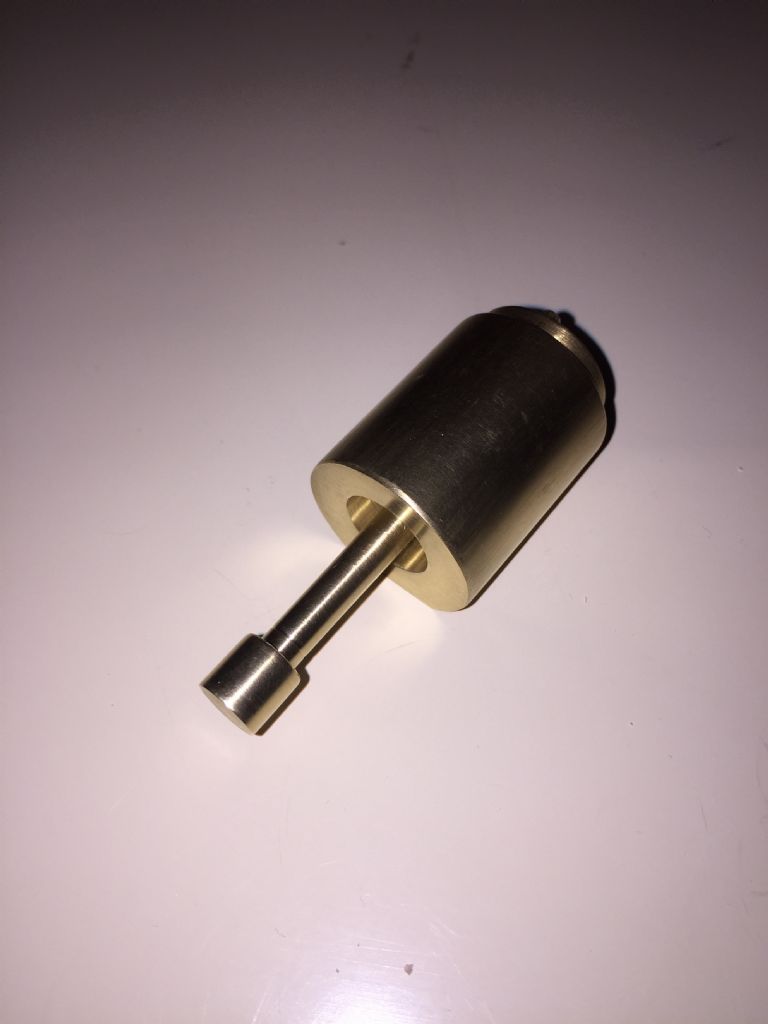

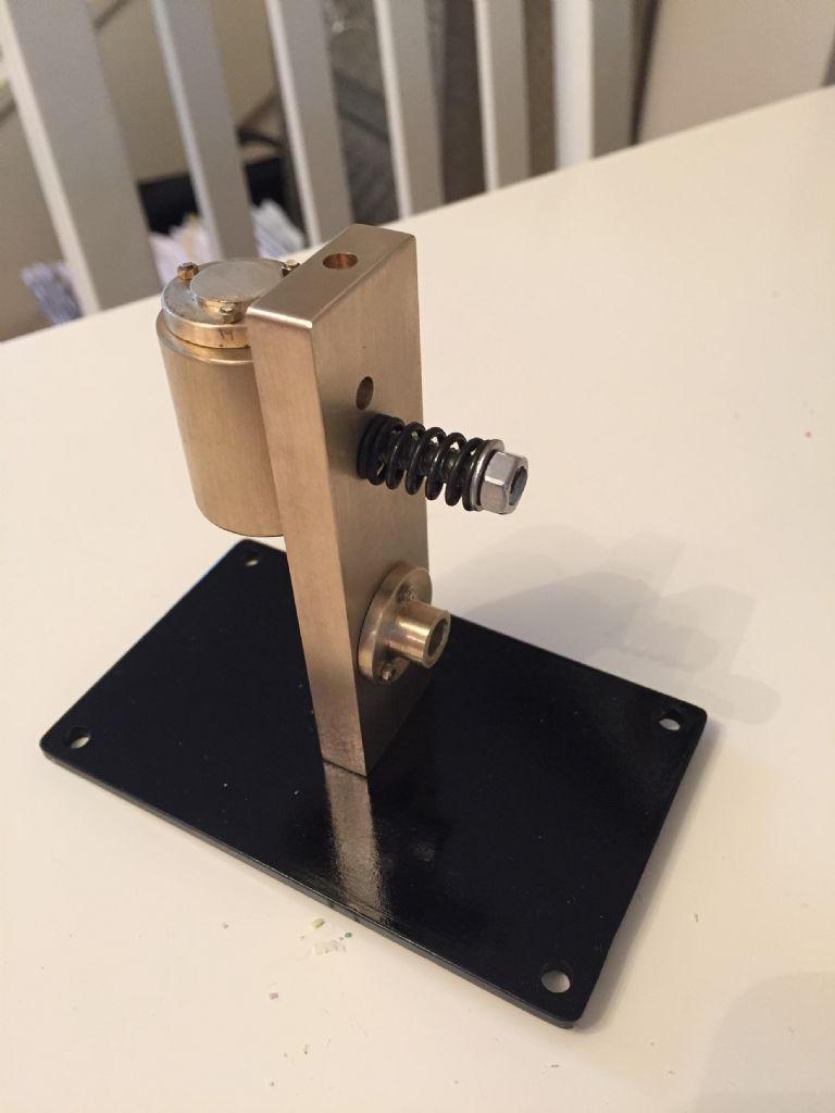

        As the title says I have finally started my very first model engineering project.
        I bought a Myford ML7 lathe and a Sieg mill around six months ago but as I hadn't finished getting my workshop ready I was unable to use them and get anything started, anyway the workshop is all but complete and over the last few weeks I have been busy getting everything I need for my first project.
        While waiting to get started I trawled the internet and found what I believed to be the simplest Oscillating Engine I could find check out http://www.steves-workshop.co.uk if anyone is looking for an easy first build. I then got myself the materials and final tools I needed to start.
        Below are pics of my progress, any helpful hints and tips off the experienced builders out there would be most appreciated.image.jpeg
        The picture above shows the cylinder with its cap sat in place (top left), I still need to drill these to fix the cap on, next is the crank bushing (top right), again needs drilling for fixing to the frame and last is the frame also requiring drilling to take the bushing however all of the other holes are drilled including steam inlet hole on the reverse side which enters on the top, also fixing holes have been drilled and threaded on the bottom ready for mounting.

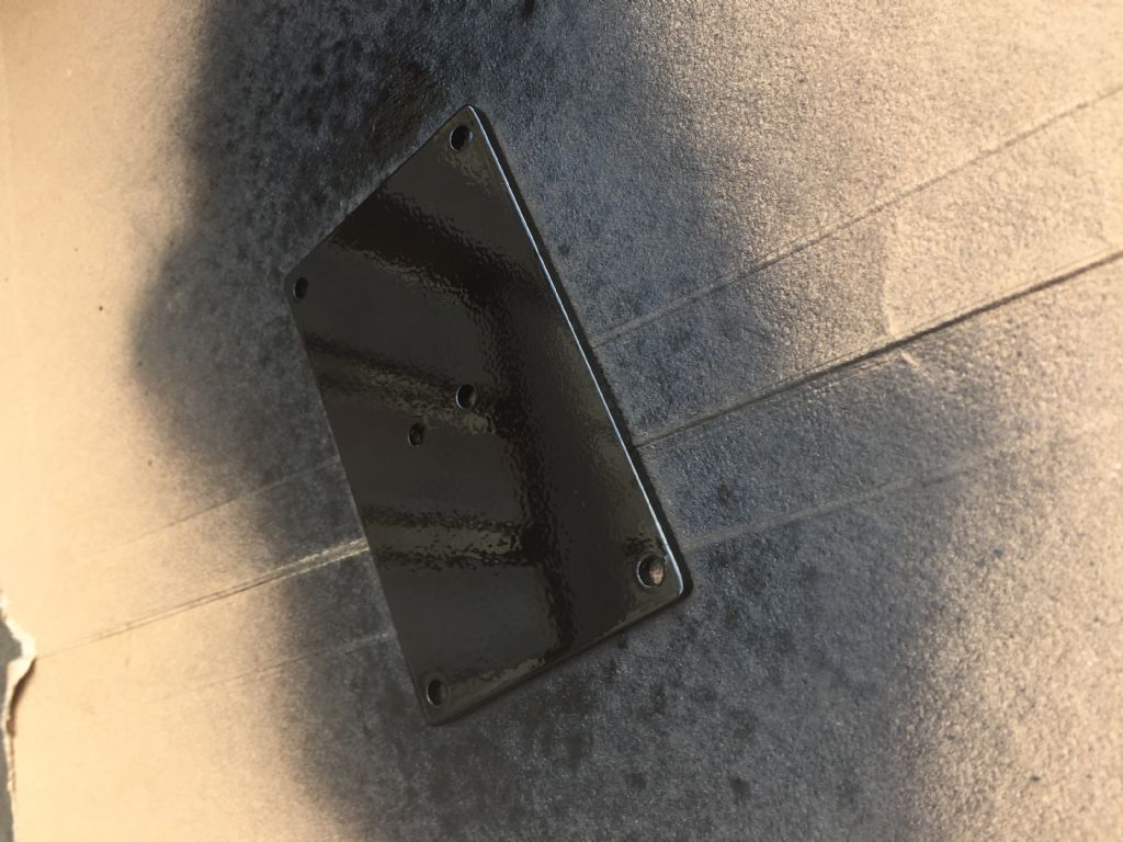

        Not the best picture I know and for some reason it turned 90deg between taking it with my phone and uploading it to here. This shows my base plate just sprayed with black enamel paint and drying in sun.
        The parts shown aren't absolutely perfect but for my first project and with little to no engineering/machining experience I'm pretty happy and I've learned loads already.

                                    Hi Mark, nice work! There is one point that I would like to raise. It is helpful to relieve the area round the trunion pin, as, when the two surfaces wear as the engine runs, the centre area will wear more slowly than that which is moving faster and further. Relieving it will allow the faces to remain in contact more easily. On the Stuart Turner oscillator, they mill a slot across the port face on the standard, about 5/32" wide. An old Bowman that I had, had a 3/8" counter bore round the trunion pin hole. There is something similar on the remains of another old engine I have, only it's 1/2" diameter. I'm sure your engine will run perfectly without this relief, but it will remain, well not exactly leak proof, but in good working order for longer if you do it. Keep up the good work.
                                    Regards Maurice
                                    #242918
                                    Mark Williams 21
                                      @markwilliams21
                                      Hi Maurice, thanks for the advice however being a complete beginner I am unsure of what you mean, any more pointers or pics you could give to aid my understanding as any modifications I can make to add longevity to my engine would definitely be considered
                                      thanks
                                      Mark
                                      #242930
                                      Maurice Cox 1
                                        @mauricecox1
                                        Hi Mark; yes, certainly. I will post a couple of pictures tomorrow. The idea is that the two flat faces only touch in the area of the ports, and are able to bed together without the unworn central area stopping the process. Can't take the pics before that; sorry. Will do A.S.A.P.
