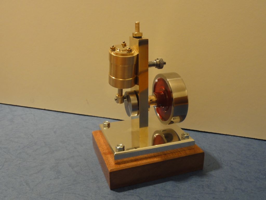

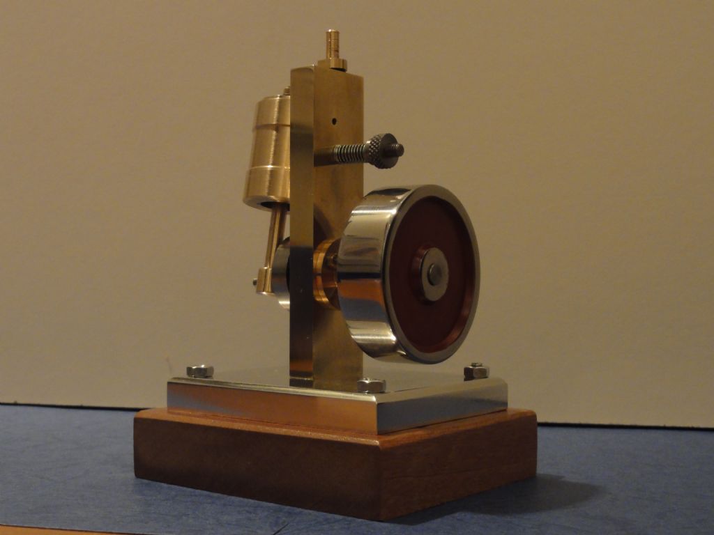

                Jim Nic
                  @jimnic
                  Ian
                  I can recommend Steve's wobbler design as a first project, it was the one I started on.
                  First Attempt 1
                  First Attempt 2
                  There is a lot of good guidance with the drawings if your skills are a bit rusty and if you are up to speed already it will be good practice to get familiar with your new lathe. As no castings are involved, if you make a mistake there is no delay in making a new part and it will be cheaper than replacing a casting. Plus you will hopefully end up with some bits of stock materials which always come in handy.
                  My second engine was a Stuart 10V which I did with no problems because I had a fair knowledge of my machines and how various metals behaved by then. I also had a few more bits of tooling having completed a couple of other small projects.
                  Jim
                  Edited By Jim Nic on 12/02/2018 19:14:37
