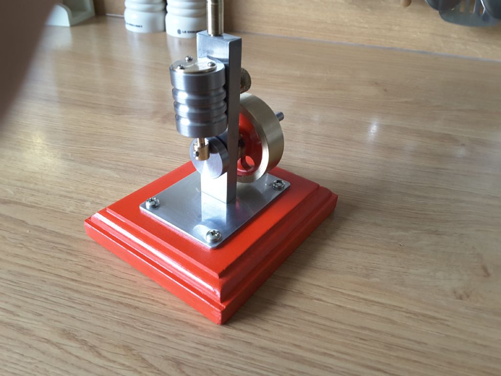

                      I went with a hot air engine avoiding need for steam or compressor….learned a lot from it including how many not quite right parts end up in the scrap bin… Free plans from Jan Ridders.

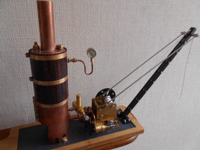

                        dscn1185.jpgI found this book at a charity shop, four easy engines and boilers to run them. If you need a drawing let me know. BUILDING SIMPLE MODEL STEAM ENGINES, By Tubal Cain. This is the crane, most difficult of the the four.

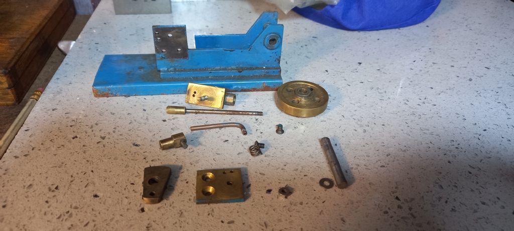

                              20210709_165235.jpgHello Matthew,
                              This wobbler has been sitting in a box, I can't be bothered to refurbish it, looking at it a few parts to be made and it should work OK. A good start if your thinking of making one, you can have it just PM me.
                              Bob
