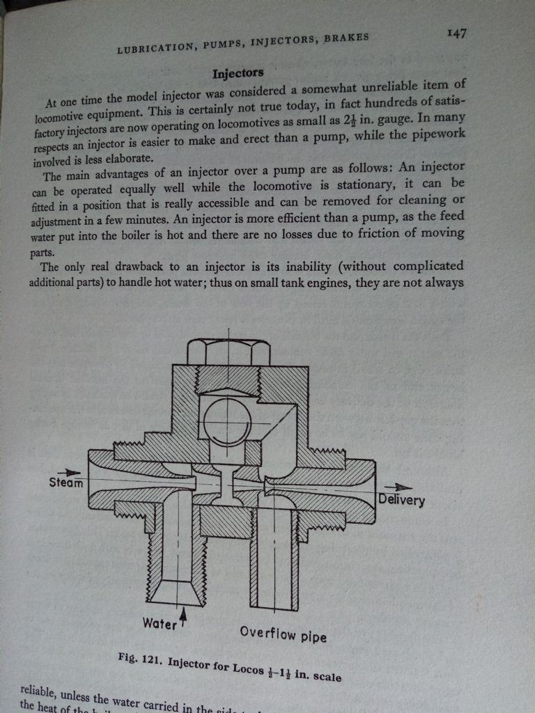

                            Posted by Nigel Graham 2 on 16/08/2021 23:03:24:
                            Through the injector?
                            I'd have thought the overflow valve would prevent that? It opens to outwards flow, not inwards.
                            the water gets in between the end of the combining cone and the delivery cone downstream of the check valve. Photo from Manual of Steam Loco Construction.injector.jpg

                              Posted by duncan webster on 17/08/2021 13:04:57:
                              For locos that require lower feed rates the delivery cone hole can become small. For my Stirling single I made 10oz injectors with the delivery cone hole just under 0.5mm. Filling up the boiler through that might take a while…
                              I generally fill from the blowdowns, it cleans the valve seat as a bonus…
