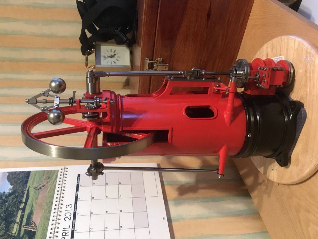

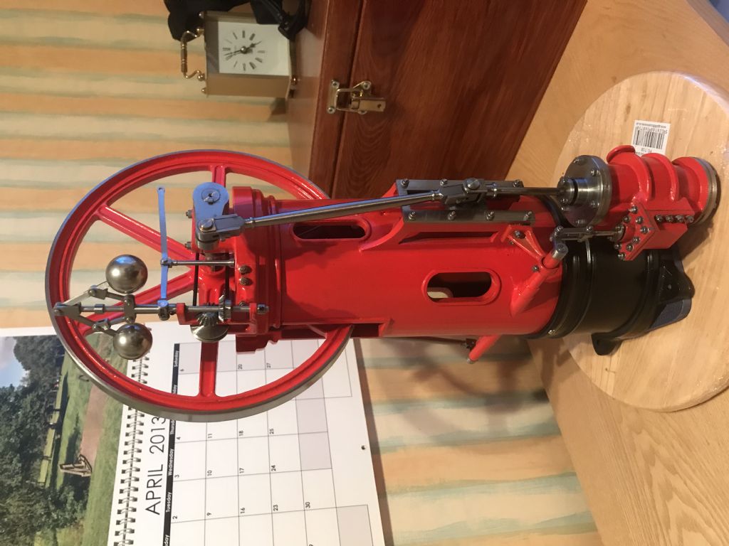

                                        #340218
                                        Ian Hewson
                                          @ianhewson99641
                                          Now I am getting well on with my engine, running well on air, I was thinking that I do not have much of an idea what it would have been used for, driving or pumping etc.
                                          Can anyone enlighten me as to the uses for it?
                                          Ps the date on the calendar is the Centenary of the golf club i used to play at.
                                          Not found how to rotate pic's either as yet.

                                          #340227
                                          Ian Hewson
                                            @ianhewson99641
                                            Thanks for the edit Neil
                                            Ian
