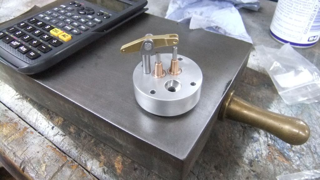

          #656335
          Dalboy
            @dalboy
            Made the rocker arm pivot pin but I feel that it needs shortening as when it is put through the support for the rocker the split pin is about 1/8" away from it. The pin was made to the measurements on the plan
            Rocker support in place I need to make a small flat on the bottom so that a grub screw has somewhere to grip as well as keep the support at the correct angle for the exhaust valve

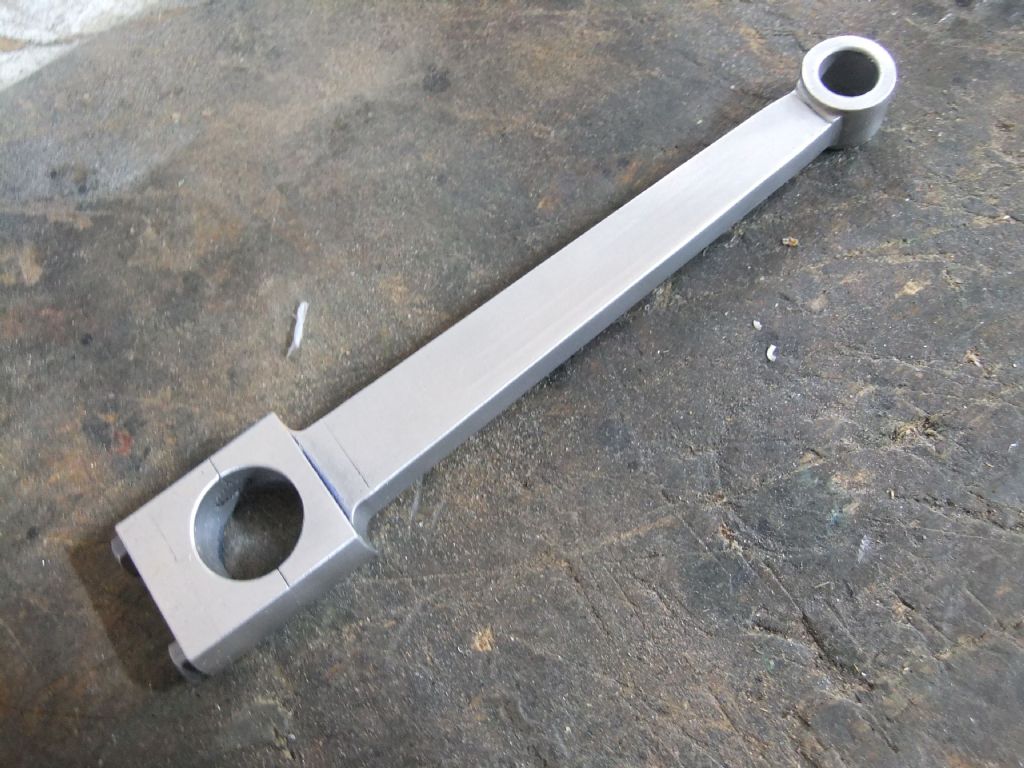

              Made a couple of pins for the rocker arm.
              Then onto the conrod which after three failed attempts I have now managed to get further. I made up a set of filling buttons to do the small end. As well as that I need to shorten the the big end cap to remove the centre hole when the outer edge was turned
              Then managed to get most of it complete except for some machining to lighten the rod which means making a fixture to machine those. They are the two cut outs along the side of the rod.
              #658873
              noel shelley
                @noelshelley55608
                Is the ball race in the rocker arm a good idea ? The radius is very small on the valve stem. Noel.
                #658874
                Dalboy
                  @dalboy
                  Posted by noel shelley on 02/09/2023 18:54:01:
                  This is what shows on the plans but will not know until it is assembled with the springs in place. I have seen one running with no problems.Check from 4:22
                  #658875
                    Should be fine on a slow runing Hit and Miss engine, I've smaller bearings on the Bobcat based opposed twin and not heard of anyone building the Bobcat or jaguar having issues and they run a lot faster nor the several 100 Farmboys out there.
                    6mm dia bearings on 3mm valve stems

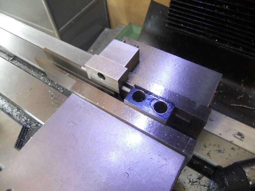

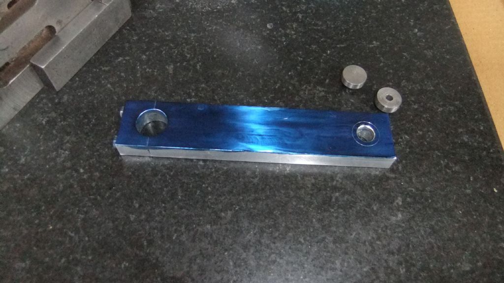

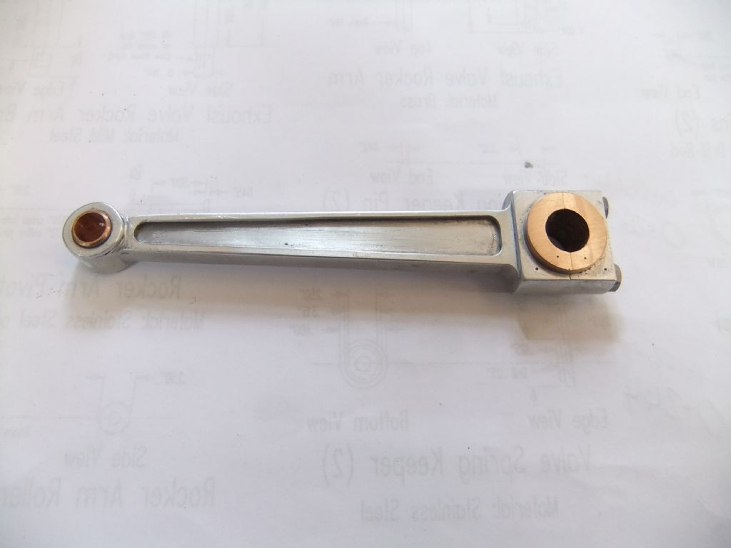

                                  #660512
                                  Dalboy
                                    @dalboy

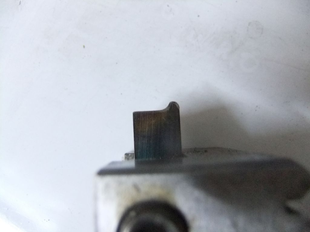

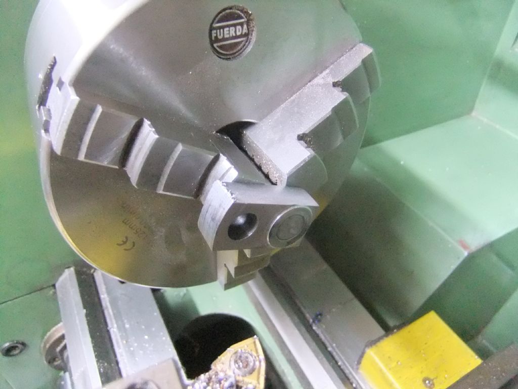

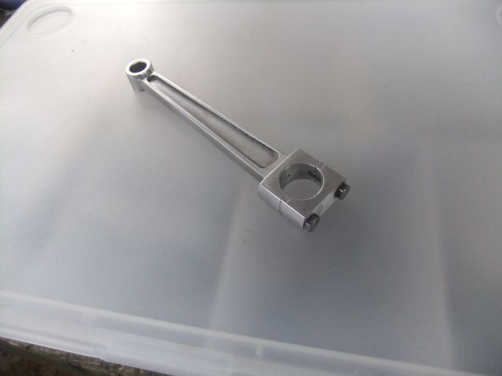

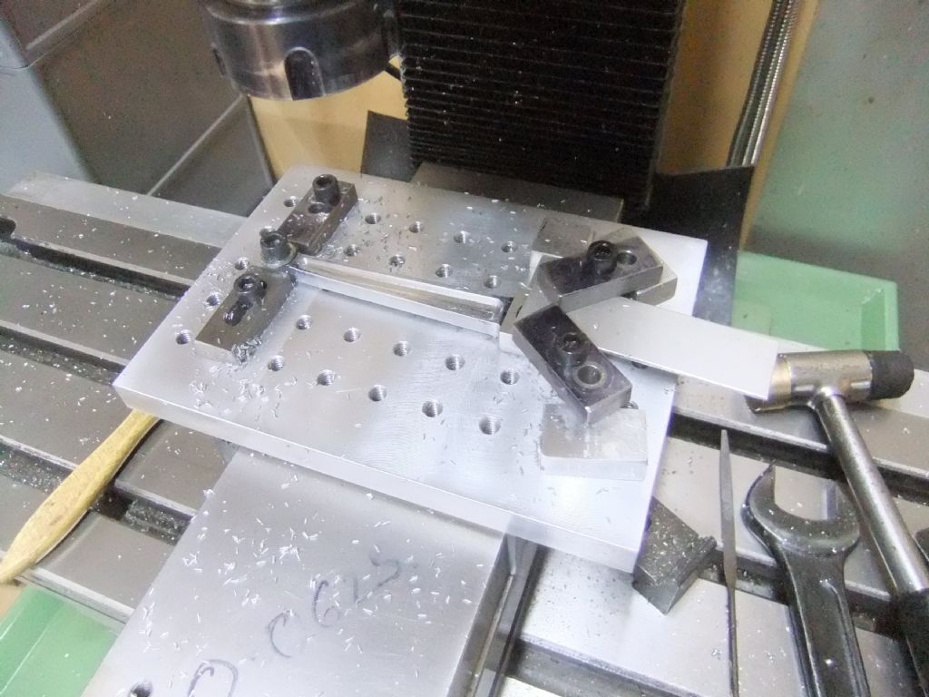

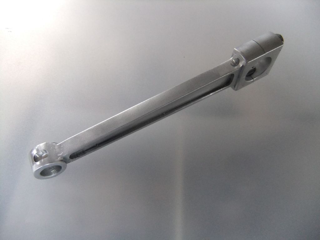

                                    Got around to getting the con rod complete first part was to mount it on the platter that I made and set it up to mill out the recess I had to do this 4 times total because of the taper.
                                    The next up was to slim down the big end cap as it was too large. The screw that you can see in the big end is not a mistake but designed to be like that when I make the big end bearing I have to make a cut out on both sides to allow for them. Also seen is the little end bearing which is a tight fit. Final job was to make the cut out for the little end bearing oil way which can be seen in the second photo along with the oil hole for the big end.

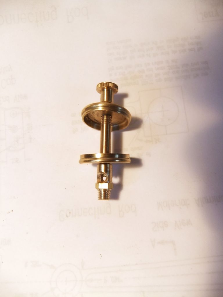

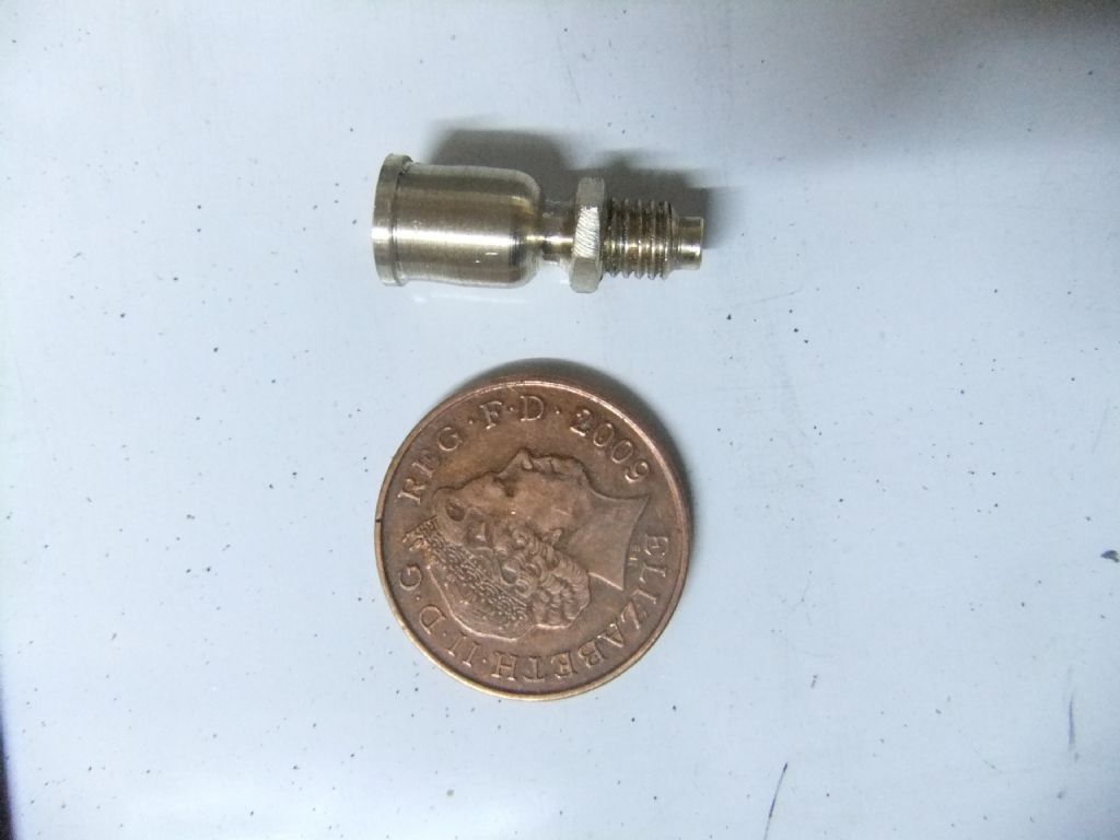

                                            #660816
                                            Dalboy
                                              @dalboy

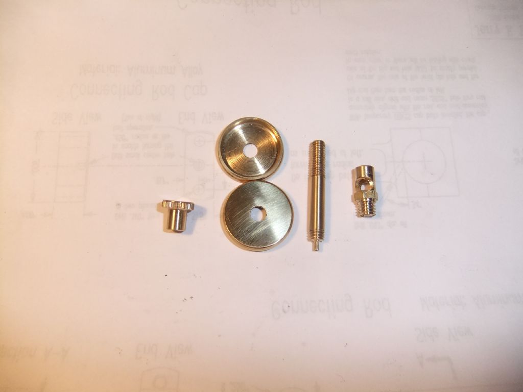

                                              Took a break from the main components today and made a start on the main oiler for the engine as I had some test tubes arrive for some single flower pots I will be turning from wood, before I do them I needed a small length of one of them for the oiler.
                                              Most of this is from brass the first photo is a part assembled oiler. There needs to be a control needle and a sprung piece to stop it turning as well as a nut and obviously the glass.
                                              This photo is the parts made so far except those which need to be made as above.
                                              I am enjoying working with brass. The two discs which form the top and bottom of the oiler are just over 3/4" diameter to give an idea of the size
                                              I also prepared some bronze for the big end bearing no photos

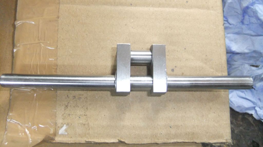

                                                  Dalboy
                                                    @dalboy

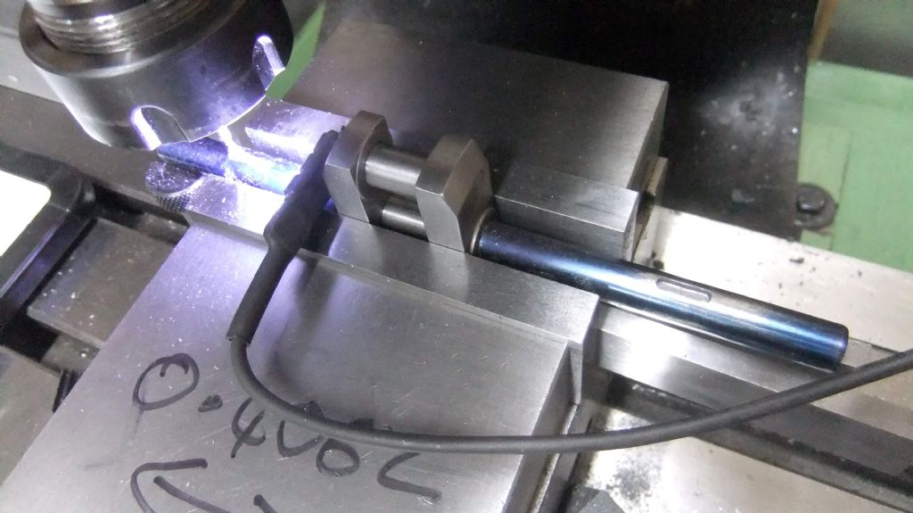

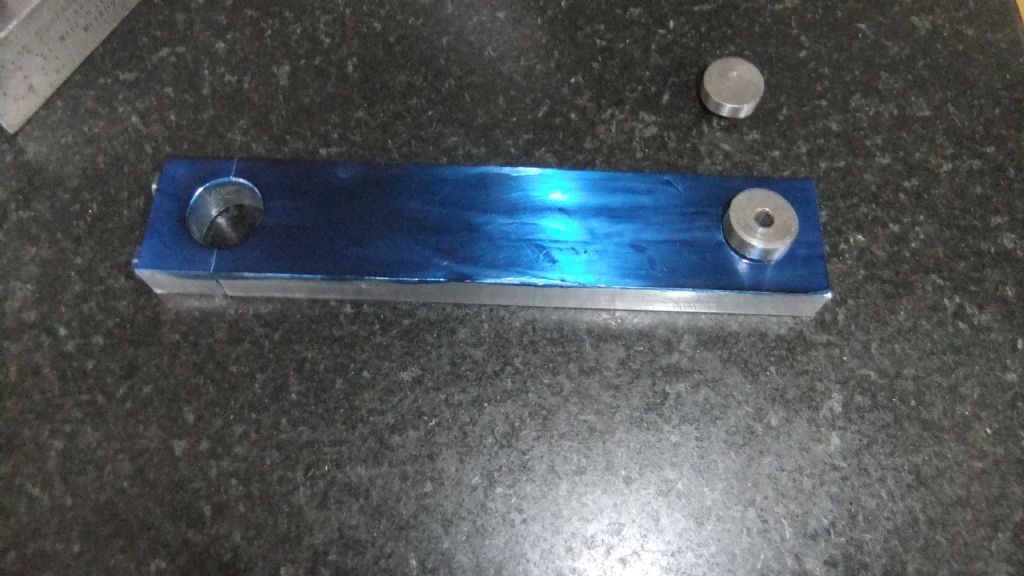

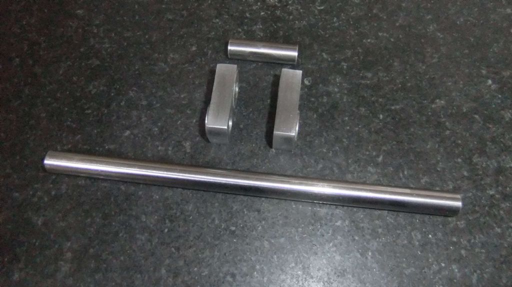

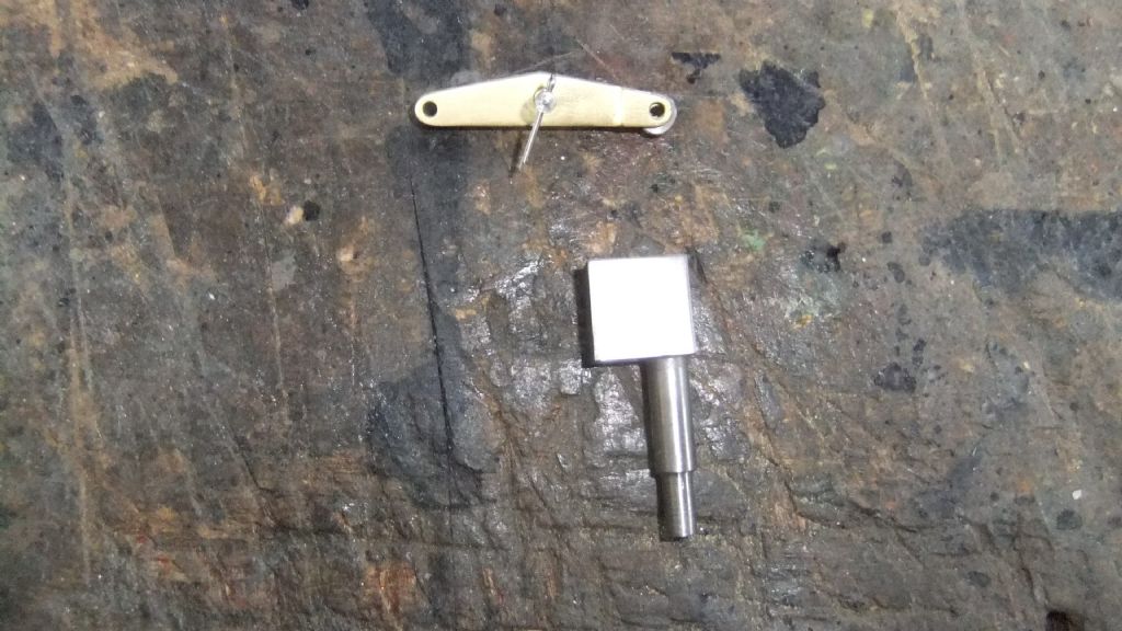

                                                    Been busy with the last part of the con rod and that is a bronze big end split bearing. The small dots are there to make sure that when it is taken apart to assemble the complete model they stay in the correct orientation
                                                    Then it is onto the crankshaft assembly, the plans show it mad from a single piece of steel but I have decided to make it up from two small pieces and some silver steel.
                                                    First was to make the two webs made easy by the use of a small home made stop which worked a treat.
                                                    Turning the raised sections as well as the curve on both ends I had to do this set up 4 times two for each piece
                                                    After the part being deburred I am pleased with the result

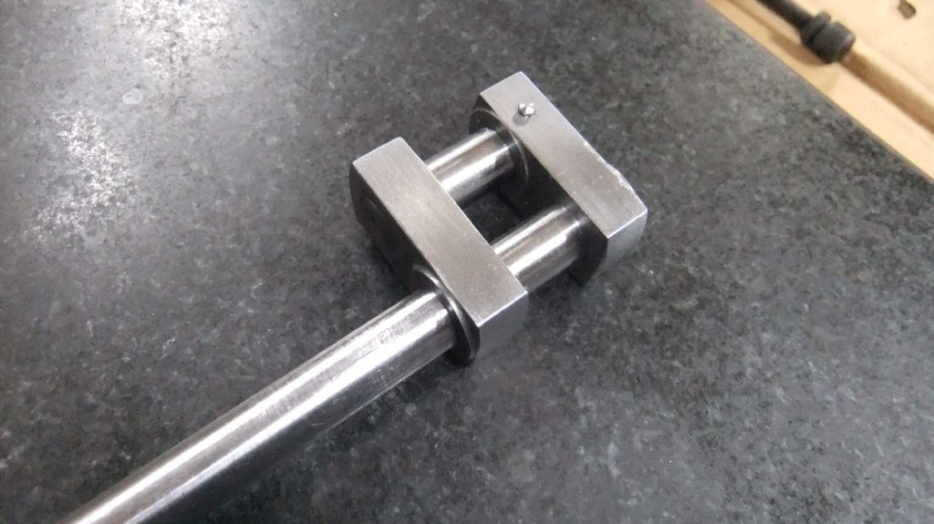

                                                    All the parts for the crank shaft assembly
                                                    A dry fit to check everything was in line. I have left the main shaft in one piece until it is finally fitted together. I will locktite them in and also drill for a tapered pin in each of the joins. The two pieces at the top of the photo are just machined to the correct width for the gap in the middle.
                                                    Still more to do to this once it is finally fitted together

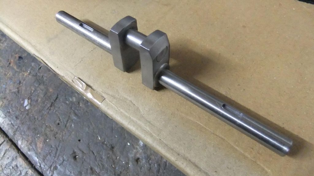

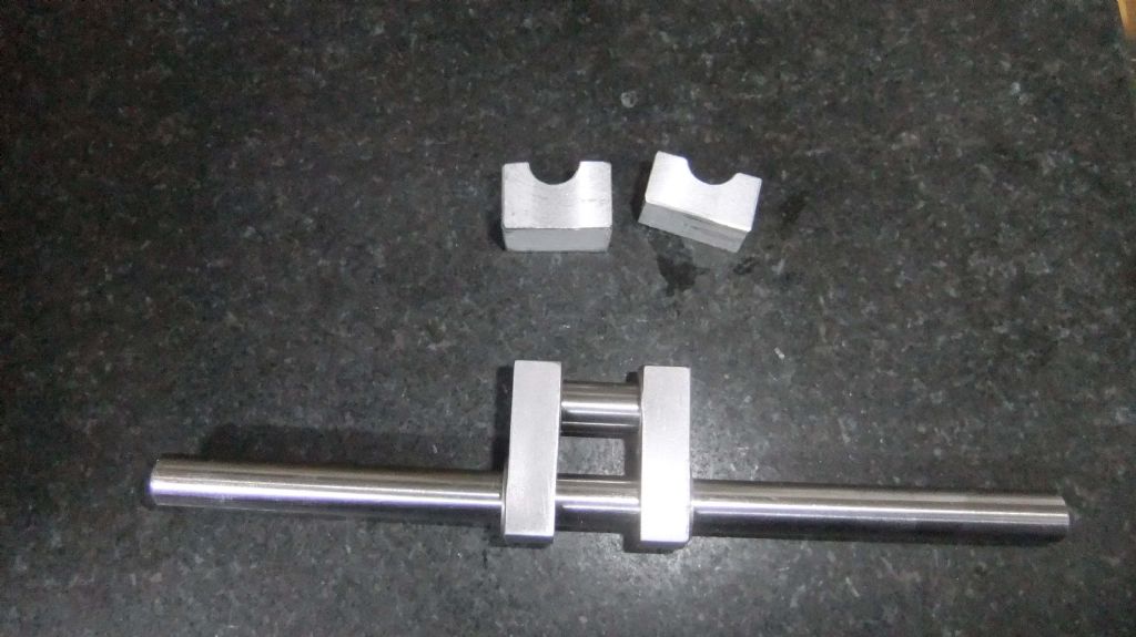

                                                    #662373
                                                    Dalboy
                                                      @dalboy
                                                      What with gardening and cooking yesterday, I always cook a special meal on a Saturday for the wife to give her a day off. Nothing got done on the engine.
                                                      Today started a lot better so I took my time as there is a lot of work to restart the crankshaft if I mess up.
                                                      Drilled and pined the second conrod bearing and cleaned that up and as can be seen the pins disappeared
                                                      The main shaft was loctited in at the correct spacings before drilling and taper reaming for the tappered pins as I did with the first shaft once again cleaned up and no sign that they have been pinned. I don't want it coming apart
                                                      The job I was not looking forward to is machining two 1/8" keyways the longest one is 1/2" long This was done using a 3/32" slotting cutter so was very slow as too much pressure on that would snap it like a twig. This meant that I had to machine down the centre and then widen it with a cut down each side
                                                      Final job was to cut and machine away the main shaft that passed between the two crank webs. At least that is the crankshaft completed
