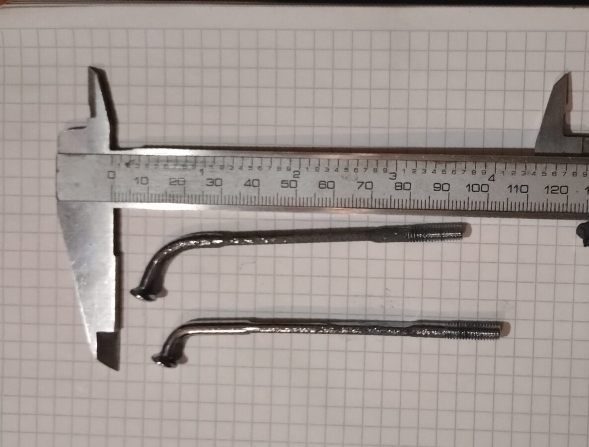

                                  Got my wheel back yesterday, life is better with fresh rubber and a good set of spokes. Here’s the old spokes:
                                  They are 4mm thick with M4.5 threads, appr 90mm long. Notice the forged flat section, 2.6mm thick and 40mm long. Also there are 56 of them. So far I haven’t seen any spoke maker offer anything similar on their pages, so next is to start sending emails. Any suggestions to where I should start?

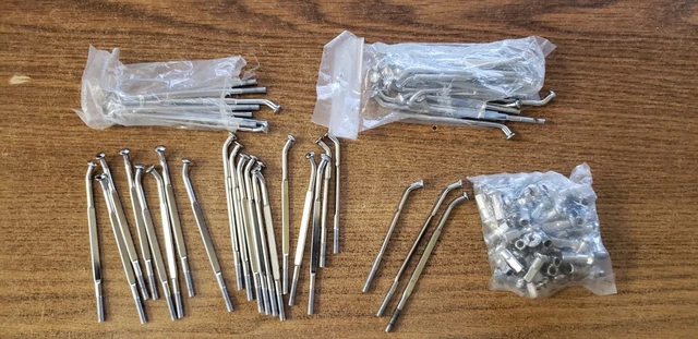

                                    #807418
                                    Fulmen
                                      @fulmen
                                      Thanks but they can only deliver butted spokes. I don’t know if strength will be an issue with those?

                                      Vic
                                        @vic
                                        #807470
                                        Fulmen
                                          @fulmen
                                          Cool. But if it’s as good as this I’ll pass
