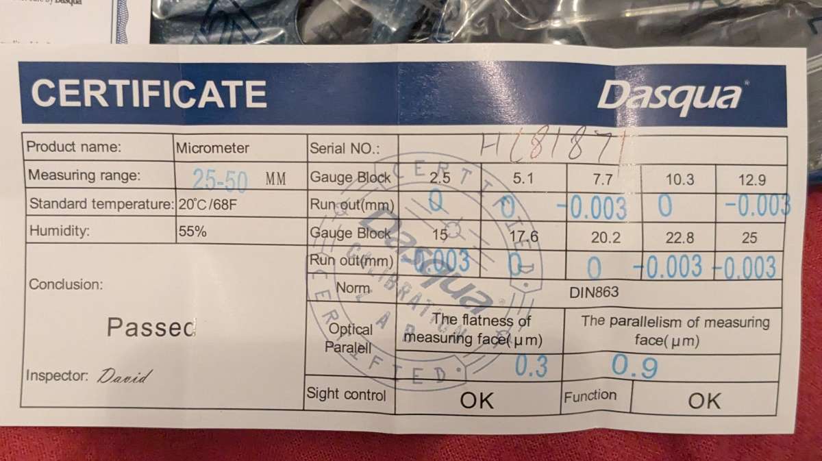

      First of all this not a complaint about the supplier or even really Dasqua.
      I just bought a Dasqua 25-50 mm outside digtal micrometer from one of the usual UK suppliers. Overall pleased with the micrometer. It’s not a Mitutoyo but it’a a third of the price.  In the package with the instructions was a calibration certificate.
      Cal-cert-1

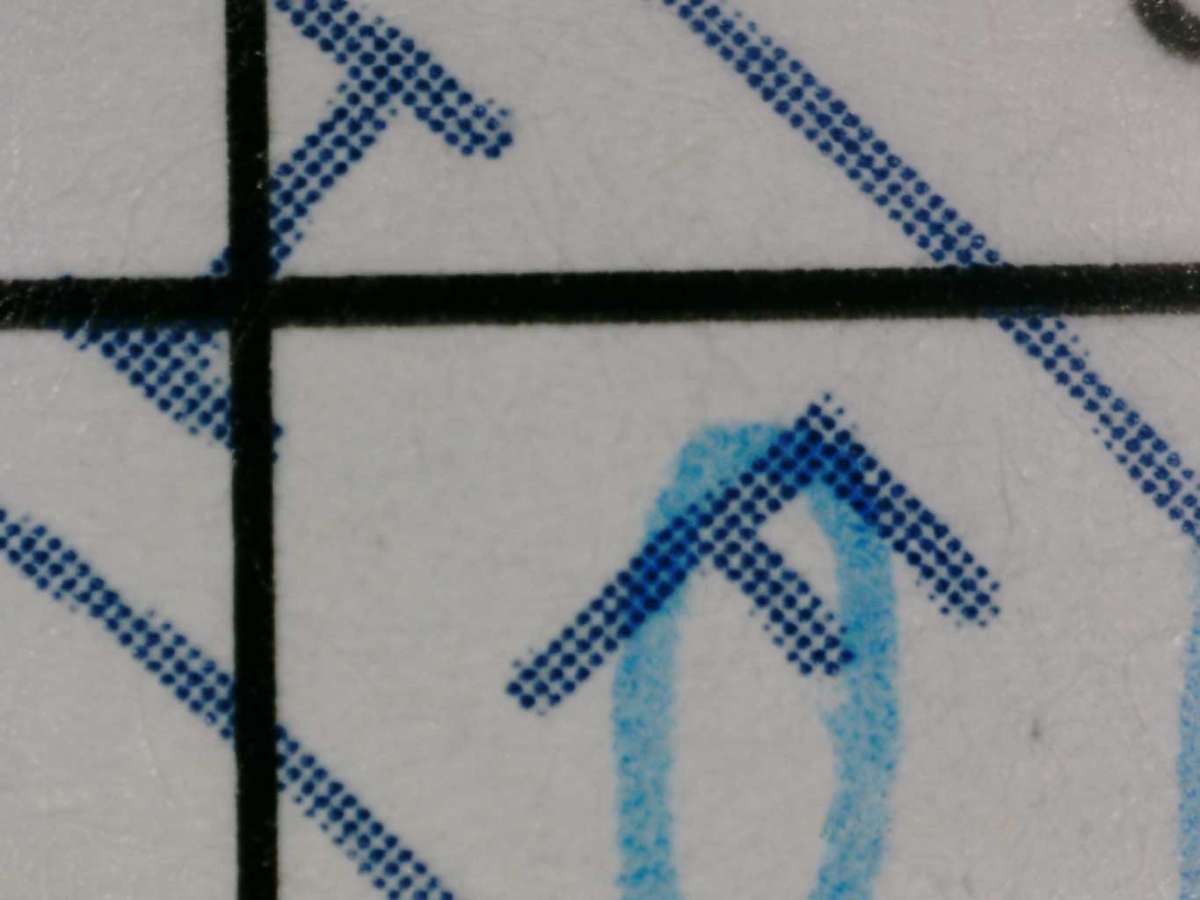

      I’m used to looking at calibration certificates and this one did not look or feel (literally) right. Closer examination revealed that the the measured values and claibration “stamp” are halftone printed.
      Cal-cert-2
      Now it’s possible the measurements might be ink jet printed but the font looks like a mechanical type. There is no bleed you would get from inkjet or impression from typing. Also if the calibration values are typed or printed on a blank form why is the serial number hand written in pencil. This is pencil, it’s impressed and there was graphite dust I could wipe off.
      Even more telling is how do you calibrate a 25 to 50mm micrometer with 2.5 to 25 mm gauge blocks
      I’ve seen this before with electronic measuring instruments from the far east. You buy several items and they all have identical errors…
      None of this really matters to hobbyists but if you are an organisation with any sort of quality system or approval it could catch you out.
      I’m not suggesting that the micrometer does not meet it’s specification.Mainly because it doesn’t seem to have one other than “Strictly made in accordance with DIN863” which implies +_ 4 um. Just making some awareness.
      Robert.
      #825889
        Could they be rubber stamped, that would give a half tone
            Hi Jason,
            I’ve never seen a half tone rubber stamp. Is this a new thing? I’d have thought the stamp pressure would have flattened any half tone “bumps”.
            B.T.W I ment to put a question mark at the end of the title. Can you add one for me please?
            Robert

                I was looking at the individual results they look like they may have been stamped, the big circular one is printed

                  I forgot to say, the other discrepancy is no date.
                  Robert.

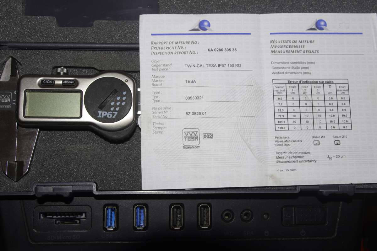

                      I have several Dasqua products and they are all better than average quality. I had always suspected that they were not made in Italy because of the price, but it shows that China can make good stuff if they want to. I cannot comment on the certificate as all my Dasquas are at the museum, but I do have my Tesa at home and it has a certificate which has no date on it, but does have the part number and serial number.

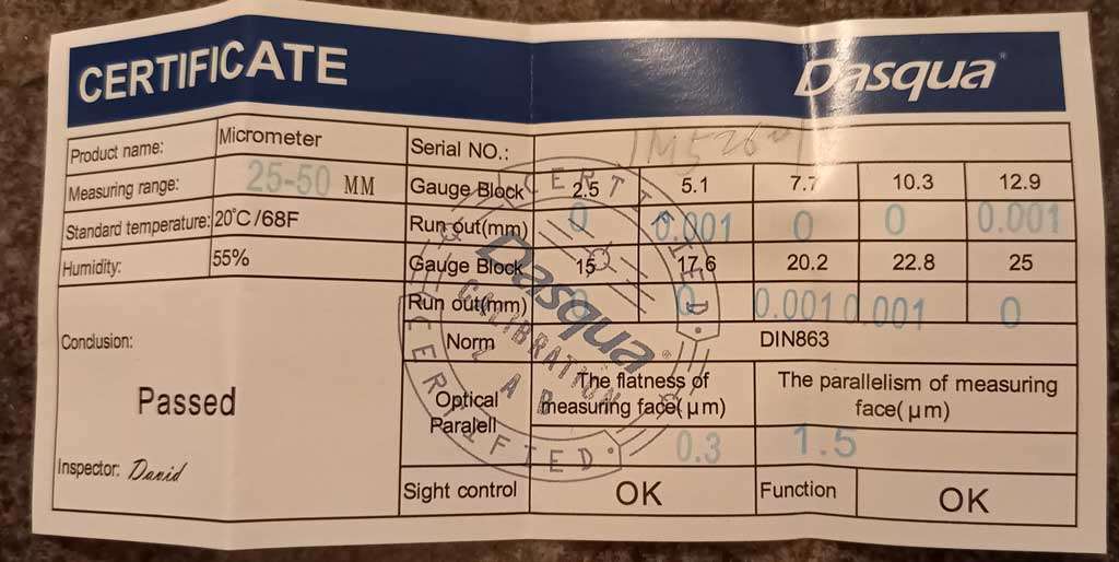

                                  I got a Dasqua 25-50mm outside micrometer for Christmas. Here’s the calibration certificate.
                                  The figures are at least different.

                                    You would expect the measurements and the serial number to be written, not printed. If the results would be entered in a data sheet, than the serial number would also be entered in the same data sheet. So the probability this is fake is pretty high.
                                    My Mitutoyo calibration reports seems authentic.
                                    None of the Chinese reports that came with my tools or machines are somehow trust worthy.
                                    The “test record” of my German Paulimot F207-V milling machine is, based on the measurements (none of the 12 measurement ends on a 0,2,3,4,7 or 9), authentic with a  0.05% probability. The results do not match the actual machine state and the report is 100% printed. That combined it is likely a fake document.

                                      Hi, I don’t know for sure, but it could be the certificate is printed automatically, and the tester signs it once the test has finished.
