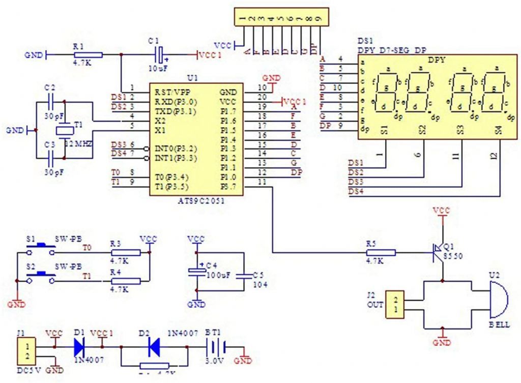

      Problem is … it doesn’t work, and I have no idea how to fault-find the circuit: Constructionally, it’s very simple, but there is no description of how it works.
      The big IC is actually an Atmel AT89C2051 microcontroller, although the board is labelled for STC12C2052 dont know … are they interchangeable ?
      There is no information, but I had assumed it to be supplied pre-programmed.
      The same kit appears to be listed on Amazon and Alibaba, both of which show this [inaccurate because J2 is not on the board] diagram:

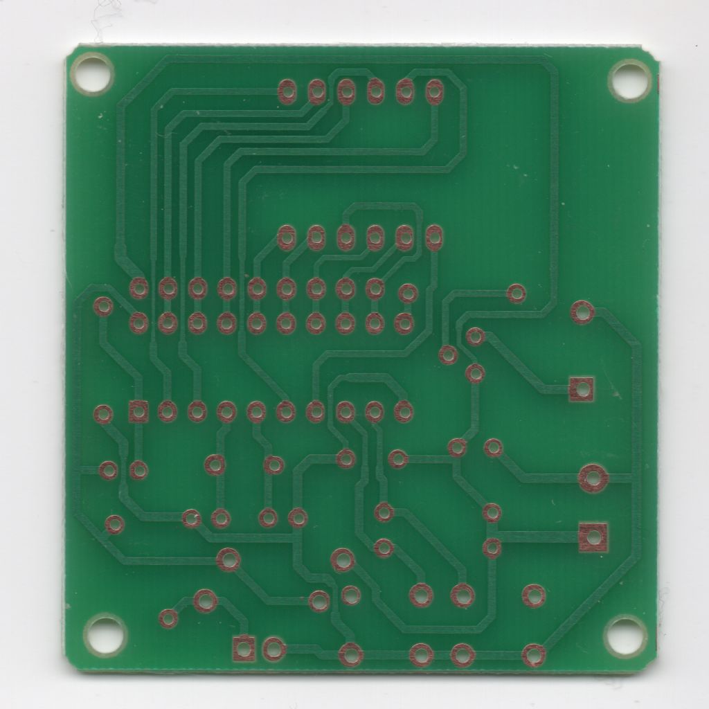

      Here are scans of the circuit board [with the track-side horizontally flipped for convenience]
      Does anyone recognise it ?
      … or have any idea where I should start fault-finding
      … or any useful suggestions as to what I might do with salvageable parts ?

            Bit of a poor design inthe way it drives the led display, Michael. The processor sets up a 7 seg display code on the the lines A to G and then pulls one of the scan lines DS1 thru DS4 low. So, to show the figure 8 on display 1 ( left digits), lines A-G will be set HI . Line DS1 is then pulled low and all the segment LEDs will glow.. If DS2 is also pulled low, Display digit two will glow, etc.
            What makes the design poor is that when powered from 5V, the 7seg leds will have about 4 to 4.5V across them, with a large current flow, all sourced by the processor output pins – not good for the processor at all!
            I see when running from battery the supply V=3V, much better!
            If the processor is not working , it will not be scanning the A-G lines at all. I presume you do not have an oscilloscope? If you do, check the A-G and DS1-DS4 lines – there should be pulse trains on them.
            If no 'scope, just short one of the DS lines to ground – if the processor is scanning the A-G lines, a 7seg display will remain on during the short – this 'should' not damage the processor, as the DSx outputs are normally pulsed low and then go hi-impedance to not activate that display – They may however drive the output HI rather than hi impedance, so..
            A neater way is to take a red led ( lower on voltage) and connect the cathode to ground, and the anode to each A-G line in turn – you should see it glow if the lines are being driven.
            If not, there are two probable causes – The processor is not programmed, or the oscillator is not..To see if it is oscillating, first check carefully around the crystal, the two capacitors C2 and C3 ( are they really 30pf – can you see any markings?)
            If visual is good, do you have a short wave radio? Set the dial to around 12MHz, and bring a wire from its antenna socket and touch the crystal metal can – tune around the 12MHz range till you detect the frequency – it should be very strong…
            Let me know

                The 2051 and 2052 appear to be pin compatible and both support the same instructions. The 2052 looks to be a bit faster and have a couple of extra timers, but those features are unlikely to be needed on a simple digital clock.
                The circuit is very simple; most of the clock is implemented by a program running on the chip. The chip should be pre-programmed : unlikely it went wrong, but possible.
                Reading the reviews I see a few people complain about board quality – tracks lifting off with heat, and broken tracks that had to be bridged. Check the tracks carefully with the microscope and for continuity with a multimeter, or – much better an oscilloscope, see below.
                Apart from Frances' advice# about maybe testing the display by jumpering, I think debugging needs an oscilloscope. If you've got one, should be possible to see:
                • 12MHz continuously on both crystal pins, proving the oscillator is running. Or listen to it on a Short Wave receiver (another expensive toy you deserve!)
                • 5V between Vcc and Gnd. If the chip has no power, nothing will work because the display is powered by the chip.
                • Activity between Gnd and all the other pins, square waves changing from 0 to +5V. The display is multiplexed by pulling DS1, DS2, DS3 and DS4 to ground, or by putting 5V on them, in sequence, above eye flicker frequency. Which way round depends on whether the display is common cathode or common anode. The segments draw digits by putting power on A,B,C.D,E,F & G selectively. Which segments are active depends on the digit being displayed. An '8' does all of them, while '1' only lights up b and c. The final digit of HH:MM will change fastest.
                • T0 and T1 should both be high until a button is pressed. If the chip has power and the oscillator is running, either of these switches stuck down at zero volts might cause the program to hang.
                • RST should pulse once up to 5V when the clock is powered on and almost instantly subside to zero. Normally it should be zero. The pulse is important because it restarts the computer after the power supply has stabilised. If RST isn't pulsed the chip won't start the clock program correctly at the beginning and it probably won't work at all. The RST pin has a 10uF and 4k7 resistor connected which is correct for a go-faster 2052, but may not be right for a 2051. The 2051 example circuit I found simply connects 10nF between Vcc and RST : might be worth trying if all else fails.

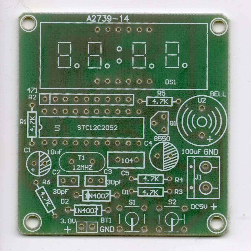

                                        O.K. … This might turn out to be embarrassing blush
                                        I’ve just realised that I paid no attention to which way round I was inserting R2
                                        This is a resistor array [8 resistors and 9 pins] and the one for the one in the other kit is clearly marked
                                        • A471J
                                        That dot, I now realise, should be at the left side of the board.
                                        There is a 50:50 chance that it’s reversed.
                                        R2 is now hiding in the narrow slot between the U1 socket and the DS1 display … so I will need to check with a meter. … A little job for tomorrow morning !

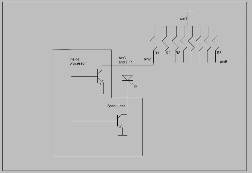

                                                    Doubt that R2 orientation is seen by the processor at all..
                                                    here is a crude representation of whats going on –
                                                    The processor drives open collector ( probably FETs, so open drain, but irrelevant here) transistor as shown. eight drive the A-G and D.P. segments of the displays.

                                                    having looked more carefully at your schematic there is a qick test to see if the segment glow at all..will explain shortly.
                                                    So, assume VCC at pin 1 of the resistor network, ie, assume the network is inserted correctly..
                                                    Then current will flow down R1 (diagram below) through the 7 segment LED, IF the scan line transistor is on.
                                                    So, to turn on Segment 1 of display 1 ( say), as below, the A-G line transistor ( top one) must be OFF, and the scan line transistor ( bottom one) must be ON.
                                                    to turn a segment OFF, the processor will drive the top transistor ON, which pulls the the LED/R2 network pin to GND, so no current available to flow through the LED, so no glow.
                                                    Now, if you connected VCC to pin 9 instead of pin 1, then current still flows down R1, through the segment LED and the bottom transistor, BUT, it gets there via R8. Since R1 thru R8 are equal values ( 470ohm), half the current now will flow through the led, so half as bright. No other effects at all..
                                                    Now the test –
                                                    Remove the processor from the socket, power the board, and with a wire jumper, short one of the DS lines to GND. That should light up ALL the segment of one of the digits. Repeat for the others. You van see how that works – current can flow through all the segments since the top transistor is OFF ( missing), so shorting the DS1-4 line to GND provides the current flow path.
                                                    If NO segments glow, the display is faulty, or as I have had before, its a common anode instead of common cathode device…

                                                      Have you checked S1 and S2 are correctly inserted? If those switches are inserted 90° out, the switch inside is bypassed, and the circuit is permanently ON.
                                                      The operating instructions explain the program goes into menu mode by a detecting a long press on S1. If S1 is stuck in a permanent long press due to the component being physically rotated, the computer may be waiting for it to be released. As the long press never ends because the switch is shorted, could well be the program doesn't get to move on to a stage where something is displayed.
                                                      T0 should be +5 when unpressed and 0V when pressed. If T0 or T1 is permanently 0V, suspect the switches.
