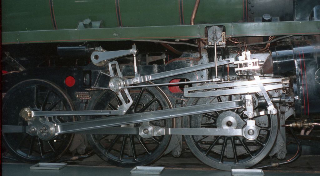

                      Hi, the photo below shows the first three coupled wheels of the Evening Star displayed in the National Railway Museum in York in 1993. Through the spokes of the middle wheel of the three, can be seen the horn quite clearly on the outside of the frame and it looks to me that it is in fact riveted on. I do not know if there is any part of this horn or a pair to this horn on the inside of the frame also.
                      Regards Nick.

                      julian atkins
                        @julianatkins58923
                        hi nick,
                        thanks for the excellent pic!
                        brian is correct in that the horns are centred over the frames although fitted from the outside as stan states. this is copied from the Bulleid Pacifics.
                        hi albert, when you get to the boiler be very careful about the throatplate as LBSC specified a sif bronze welded joint here, as butt joint to the barrel. my own preference would be a double flanged throatplate. also ditch the stainless piston valve bobbins and make them out of hard drawn bronze. there is an awful lot of 'new' stuff on piston valve bobbins and liner passage shape cut outs that is far in advance of LBSC's practice.
