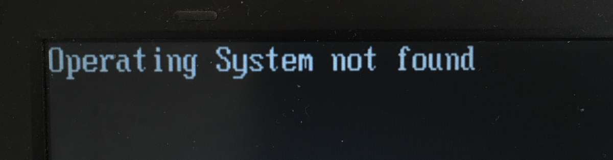

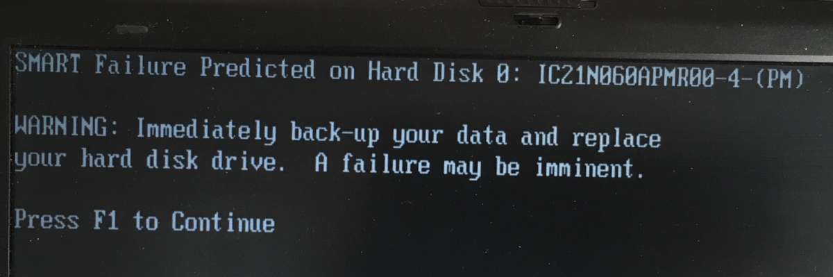

      My ancient, and rather lovely, Sony vaio VGN-B1XP laptop just produced this:
      IMG_0896
      so, I pressed F1
      IMG_0897
      #807186
        Removed one screw and slid-out the hard-drive
        popped it back-in and rebooted
        Good as ever !

          Clive Brown 1
            @clivebrown1
            When the hardware Self Monitoring Analysis Reporting Technology wakes up, there is probably some damage to the disc. You may be fortunate and it keeps working a good while longer, but it’s not “as good as ever”. Critical failure is a possibility.

                      #807282
                        On Clive Brown 1 Said:
                        […] but it’s not “as good as ever”. Critical failure is a possibility.
                        Apologies for being flippant, Clive
                        I am 76 years old, and have had that vaio for more than half my life
                        Critical failure is always a possibility … vita brevis
                        The main point of this topic was to share the irony of those two error messages
