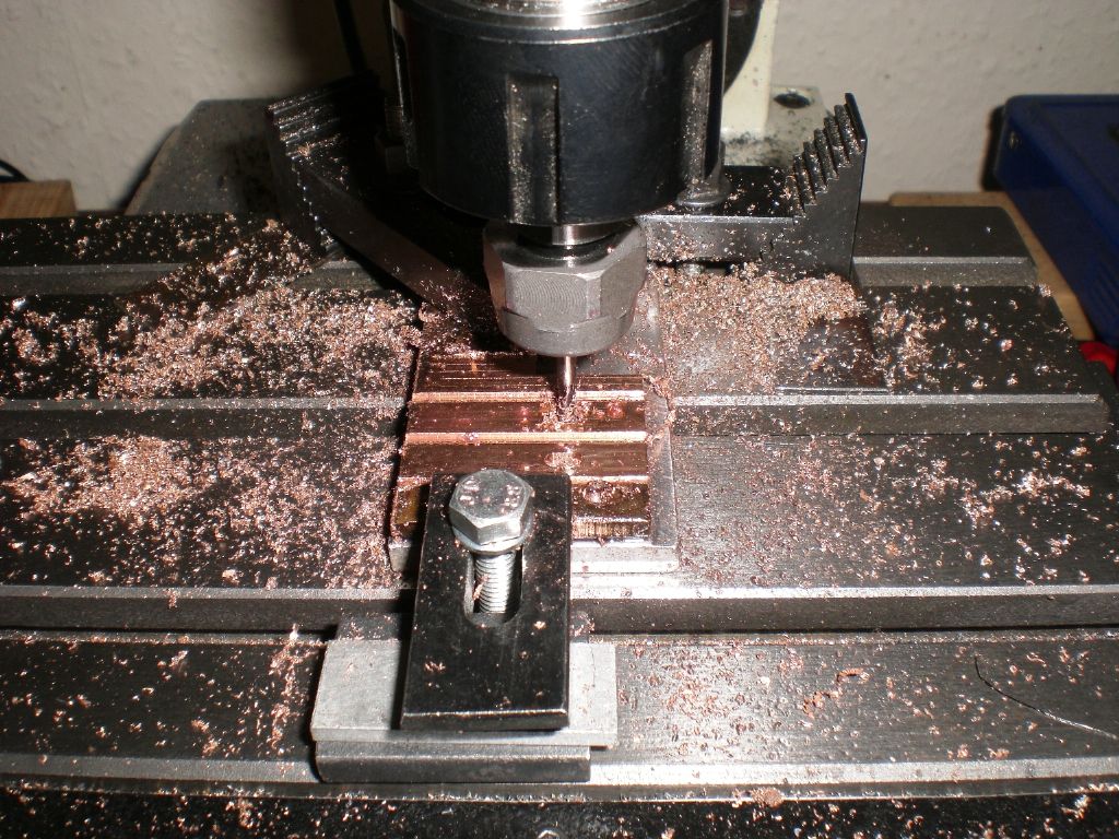

                    Hi Bo'sun, my ER32 collection of collets only go down to 6mm, I use one of these ER11 collet chuck gripped in a 16mm collet to do smaller stuff and these collets are about 18mm long, although my 6mm ER32 collet has only 23mm that actually does the gripping. These collet chucks also give me much more room and easier to see where the tool is, when holding small cutters on my mini mill.
                    Here's an example of how much easier I find it using a ER11 collet chuck with a small cutter, on my mini mill, the ER11 is held in my normal collect chuck that is used on this mill.
                    Regards Nick.
                    Edited By Nicholas Farr on 31/03/2021 08:01:03

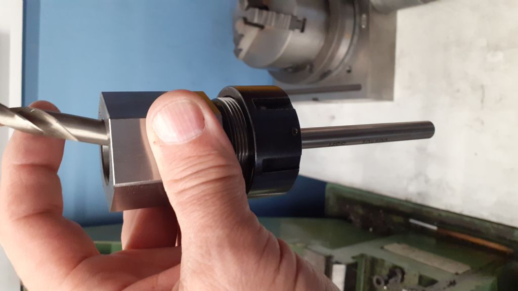

                          As Tony says in practice the back of the collet just collapses. For anyone in doubt you can try this at home.
                          10mm collet, 10mm HSS blank inserted 3mm into collet and just nipped up by hand no spanners, that is a 9.4mm drill sticking out the top which won't enter the back of the collet.
                          Edited By JasonB on 31/03/2021 09:18:36
