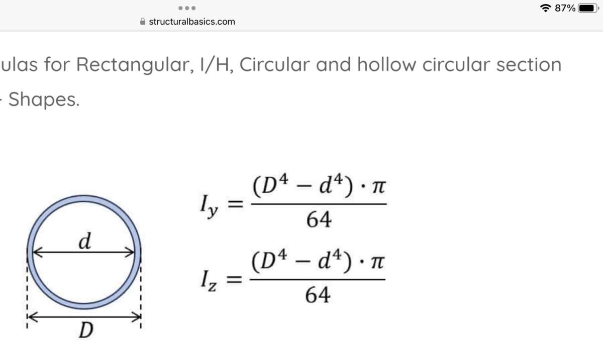

On further reflection of the lower rigidity of a sleeved item, if either the sleeve or the inner item were of a stiffer (higher E-value) material than the solid original, the bending stiffness could be increased over that of a homogonous solid item.
The crux of the matter is the behaviour of the connection between the two, which is still a mystery.
