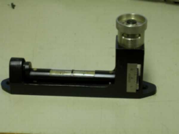

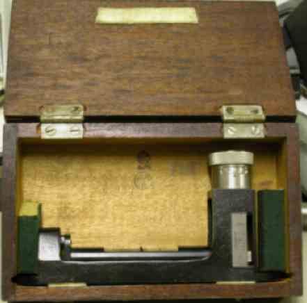

                    A level of that sensitivity will drive you nuts! Typically machinists precision levels have a nominal half a thou per foot sensitivity, around 10 seconds of arc, per division. The one in question claims 0.02 mm per metre sensitivity which is the same for all practical purposes bearing in mind that a level is a null indicator not a measuring instrument so the calibration is anything but exact.
                    Complete waste of money.
                    At this sort of sensitivity the bubble will twitch if you so much as breathe wrong and it will take pretty much for ever to bring the machine close enough to level to get the bubble visible anyway. To be of any use the base needs to be very accurate to at least an order of magnitude better than the level sensitivity. Usually inaccurate bases turn out to be convex so the thing rocks making it useless. Correction is possible but not for nomal mortals lacking high level scraping skills. Its implied that the thing is not properly set up so you will need to set it to level first. Not easy and a monstrously frustrating task. Yup! I've done it. Once!
                    In my view the best all round instrument for this sort of thing is the once common WW2 era vintage 6 inch (nominal) base gunnery clinometer featuring a 30 second of arc vial and a nice adjusting system covering a few degrees scaled to 1 minute accuracy. That is a measuring instrument and supremely easy to use. Couple of pictures, not very good I'm afraid, of mine.
                    Clive
