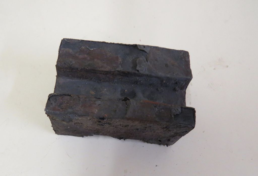

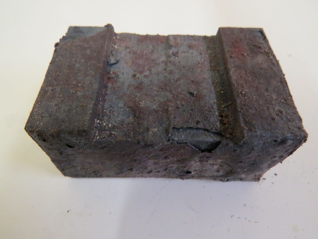

                            Ooooh errrr! I had chance yesterday for shed time, so lite the fire in the shed stove, got it going well on smoke-less, chucked the tool holder with the hard bit in, threw some more coal on top, saw it a wee while later all – including the metal – very much glowing nicely (very) red and left it to burn through and cool down overnight. This morning I pulled the metal bit out the ashes and; Oh my word, I didn't expect this: – see photos below.
                            I chipped all the scale off and revealed what could be expected – the metal underneath was very rough. Set it up in the mill and tried a facing cut off one side with a flycutter and promptly blunted it, so, unwilling to sacrifice another milling cutter it now looks like I have another useful door stop. Another item now on the next metals order!

                              Might be a silly question, but here goes. To carburise something you bury it in carbon (kasenit, button dust, sugar etc) get it red hot and keep it there whilst the carbon diffuses into the surface layer. To anneal something in your coal burning stove you cover it in carbon and get it red hot……… See where I'm coming from?

                                Yes Duncan, that did occur to me after, and not a silly question. Perhaps it might have worked if I had covered it in SS shim, which I have, before placing in the coals, or if I'd been able to fabricate some means of holding it above the coal. That process not thought through before I went for it!
                                Both alternatives have given me fuel for thought for the future though. What it has proved is that in my stove I can heat a really considerable lump of metal up to red hot glowing temperatures and hold it for a while, hours, if necessary, which I didn't think I could do, so that is progress in one direction. I had sort of given up on the lump anyway really. Now I know I can do it, the next stage is refining the process to get it to work for me, whether either annealing or case hardening. Wrapping an item in SS shim packed with carbon of whatever extraction and 'cooking' it in the fire or arranging a removable rack to place objects to be annealed or case hardened on is a reality to explore! Quite like the rack idea.
                                Had I an electric furnace all would have been easier but I don't now the money to buy one, even if I had ever seen one advertised which I haven't, like where do you scource cheap electric furnaces except perhaps ebay?

                                  Posted by ChrisH on 21/12/2017 22:16:14:Wrapping an item in SS shim packed with carbon of whatever extraction and 'cooking' it in the fire or arranging a removable rack to place objects to be annealed or case hardened on is a reality to explore! Quite like the rack idea.
                                  Chris
                                  maleable iron electrical fitting or other steel box would be the traditional approach, SS shim is too valuable, and prone to leakage to use as wrapping paper.

                                    Re the carbon comments, this is why it is always suggested to cool as slowly as possible. If it does take on carbon and you take it out the fire and quench it that is just like hardening with kasamite, leave it too cool slowly and you end up with steel in it's unhardened state.
                                    Might have been worth pickling the part to remove the abrasive scale before you tried to cut it again.

                                      Posted by duncan webster on 21/12/2017 21:15:49:
                                      The atmosphere around the latter contains significant amounts of oxygen (and nitrogen) and any carbon is presumably in the process of being oxidised, rather than trying to diffuse into the surface of the steel. Which is why the former process requires to purge and exclude external gases and maximise direct contact of carbon with the surface. The carburisation process requires temperature, time and a significant concentration of carbon on the surface of the steel. Although there are some related processes that rely on hydrocarbons etc for surface treatment, those processes tend to be very complex and challenging to implement.

                                        The use of stainless steel shim suggested itself from a video on Tom's Techniques website when he was case hardening a small part. He wrapped the small part complete with case hardening material in SS foil which he got from some craft shop/website. I couldn't seem to source it this side of the pond and thought SS shim, I have it in various sizes to 6 thou, would do (not done it yet!). You do have to fold it over and over and crimp it best as can to exclude the air, and he recommends putting in the parcel a little combustible material to deliberately burn and consume the oxygen remaining in the ss foil wrapped parcel. Not sure how thick the shim would have to be, too thick and it'd be a swine to fold and crimp air tight, too thin and I suspect it might burn away in a really hot fire.
