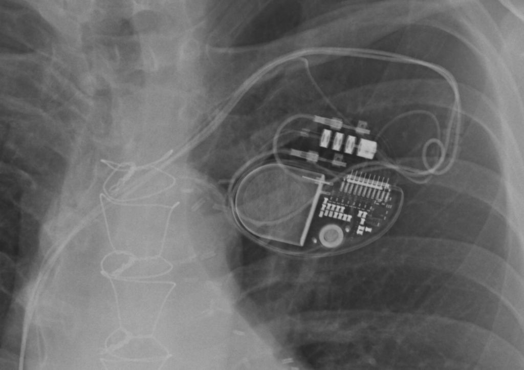

                                    Before the thread gets locked … and for no particular reason except that I am VERY pleased to have it :
                                    Here is my pacemaker
                                    It’s a 3-wire device, from St Jude, and does Cardiac Resynchronisation Therapy.
                                    A big Thank You to the NHS in general, and Wythenshawe Hospital in particular star

                                    Martin Kyte
                                      @martinkyte99762
                                      Thats a bit of a messy installation, not a single cable clip ;O)
                                      Keep with the beat Michael.
                                      regards Martin
                                            That's where, if the heart is running too fast (arrhythmia etc) they speed it up to slow it down? Mine does that – though I never notice. They do test it at the pacemaker clinic and tell me its about to happen and i can feel it (just barely) then.
                                            It's the thought of the big one (defib) that scares the bejeepers out of me.

                                              No … CRT is a little different
                                              I will post something more about it later, if the thread is still open.
                                              P.S. … We discussed the ‘defib’ option in some detail … and I declined

                                                  As promised: Here is a little more about my CRT
                                                  In early 2016, it was known that I had a ‘Left Bundle Branch Block’ … but this was considered fairly benign, and it was more important to fix the plumbing [quadruple Coronary Artery Bypass Grafts]
                                                  In late 2016 the electrical problems became significant, and they fitted a conventional 2-wire pacemaker.
                                                  In 2018, I suffered ‘Severe Heart Failure’ [the ‘volume fraction’ of pumping should be about 70%, mine had suddenly dropped to 17%] … Fortunately, fitting a 3-wire CRT device; re-using the original two, and adding the tricky third wire, worked very nicely. The basic problem was failure of the heart’s electrical system, which was causing the left and right ventricles to pump in anti-phase … so the blood was just washing between the chambers !
                                                  This page features a brilliant animation showing the problem:
                                                  https://watchlearnlive.heart.org/CVML_Mobile.php?moduleSelect=cardrt
                                                  Yes, it does refer to arrhythmia … but my device is active on over 90% of my heartbeats, so it’s really doing most of the synchronisation work.
