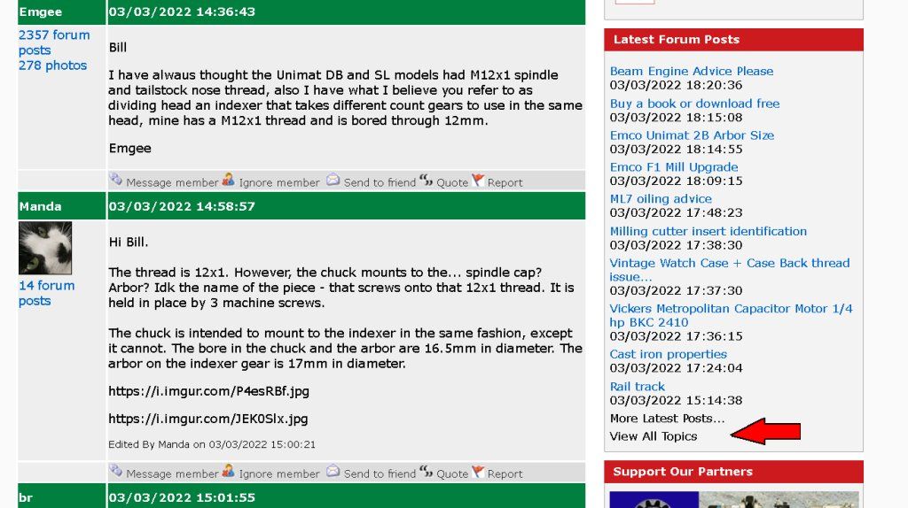

                                just look at “all threads” – box on right of screen under ‘latest posts’ and then follow to FAQs – obvious once you see and realise you have to put photos into an album then from there to insert into a post.

                                    I've used this site for years but never noticed any FAQ's. I've just tried to find 'all thread' too and failed.

                                      Ian, if you click " View All Topics " under Latest Posts you will find Website FAQ's.

                                        'View all Topics' does not appear on my screen from 'Latest Posts'. OK I'm being picky but the mention of FAQ piqued my interest.
                                        By default I set my view of the forum to 'Latest posts' and have never yet looked for post by the individual forum titles. I'd never come across the FAQ's and I suppose if the this website's own built in search does not know of their existence its unlikely they would contain anything very useful

                                          That is strange Ian, it shows up on my Firefox screen:
                                          One of the peculiarities of the Forum software?
