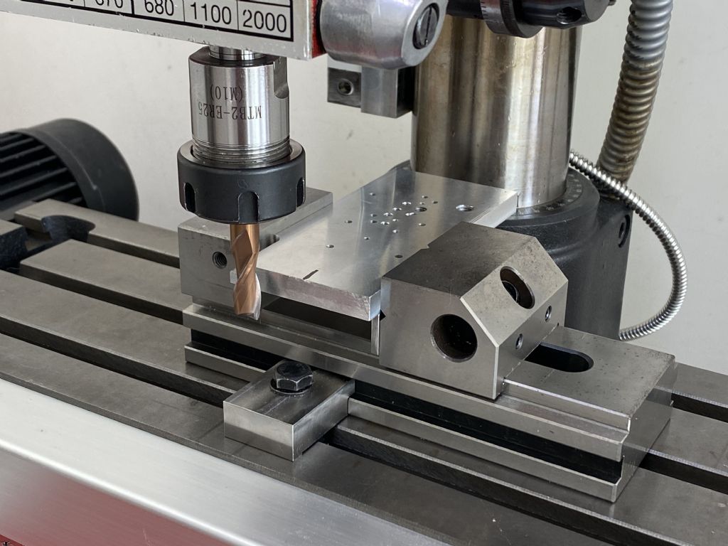

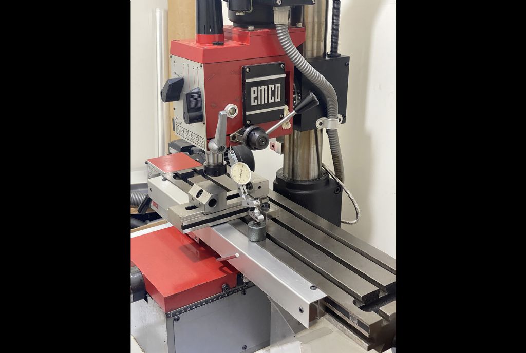

      I have problem in getting good finish when side milling with my Emco FB2 mill. I recently did a cutting test under different settings and found that the relatively poor finish occurs only if the cutting is done along the Y axis. The gibs of the table have already been readjusted so loose gibs should not be the cause. The only reason I can think of is the poorer rigidity of the head which is expected to flex / oscillate more along the X axis. Would like to hear you guy's opinions
      Details :
      machine : Emco FB2 bench mill, weight about 300 lbs
      workpiece material : 6061 aluminium
      tool : Carbide end mill 10 mm diameter, run out measured next to the collet face = 0.01 mm TIR
      spindle speed : 2000 rpm
      feed speed : 65mm / min power feed ( along the X axis ) , about 80 mm / min manual feed ( along the Y axis )
      depth of cut : 0.1 mm ( finishing )
      length of cut : 9 mm
      conventional cut
      all axes with no motions including the quill locked
      cutting fluid used ( Rocol )
      set up shown in picture 2
      surface finish comparison shown in picture 3.
      Typical finish of side milling along the Y axis :
      https://www.hobby-machinist.com/attachments/p1060758-jpg.391089/
      Test cut set up ( milling along the X axis ):
      https://www.hobby-machinist.com/attachments/img_6365-jpg.391335/
      Test cut results :
      https://www.hobby-machinist.com/attachments/3_28-jpg.391342/

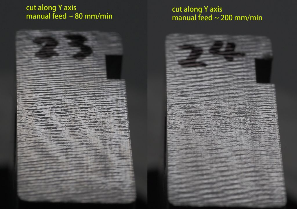

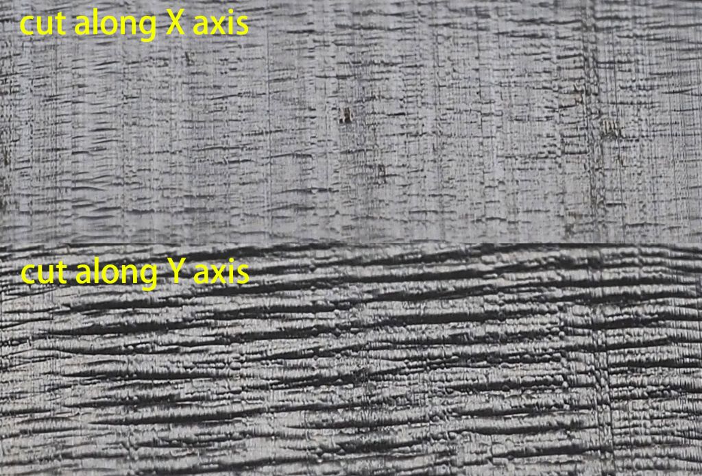

            Thanks for the reply. I have created an album and the photos can be viewed here :
            **LINK**
            https://www.model-engineer.co.uk/wp-content/uploads/sites/4/images/member_albums/111244/902861.jpg
            Difference in finish. X axis vs Y axis :
            https://www.model-engineer.co.uk/wp-content/uploads/sites/4/images/member_albums/111244/902862.jpg
            The sound is the same when cutting along the X axis ( good finsh ) and Y axis ( bad finish ). There is not any chattering sound although the finsh may indicate some chattering is happening when cutting along the Y axis.
            Yes, I have tried increasing the feed speed from about 80 mm/min to 200 ( manually done so it's just a rough indication ) and the result is just the same. Comparison :
            https://www.model-engineer.co.uk/wp-content/uploads/sites/4/images/member_albums/111244/902866.jpg
            The quill taper is in very good condition I would say. I have got a Big-Kaiser boring head with a tang-end taper and it never dropped out by itself. I bought the mill new some 25 years ago and never used it much until now. This is just a hobby-grade machine so I do not expect a lot from it. What puzzles me is why the finish of side milling is so different for the X and Y axes. I have asked about this in the hobby machinist forum. The guys there have no clues and referred me to this forum for assistance.

                        I used to suffer with this problem many years ago when I first had the first of my FB 2's.
                        The finish using the side of the endmill in the X-Axis was always perfect. However when using the same cutter on the Y-Axis it was a different story.
                        Holding the machined face at different angles to catch the light would show striations along the face. Aluminium was particularly bad at this, but steel being better.
                        First thoughts were the Gib being loose on the Y-Axis, but this adjustment met with my satisfaction.
                        I finally traced the problem to the actual cutters being used. These were made by Osborn, so a good make. However the cutting angle on the side of the Osborn cutter was 5 degrees. Changing this to 7 degrees totally removed the problem. The cutters also cut with less effort. The downside is the cutter life is less when compared to the 5 degree. As I sharpen my own cutters this is not a problem for me.
                        I have found the Helix angle of the cutter also influences this problem. Some straight flute cutters I have do not show any signs of this problem.

                            Thanks for all the replies. Really appreciate it. Gray's reply suggests that this can be a common problem of FB2s. Glad that the problem can be solved / alleviated by changing cutters. I will explore further in that direction. May be trying out 3 fluters designed for cutting alumnium ( no coating , rake angle may be larger as well )
                            I have subsequently done further checking as suggested by Joe and Kiwi Bloke. The set up is shown in this photo
                            With all the axes locked except for the Y axis. I pushed the table at the right and left sides with all the muscles I have got and the indicator reading only changed by about 0.003 mm.
                            However, when I pushed the mill head with relatively little force. the change in dial reading was 0.015mm, a lot larger. Checked all the six screws mouting the column to the base, all are super tight. Then I followed Joe's suggestion to loosen the two set screws on the column slide. Doing so is to take out any excessive play between the slide and the column. This was confirmed by the fact that I could not move the slide even if the Z-axis locking level was loosen. With this done and the Z axis locked up again, the sideway movement of the head upon being pushed was just reduced very slightly to about 0.012 mm. Then I did a test cut and the finish was just the same, ie, still bad.
                            Can it be concluded that the bad finish when cutting along the Y axis is due to the poor rigidity of the head along the X axis ?

                                I think when you are cutting along the Y axis the force vectors on the cutter are acting approximately towards or away from the column centre so rotational forces on the head are unlikely to cause any rotational deflection as they are small. When you are doing the cut along the X axis the force vectors are well away from the column centre line so there is more likelyhood of the head and the column twisting under the forces. Even though the movement is small it could be enough to cause issues as it is significant compared to the cutting depth. Personally I have never cut an edge along the X axis because I have never needed to so I don't know if what you have got is typical of these machines.
                                Martin C
                                #579422
                                DiogenesII
                                  @diogenesii
                                  Nothing to add, other than that in your final photo with the vice arranged to cut in Y, the clamps look as if they are too far back, there will be a tendency for the work to 'bounce', because the vice is free to lift at the 'operator-end'.
                                  The clamps ideally need to be central to the part being machined, or better still, supplemented with another pair closer to the front of the table.
                                  I've taken the liberty of posting the photo, for which I hope you will forgive me, I felt it would help others to provide a more useful response if they could easily see the set-up…

                                    Y C Lui's deflection measurements would probably be impressive for a small jig borer. I wondered how my FB-2 would compare. My FB-2 is accessible, but not set up for use. However, the locks work well, and everything relevant that should be tight is tight.
                                    My spring balances have gone into hiding, so only a very rough test was possible. The head was eyeballed to be about the same height from the table as in the pic. Applying something like 20 kg force to the head casting, along the table (x-axis) in each direction produced a TIR in line with the quill of approx 0.03 mm with the vertical lock tight, and 0.1 mm with the lock free, confirming my reservations about this aspect of the design. This is an order of magnitude worse than Lui's measurement! Now I'm worried!
                                    For completeness, corresponding y-axis deflection test produced about 0.05 mm TIR and wasn't affected by the vert. lock.
                                    I'm not surprised by the results I got: if you lean on machine tools with enough determination, you discover they are made of rubber. It would be interesting if one of the other FB-2 users, who get reliable results from their machine, could possibly do a similar quick test, and post results. Any takers? Joe? Gray?
